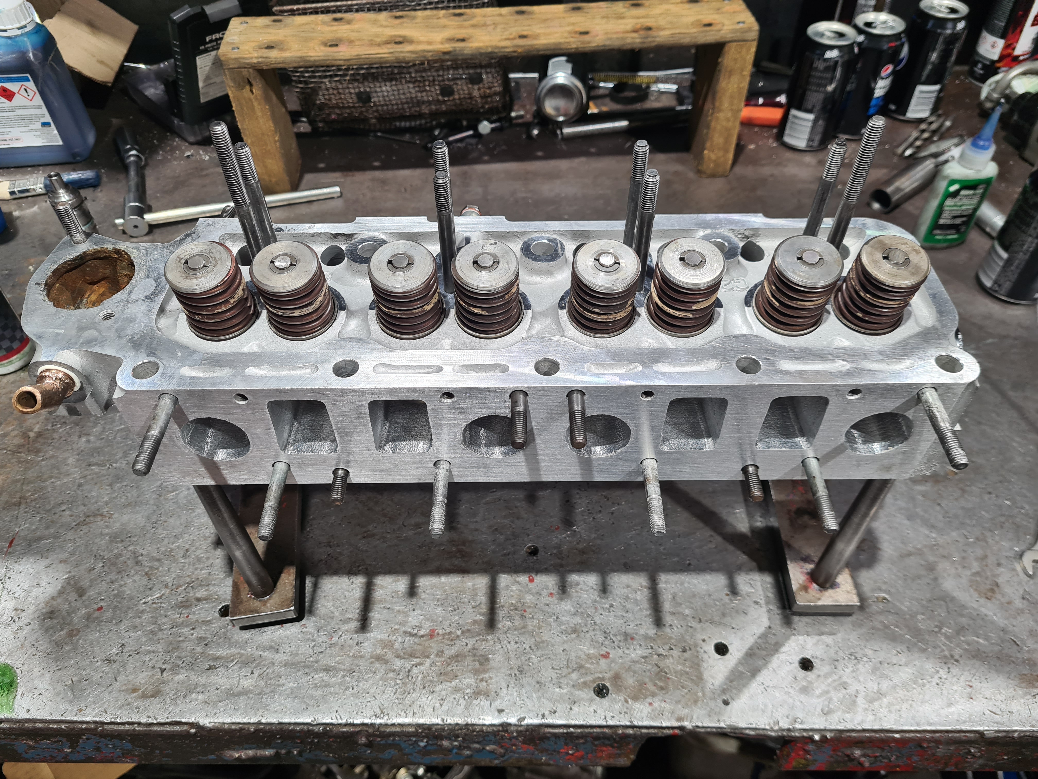

Time to add a little update on the PR90. Engine did not go in for machining as planned however he did manage to fit in the head and that has finally been completed. Chambers have been rated at 45cc and comp ratio has been done to a theoretical 9.5 to 1, we had 35 thou taken off to achieve this figure. Head was pretty sad and needed welding in places and some work. It also got a little bit of pocket porting done. Block goes off for machining and full balance in October. Finally got the differential back and that is now in the vehicle, only took six months to have it overhauled. Gearbox is still out and do not expect to see it until some time in October. Pressure plate has been fully rebuilt and flywheel has been resurfaced as well, car came with a new clutch plate so that pack is also now complete. Trimming has been put back until Oct-Nov due to his workload. Received the new grill badge from the foundary and I am very happy with how that has turned out.Found a new chrome plater and his work is excellent, he has completed some more work for me and at a third of the cost and a quarter of the wait time. All the major electrical items have finally been finished and are sitting waiting to go on the car. The horns have been refurbished with new chrome covers as well as being overhauled in the electrics. Finally finished all the crinkle paint finish on the dash trim, door tops and instrument cluster. The instrument cluster took eight attempts before I was happy with it and in the end have run with what I have even though I think it could be a bit better but had to draw a line.You may have noticed that the car had lost its fog lamps and came with two 100 watt lamps in place of them. Trying to replace the fog lamps has been difficult as they are an unusual size, all of the replacements are 4 inch and I need 4 and 1/2 inch which surprisingly I found one day whilst trolling the internet. I found them in a wall mart store and traced their supplier to Speedway Motors in Lincoln Nebraska so got the pair for $60Au landed. They have replaceable globes so that is a bonus. Things are progressing albeit slowly but should come together with a rush by the end of the year. I have attached some before and after shots of some items and some pictures of other stuff.
Peter

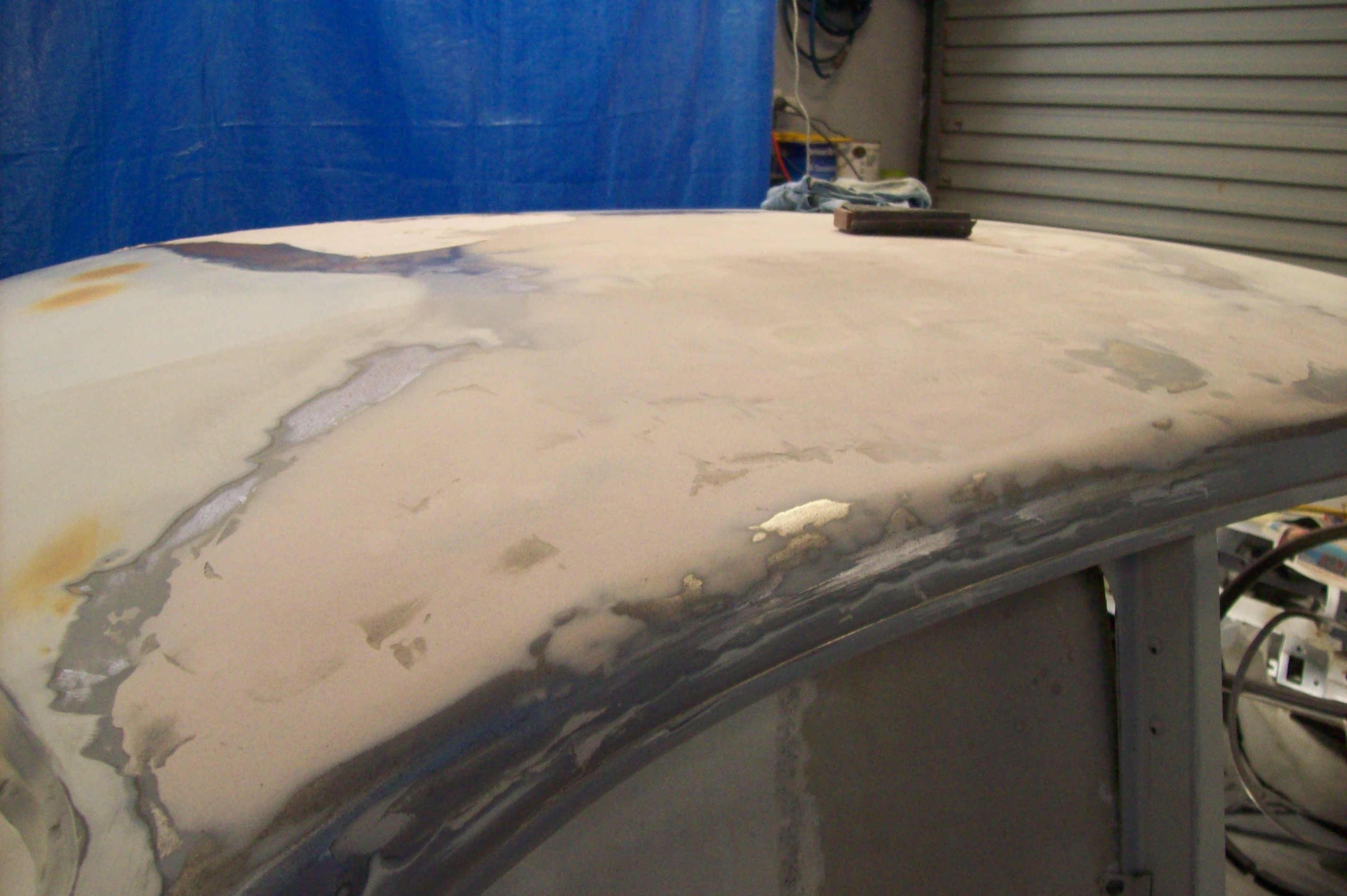

Thanks for the pics Peter. Good to follow a resto.
Your paint work has given me inspiration in what I should do for my resto.
Will make a final decision on the side stripes when the time comes.
Most of my time has been knocking 2 big dents out of the roof.
Has been too cold to paint at the moment.
