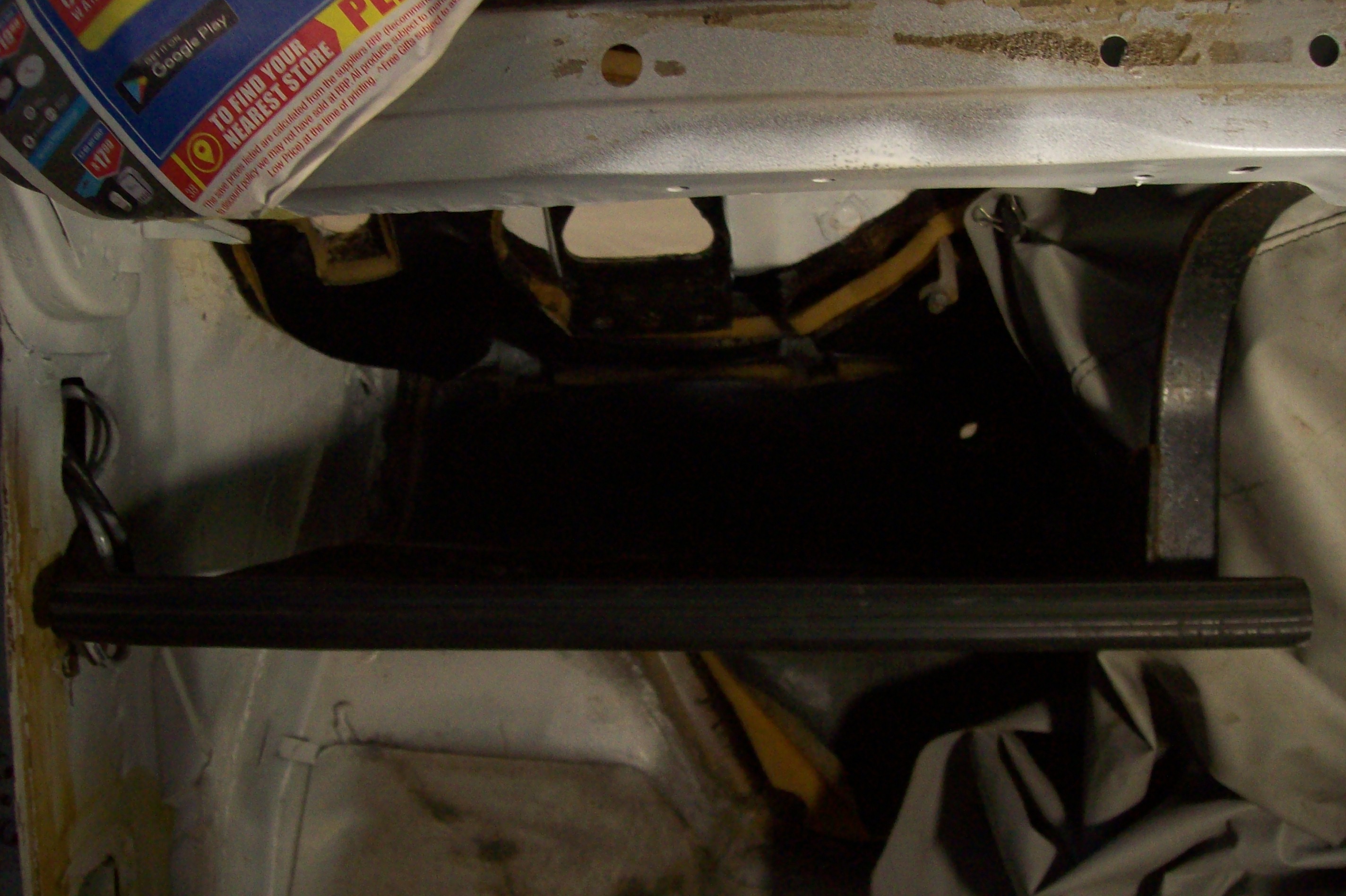

My 72 sport has one. Obviously not Aust delivered though but i thought at least all GT's had them standard.
Mounts: as far as i recall all Belletts have a tapped hole on the A pillar....... one bracket goes in there (pics)
On the right, a curved bracket runs up under the lower dash area.
At the back there are L shaped brackets underneath that screw into the firewall. Possibly those holes are in all cars too, not sure.

Hi Flying.
I've attached a few pics of the Parcel trays out of my GT's.
Hoping those who are not aware of what We are discussing will now know.
Even that I had a sample to copy from I reckon would still be easy to make.
File comment: Under dash location 2.
File comment: Under das location.
File comment: Single tray.
File comment: Both Trays.
