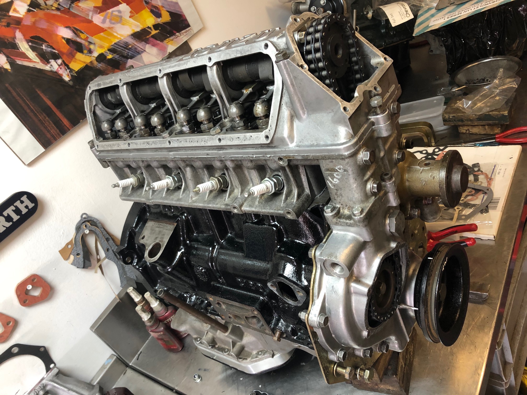

Well, the 1600 head has gone onto the 1800 block..and our Frankenstein engine is taking shape. The theory behind this strange hybrid, is that the smaller combustion chamber of the 1600 will give us more of our much sought after compression. Top is 1600 above the 1800.
We calculate we'll get somewhere around 10.5 - 10.6 : 1
There was a bit of fiddling around with one of the oilways,but otherwise it's on
The weird looking overhang under the plugs is the wider part of the 1600 head that covered over the blanked off pushrod galleries in the 1600 block.
Not pretty, but this isn't a beauty pageant is it?
