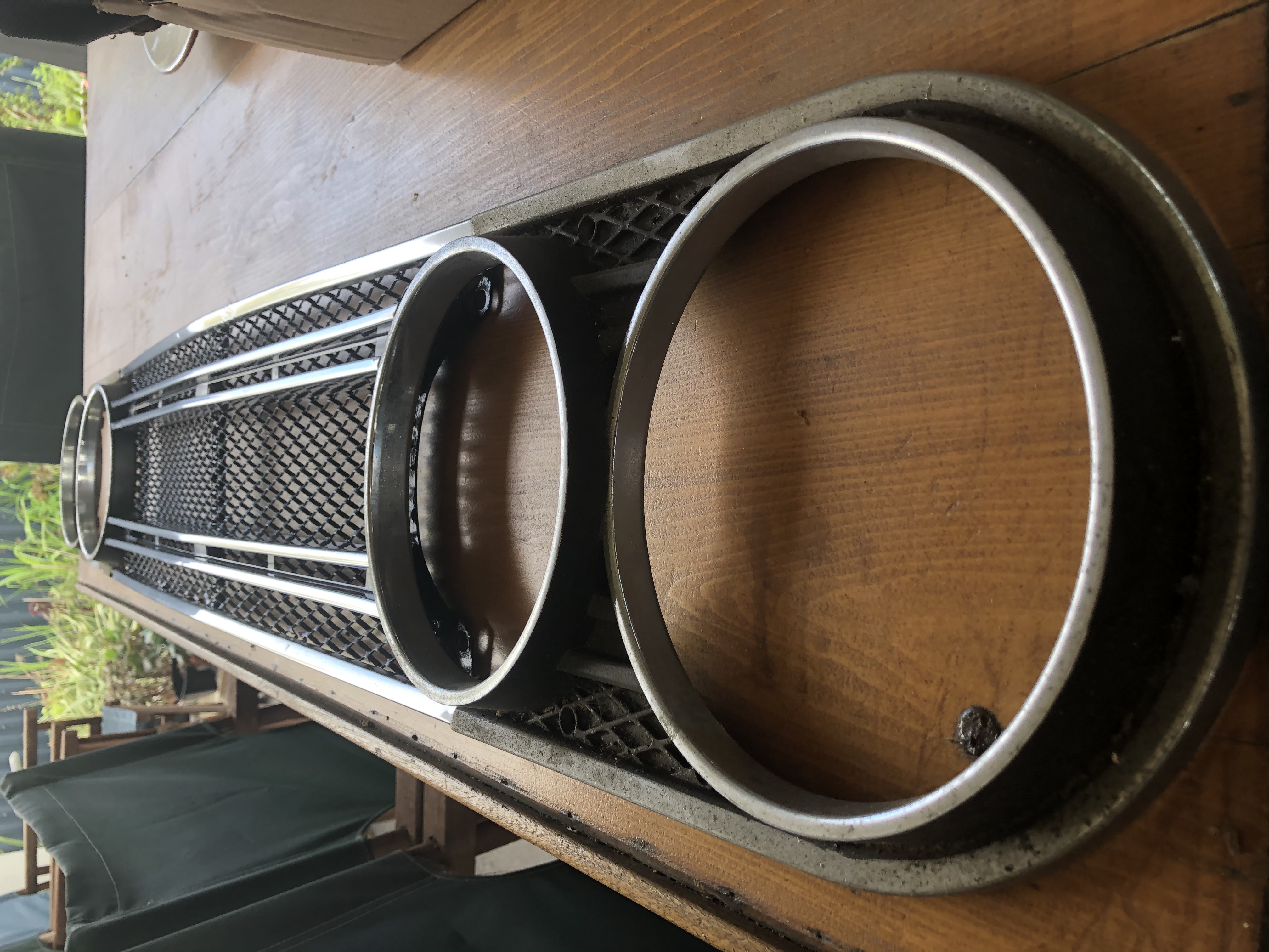

I started this so long ago... back when I was single living st home... no mortgage, bills... just me... 20 yrs later... I just want to get it back on the road... if I had the time again I wouldn’t have started it... but you do things when your young and enjoy it meet people doing the same thing... at the moment in the shed it looks like one of those barn find pictures.. covered in dust and cobwebs.. maybe one day it will get going but for now... the little things and moments I get it feels good to work on it. I think it’s taken me 3 yrs just to get the exhaust sort of almost there... I went to put the grill in.... sort of trying to make it look more complete... and bugger.... all those yrs ago... I remember throwing away the original light mount backing after I found some other ones thinking they were the same... now I am stuck... can I get some original ones.. or maybe I’ll have to see if I can make some sort of bracket to adapt it... all the challenges of life... agh just something else to think about...

I moved house 3 years ago and threw out heaps of light brackets collected over the years. Not much help for you but I did keep a couple 'just in case'. I will have look to see if have what you need, asap. I have though in the past modified them to fit other grille types by welding on small brackets in the grille hole locations.

Have to say a huge Thanks to Matt... he sent me 2 one was perfect... better than perfect. The other I have to fabricate the grill mounts, but I am on my way...
If you do know of anyone that has one? It will probably take me a long time to make the brackets..
Thanks again Matt..

I'm glad to help, but sorry that I didn't have a pair. I haven't ever owned a '69, so it came in a box of bits. For the readers,the difference is that diagonal pair of brackets for the grille ends is not on the '66 1/2 to '68 mounts. I would (probably should have) just bend a strip of metal, pop rivet it on and drill a small hole to take a self tapper.
