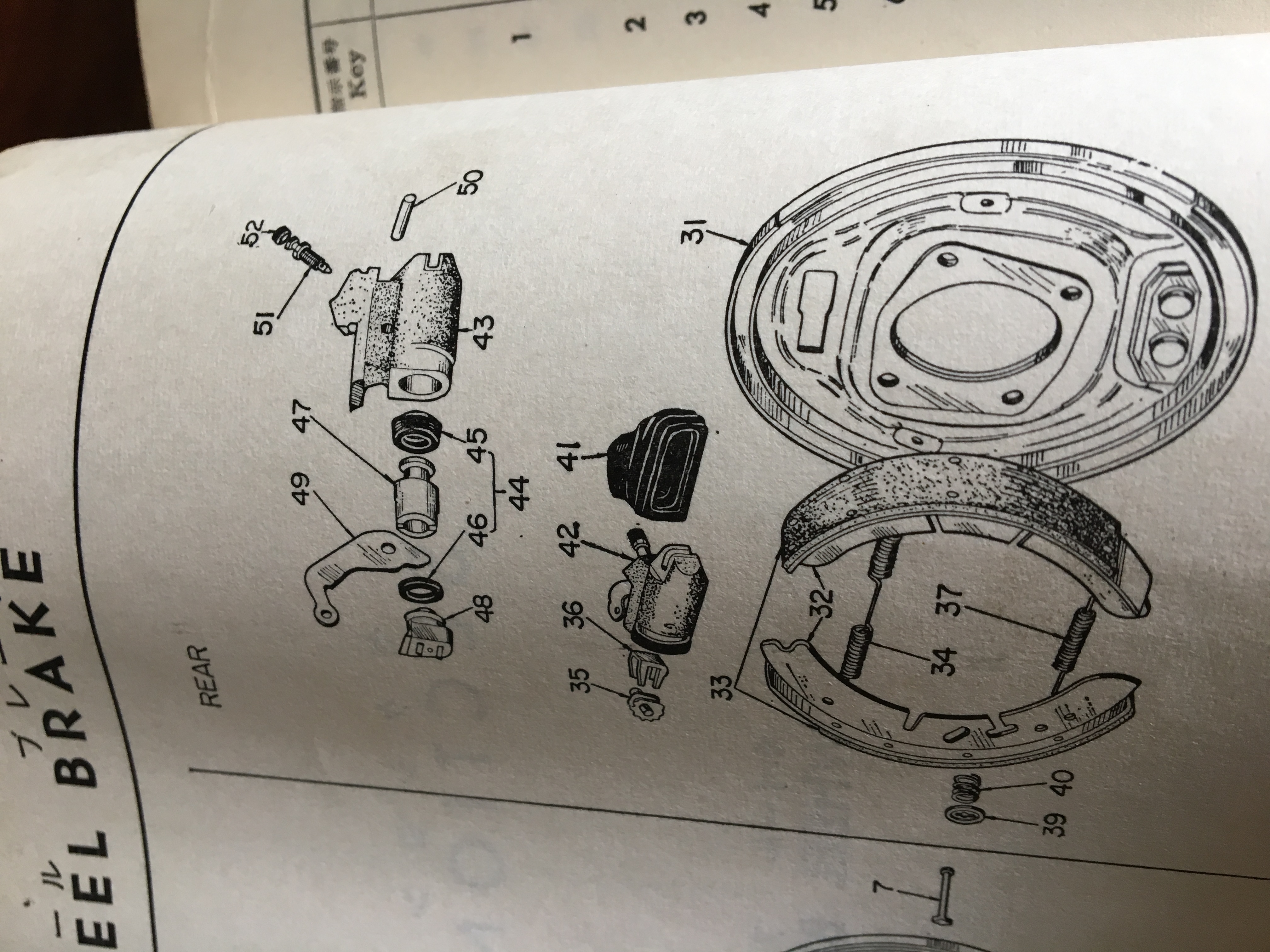

The brakes
Thu Dec 14, 2017 9:34 pm
Rear

Yes, thanks, I already had that chart. At first, I thought the rear brake piston wouldn't come out at all, but on the chart I saw that it should. I thing air compressor should help to get it out.
Main question is, would the front rubber ring (how is it called?) fit on the rear piston? Are the diameters same?
I guess I'll see on sunday if it works or not.
