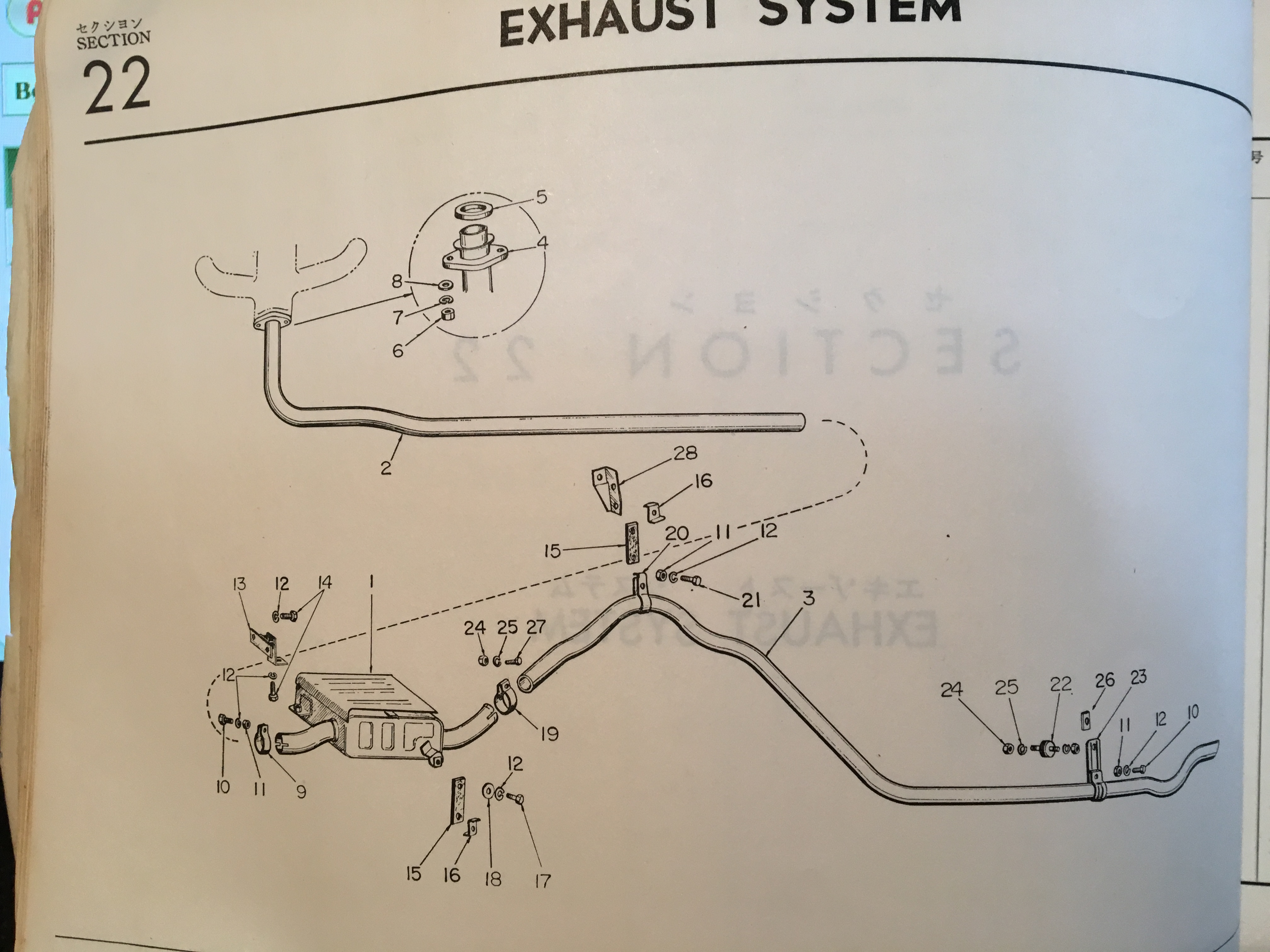

Some questions have also turned out: Does anyone have a good picture of the bottom. My Bellett has no muffler, not even remains. So I would like to know how does the original look like, so I could build a new one from aftermarket parts.
Another one: Wher is the filling hole of the gearbox?
So far so good, the bottom looks OK, especially for a half-century-old Japanese car. There is some damage on the left front fender, but I'll deal with it later. At the moment the main goal is to get it running ASAP, latest in the beginning of february. Some rust protection and maintenance would do the thing I hope.

A picture of my sedan exhaust is here but note it has the rear GT twin pipes (standard on a Sport model) . http://bellett.net/forums/viewtopic.php?f=13&t=2084&start=140 This is the original central muffler on this car by the way. The central muffler on a Bellett is a bit unusual in that it fits up under the rear seat area. Very difficult to find an off the shelf muffler to fit up so high and allow the pipes room to fit, so most i think use a short standard muffler hanging a little lower.
The 'filler' hole on the gear box is on the side. Its the same plug you remove to check for the level. You should fill to the bottom edge of that hole.

Here is the original with the old style muffler which can be. Replaced with something easier cheers dave

Thanks for the chart, but a photo would be much better. Does anyone have?

I figured it out myself, that the gearbox filling hole should be on the side, but how to fill it? There seem to be no room on the sides of the GB.

Firstly, I'm very impressed with the new model 1 post hoist made in Estonia these days. Nice work.
I have taken some photos that may help. I have been told the muffler might not be original as mine
is round & the book shows it as being squared on the edges. Hope these Help

Thanks for the pics, now I have much better overview of the pipes. There is just a plain pipe from front to the under-back-seat pot? No resonator in the middle?
