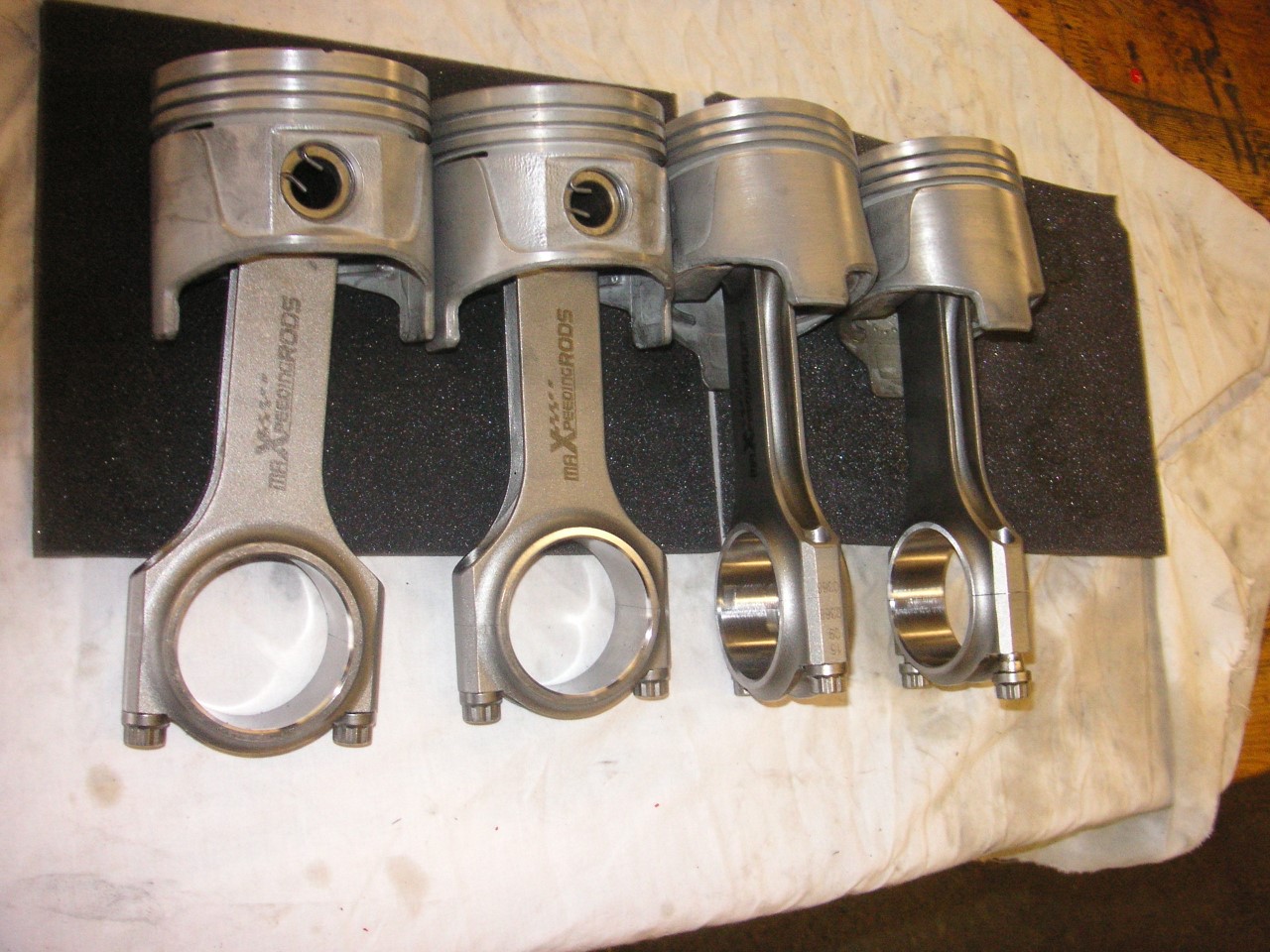

Damn right Sticky, although if you think the paint looks quick....check out these rods.
They've even got "maXpeeding" embossed on them!

Those beauties look as though they would empty your wallet at least 2 seconds a lap quicker :P
There are only termites that have starved to death in my wallet :roll: :lol:

Hope they are 'fast' as they sure look expensive ..........
