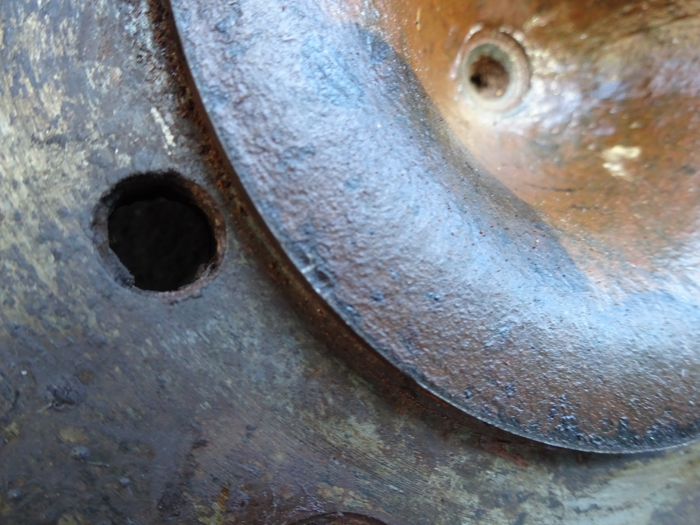

After 3 1/2 hours of trying over 2 afternoons the rear LH drum still wouldn't budge, not even half a mm
Tried tapity tap tapping, soaking in WD40, heating with the bottle torch, tapping while prying with a screw driver, soaking with a white vinegar/WD40 mix, more heat and even some naughty words were tried but all to no evail :evil:
Time to improvise......
I made some custom arms for a gear puller that I've had sitting in my kit for years (used once for a 2min job) so that it would fit over the drum.
I had to bend the dust cover to get the jaws in (which I will straighten it up again after the brakes are sorted properly) then started winding in the pressure bolt.
It loaded up with a fair bit of pressure when I though....... better put the wheel nuts back on just incase this thing lets fly and takes my hand with it :|
I kept winding and winding, putting a hell of a lot of pressure on it and thinking, any moment know, when BOOM!!
Very happy to say I still have all my fingers, albeit with a couple of bruise knuckles and the drum was stopped by the wheel nuts (glad I had that thought cross my mind) but the puller and spanner landed six feet away in the yard.
Good news is....... the drum is finally off :D

Well Dave, why and what I don't really know. Whether the hub hole was a few thou to small and locked itself on or whether it was snagged by the tiny bit of damage on the drum hub and hole (4th pic) I can't say for sure but it was stuck on there well and truely.
Yeah really glad I put the nuts on but the puller and spanner just clipped my knuckles as it departed company with the drum. No skin lost, just a couple of slight bruises and change of underwear :? :lol:

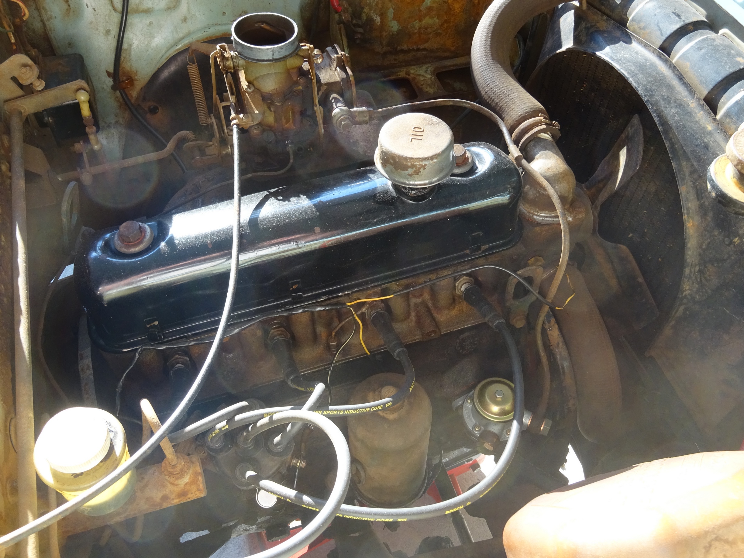

Another thing that has caused me some concern right from purchase is how rough it was running.
I had initially put it down to bad fuel and dodgy spark so I have changed fuel pump, leads, plugs, points and condenser.
It ran better but still no guts and miss firing still. I've since pulled the fuel tank and the pick up was blocked by a bazillion grass seeds and rust flakes. Another possible cause along with the stale fuel.
However when taking these photos today something caught my eye in the engine bay that may just explain another reason why........
Can anyone else see something that might not be quite right?? (3rd pic)
I'll test my theory on the weekend when I put the fuel tank back in (silver soldering some pin holes in it atm) and see if I'm right (+ anyone else with a keen eye for trouble shooting detail)
Anywho, here are some photos taken today (especially for you Dave)

Thu Sep 14, 2017 7:35 am
Thanks for the pics. Centre of drum to axle face would have been the problem. Very little tolerance in that area.
Had a sedan rear with same problem. Not only damaged the backing plate. Had to use a large drift to get the drum to move. Hence a few small chips to the outer of the drum. :|
Hook that harness up onto the clips. Yellow/white wire to oil switch. Yellow/black to thermo. switch. Black/red to
dissy. It has been known to have the two yellow wires hooked up to the wrong switch. :o

Close but no cigar.
They are wired up in their proper places already
Fri Sep 15, 2017 4:08 am
Sorry mate. Thought you may have a bit of a pulse transfer to the harness. 8-)
Your firing order is correct. 1-3-4-2. Can't see anything. :|
Maybe someone else will see the problem.
Fri Sep 15, 2017 5:25 am
I know Sticky, YOU GOT NO BATTERY IT!!! :lol: :lol: :lol: :lol: :lol: :lol: :lol: :lol: :lol: :lol: That tells ya lot about my knowledge EH??
Is it to do with the plug lead up against the brake pipe from the brake master cylinder!! OR is the vacuum pipe disconnected??

I will try to give it a start up in the morning after making a slight change and see whether my inkling is correct or not.......
CQGT Dave is kinda on the money but hasn't backed the winner yet ;)
Fri Sep 15, 2017 8:26 am
Posts: 368
I was thinking of the distributor vacuum pipe into the side of the carby, trouble is, I forget most of what I learnt about Belletts when I was youn-ger!
Ted
Ted Freeman
Fri Sep 15, 2017 11:36 am
Hey there mate.
That dizzy seems to be a fair way around to advanced, like a quarter turn. I reckon I'd try byinging it back anti clockwise to the next cam on the shaft, then jump the leads one each clockwise so 1 is still at 1. Maybe. That dizzy just doesn't look right.
:) Matt.
Fri Sep 15, 2017 12:51 pm
Um, just checked Doris. It is too far around, but maybe the dizzy shaft drive cog has been installed a quarter turn out?
Hmm....
Fri Sep 15, 2017 1:06 pm
Hey Sticky,
It's got to be an electrical issue if it's running, but rough or missing. The 12 volt wire to the dizzy looks partly exposed and maybe shorting to earth outside the dizzy..make sure the little plastic insulator block where that 12v goes through the dizzy wall is not cracked, I would find another one and put it in to see if it helps.
As matty said the orientation of the dizzy looks a quarter turn clockwise to where it should be. But I guess it may not run at all if you moved it that much.
Also check the shaft wear in the dizzy. A badly worn shaft can play havoc with points clearance,,,just like a big night at the brothel causing shaft wear may lead to lack of clearance from the missus on future night outs. :lol:
Fri Sep 15, 2017 7:14 pm
And the winner is Farmer Matty :P
I do recall Mark (the previous owners son) saying that the engine had a freshen up in the late 90's, inc a new water pump, rings and whatever. It then had the points, dizzy cap and rotor button replaced in the early 2000's but apparently always ran rough from that time on.
Perhaps the leads were just put back on one position advanced back then and problem was never corrected??
Come to think of it, When I put new points in last week the neg wire that attaches to the base plate was not screwed on properly either so that would have been an issue for a consistent spark too.
Well time to go out and test the theory....... just need to find a bit of fuel line to run from a jerry can as I haven't put the fuel tank back in yet.
:lol: You're a crack up Lewis (Does Donna know what you get upto on a big night out??
BTW but my brake parts arrived yesterday so I have another job for tomorrow too. It's getting close now :P
