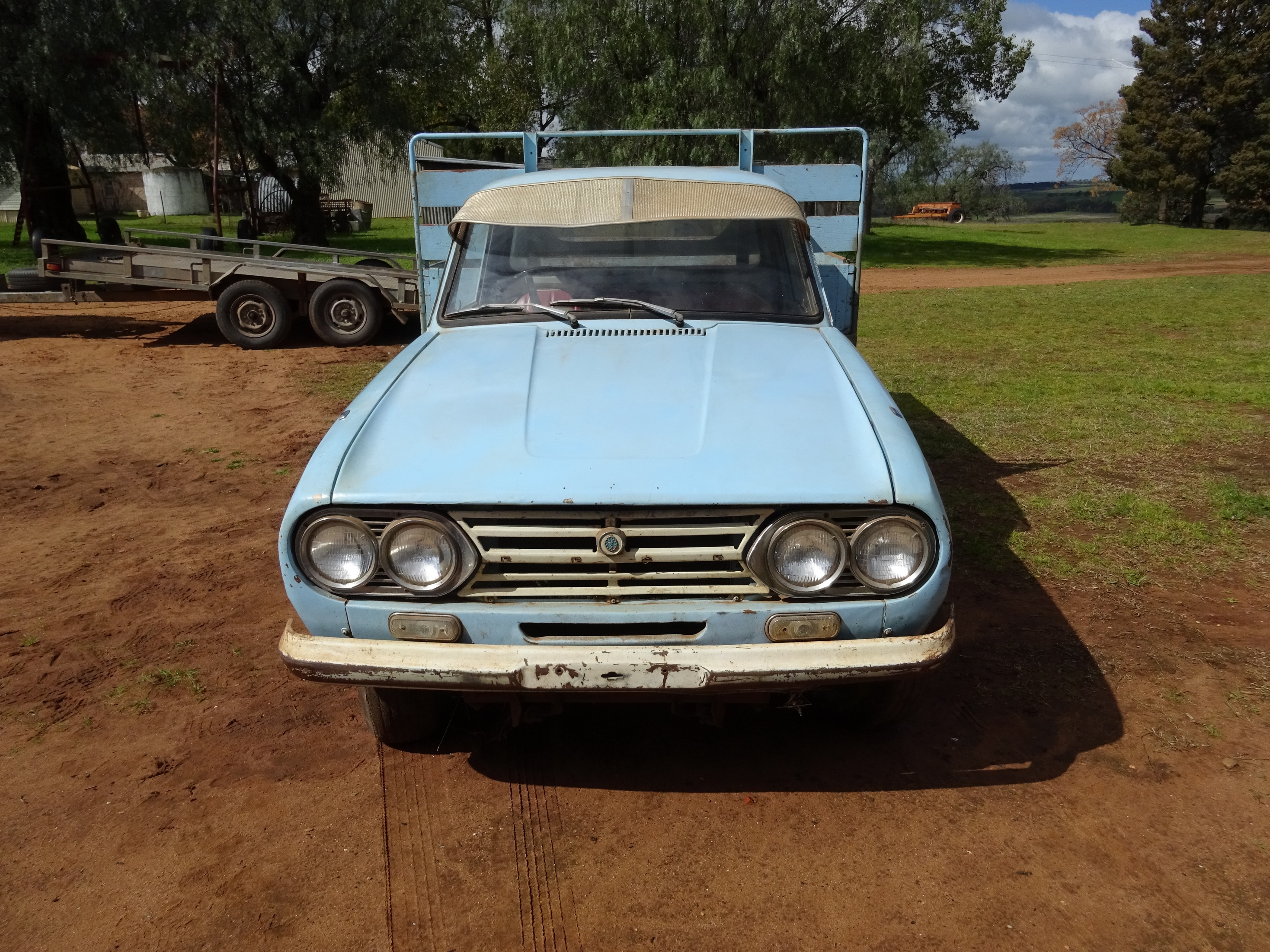

Some pics from the day I picked it up and the road trip home..... back roads style :mrgreen:

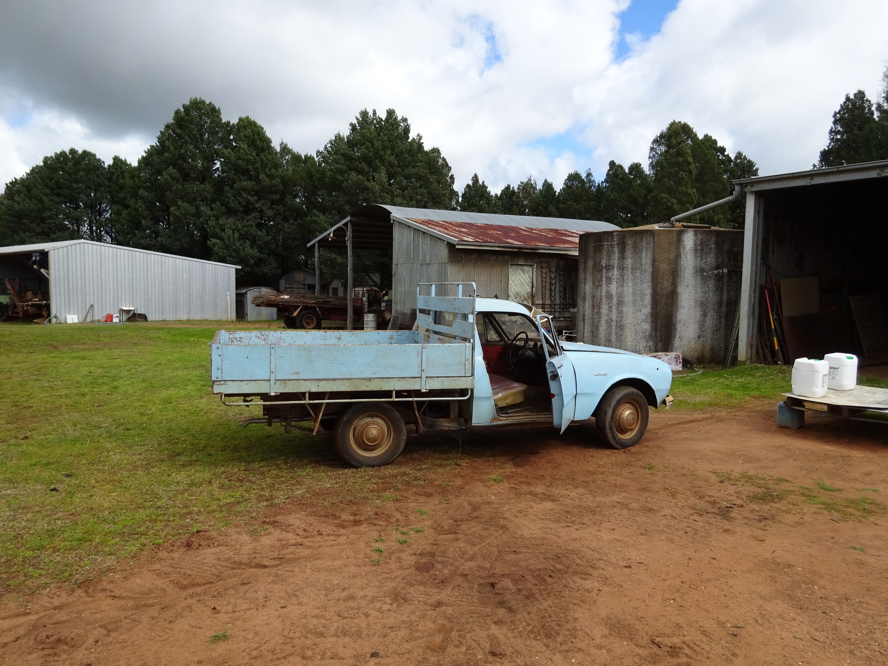

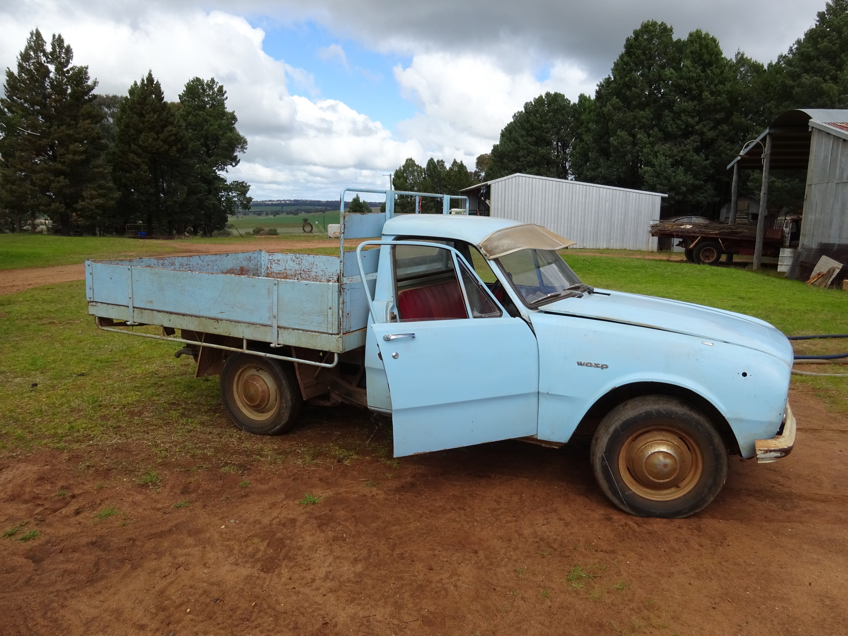

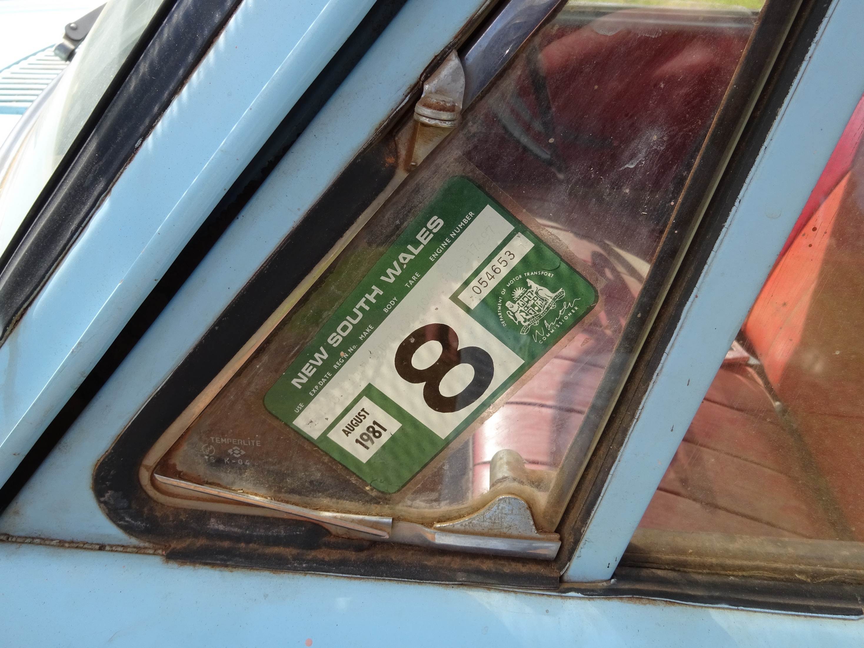

Last time it was rego'd was 1981 and the sticker is still on the quarter window :P
Loaded up and ready for the journey north to live with Donkey

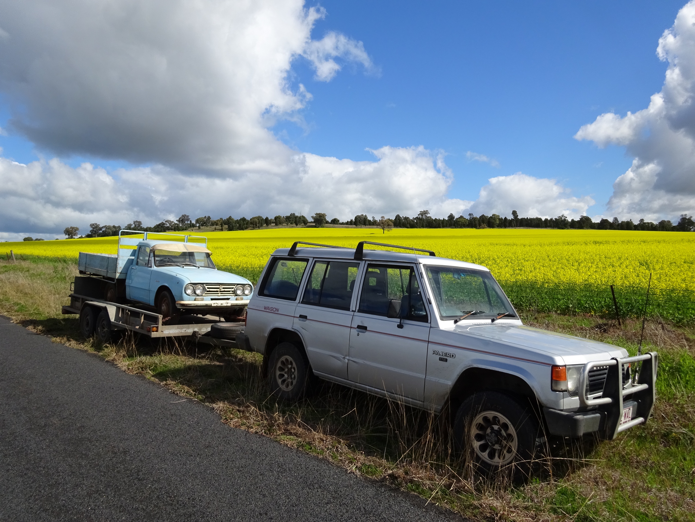

Sat Mar 04, 2017 9:45 am
As I left I couldn't stop looking in the mirror and smiling like a Cheshire cat.

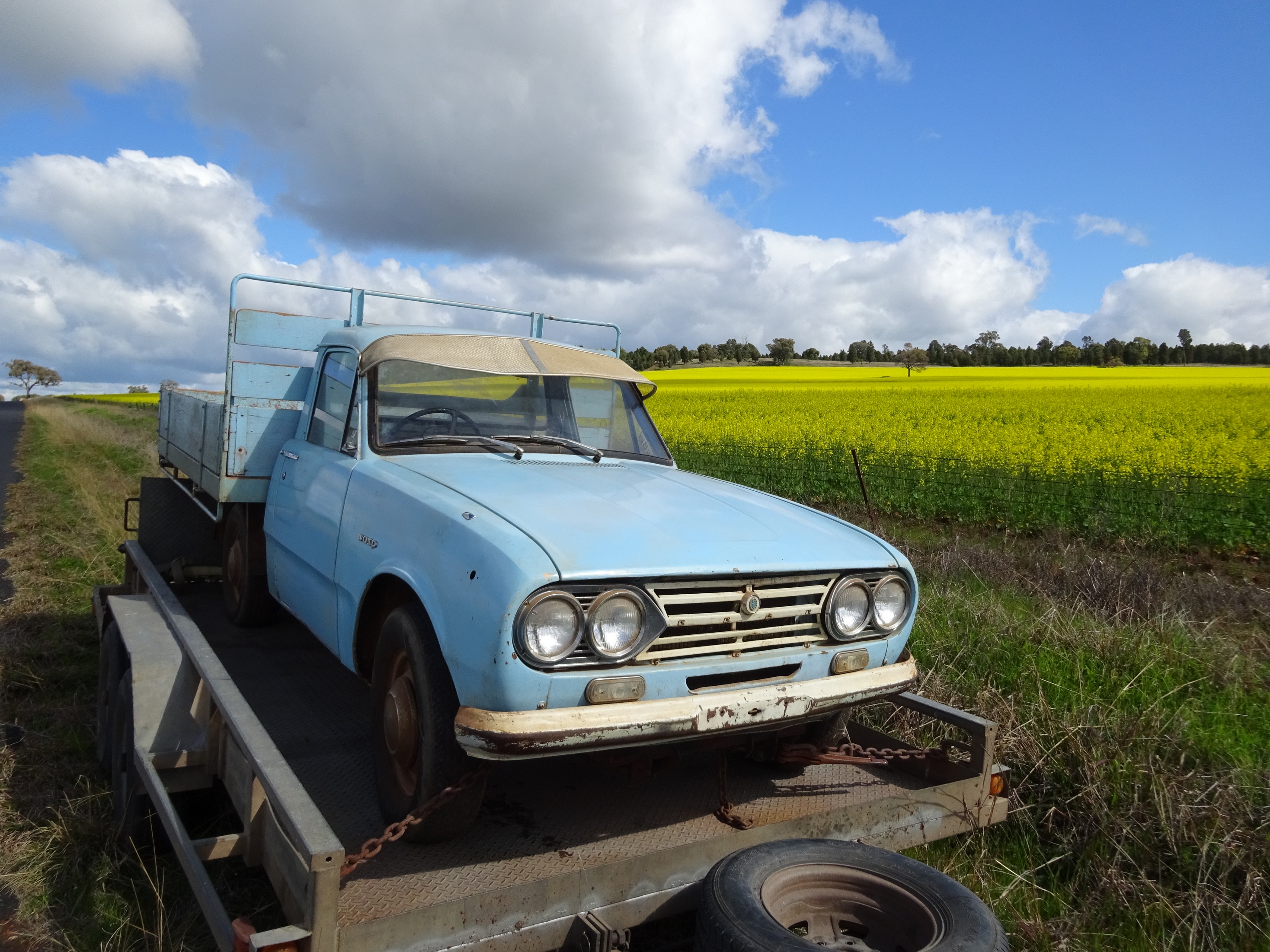

I drove for about 10 miles before I had to stop and take some more pics of my new baby..... best 5k I've ever spent :D

He has his guard blinkers, tail lights and front bashpan panel inside the cab plus a few other non essencials ;)
The only things he is missing is a piece of trim on centre of grill, 1 hubcap (has 1 painted and 2 "use to be" chrome ones) and the top metal trim on the drivers door (I have plenty of those) + one badge is broken in half.
Other wise it's complete
I haven't even cleaned it yet as I want it's first showing to be as close to farm fresh as possible.
Mudgee is definitely on the cards for this little ute.
I put on new leads last week - new upper n lower ball joints and inner n outer tie rod ends get here Friday then I'll lift engine to replace sump gasket and throwout bearing and head gasket too.
I won't be pulling the old tyres of the orig rims though. I bought a set of rims last week (similar to Shrek's) that will get the driving duties instead

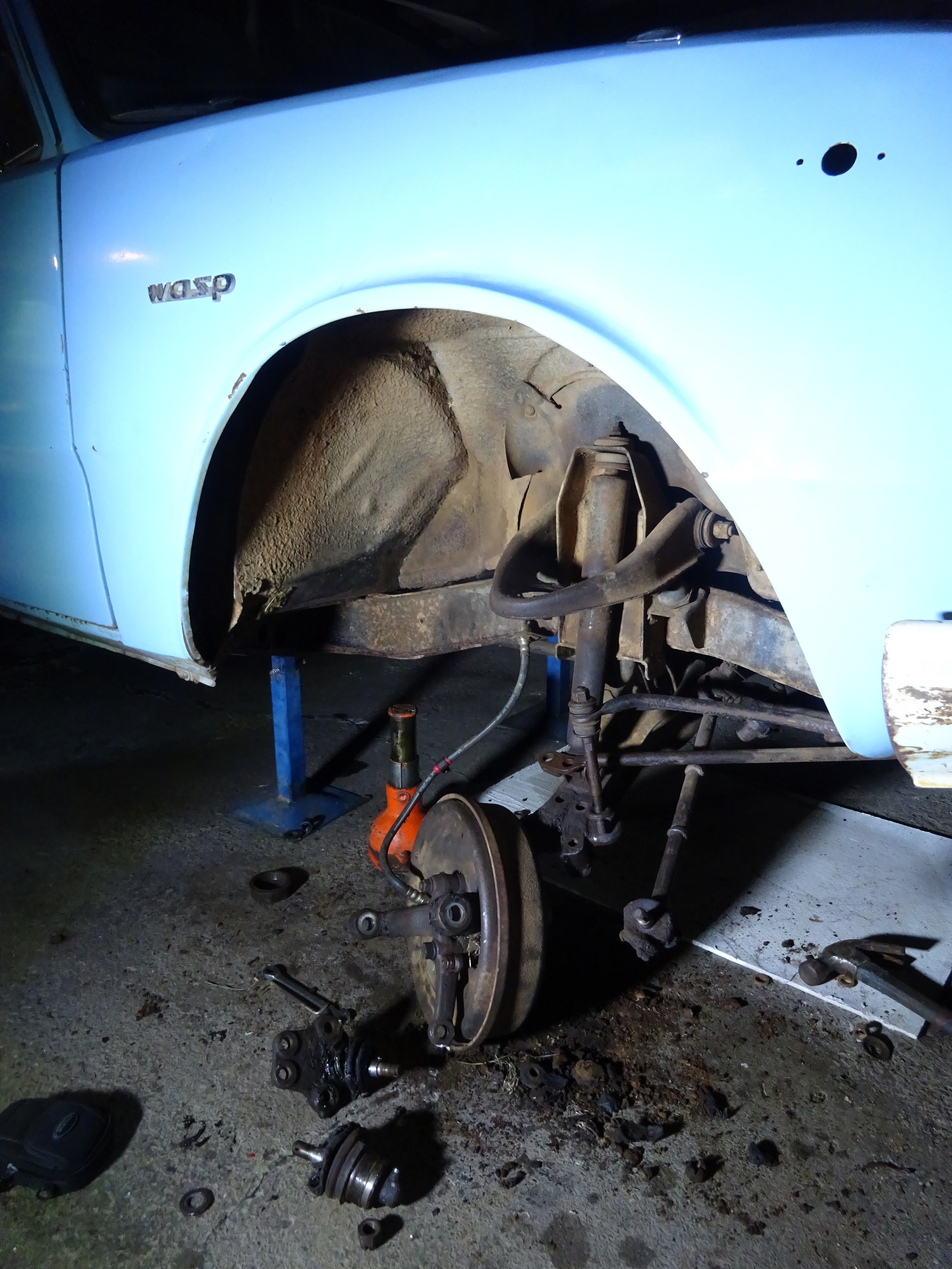

Today I started the process of changing the Dubbo Wasp's upper and lower ball joints.......
Jeez Louise!! 52 years of hard farm labor sure does make life difficult, 3 hours later and first lower ball joint still isn't out :| First bolt was a bit of an effort but second bolt came out sweet as a nut, last two are locked tight. Packed in with a lifetime of dust, rust, grease and stubborn hard yakka attitude :oops:
Plan B: I got one of them loose with a bit of help of a bottle torch and a can of WD40 but it still hasn't pulled completely out yet.....
The last one may require Plan C - A couple of beers and a few Bacardi and cokes to loosen ME up a bit before I go hostile on it's ass :x
......and that's just the first one :|
It seems that every component in the front end is original and flogged out, except the brake line on drivers side which has been replaced at some stage.

I took 4 1/2hrs to get the drivers side lower ball joint out :shock:
Never in my life have I had one that tenacious.
Two of the bolts were we and truly rusted in tight but persistence, a bottle torch, pinch bar, hammer and a few beers eventually paid off.
Does anyone know if bolts like these are still available off the shelf somewhere??
If not I'll get a mate to machine me some up

Progress on changing the ball joints has been painfully slow.
I couldn't do anything in last weeks deluge as I had a few inches of water through the garage.
This however pales in comparison and seems quite pathetic when compared to the Glen and Elaine Potter who had 14 foot of water through there place at Murwillumbah :shock:
I did finally get all the ball joints out but finding replacement bolts has been proving difficult.
A mate of mine will be machining me up some new ones but it will be a few weeks before he can slot it in so things have ground to a halt again :|
The lack of lighting under the house makes it frustrating too as I have to work with lead lights even in the middle of the day.
These couple of pics were taken at about 2pm on an overcast day but sunny days aren't much better

Fri Apr 07, 2017 9:57 pm
where did you get new ball joints from, just curious
Fri Apr 07, 2017 10:52 pm
Same as early KB20/Chev Luv, so easy as to get and cheap as chips :)
Sat Apr 08, 2017 3:48 am
For those who are contemplating in changing theirs.
Part numbers. Top. BJ201. Bottom. BJ202.
They are available on ebay. The freight is the killer on some of them. Check your local auto supplier.
Sat Apr 08, 2017 11:32 am
I got mine as 4pce kit (2top and 2bottom) on Ebay with free postage for about $120
