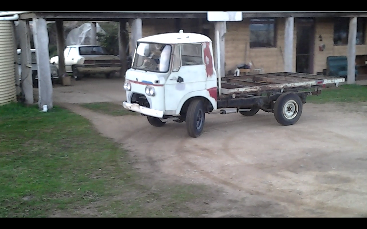

So today Dobby came out of the shed under his own power. :D
Heres an action shot!
Sorry theres no vid, for that you need instagram! (@ryeparkbellettbloke)
I was pretty excited.
He has a surprising turning circle, a bit tighter than a Bellett and way tighter than a Florian. Somehow he turns more tightly to the right, might be a wheel alignment needed.
So, the clutch works, all the gears select, even reverse, and the brakes are surprisingly effective, considering theres no booster.
