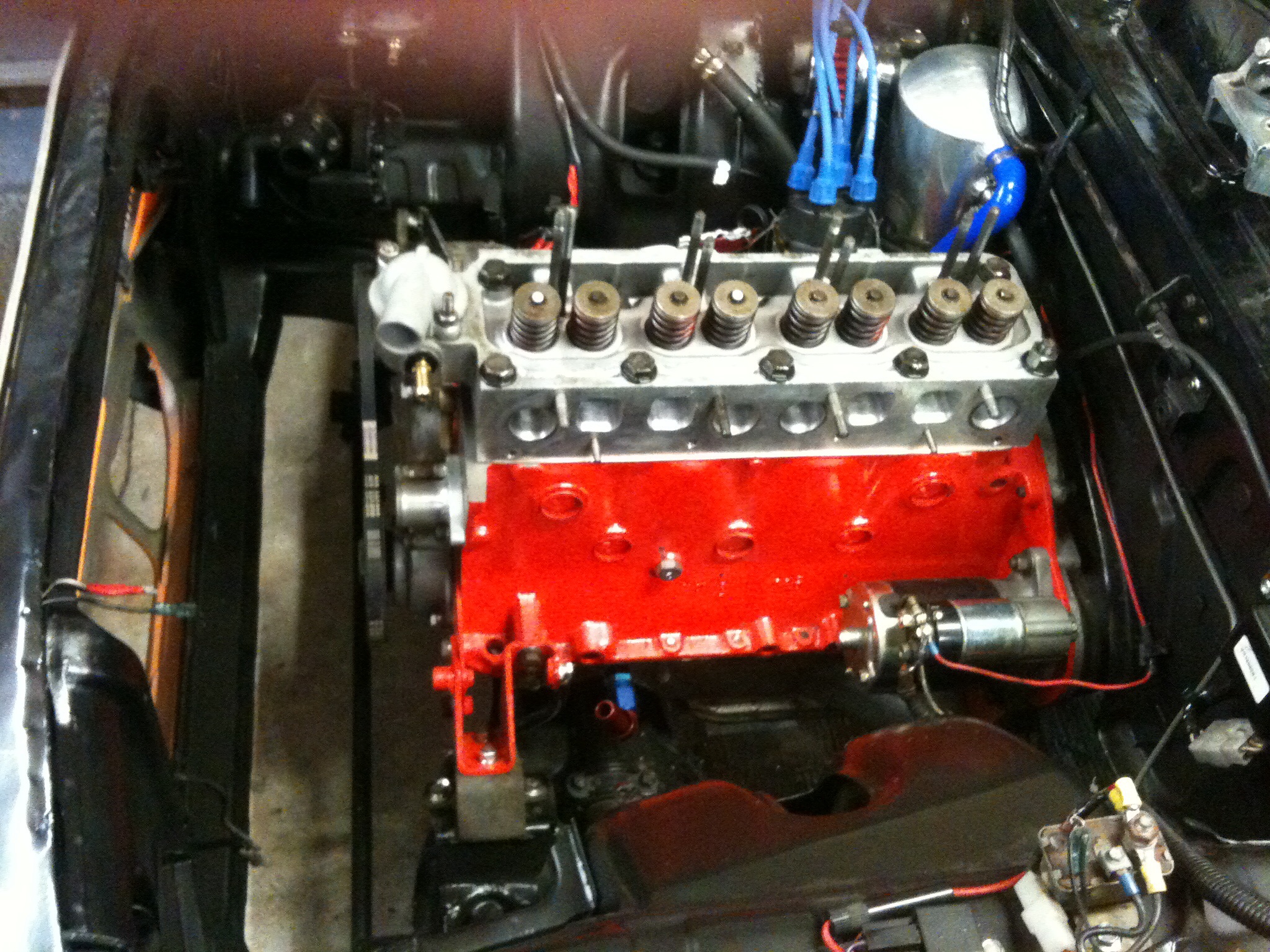

Here is one I prepared earlier
8mm aluminium adaptor plate with 35mm water hose fitting replacing mechanical water pump
In top of picture, driver's side engine bay is Davies Craig electric water pump
I ran an inline water temp switch in the upper radiator hose.
13 inch electric fan (take note the fan suck a lot of amps)
J

Sat Nov 28, 2015 11:15 pm
Posts: 428
Location: Sydney NSW
Three words
Custom, custom & custom
You don't need to run a bigger generator/alternator
Just a dedicated circuit with relay much like with spot lights
Trick to be aware of, there is a 10mm hole from the front of the block...
Do not blank this off as will lead to a vapour lock / hot spot and then gasket problems ie blown head gasket
If you look closely at the origional pump backing plate you can see it.
This needs to be plumbed in somehow when you change to electric pump
I tapped the hole and
Mocked-up a banjo bolt, however I settled on a AN fitting for quick release
J
