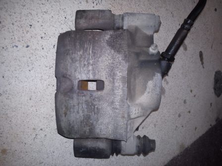

Here are the 2 types. One for sure is TP Magna as I removed this from a car. What is the other one from? Maybe a different Magna model?
1st picture is 'my' TP Magna caliper, made by PBR.
What is the other one from ? Perhaps calipers changed as time in the TP model life?
This is why you need "exact" details of "everything" for any proposed mods. or substitutions !

File comment: what caliper is this from???
Sat May 05, 2012 11:55 pm
second calliper almost looks like a commodore rear calliper? (vn, vp, vr, vs?) just a thought?
after looking them up on the net they look similar but they are different to what you have shown there.
