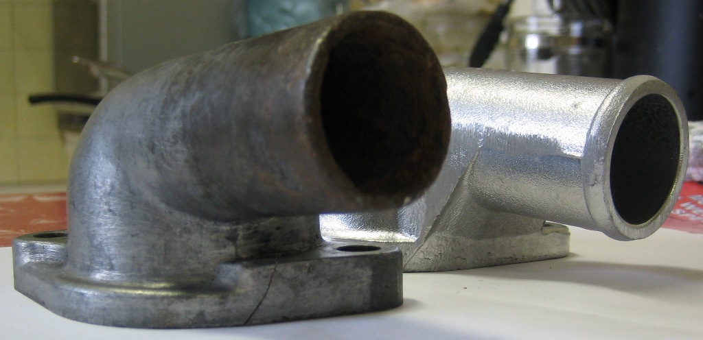

OK, here's the follow up for the thermostat housing. As you can see from the first photo they are not a 100% match but the bolt pattern is identical and the angle of the outlet is right.

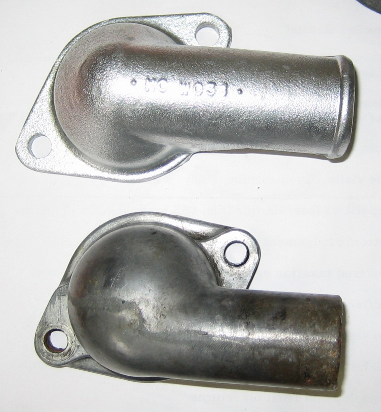

The next pic shows that the oulet's angle is again slightly wrong but in this case beggars really can't be choosers!

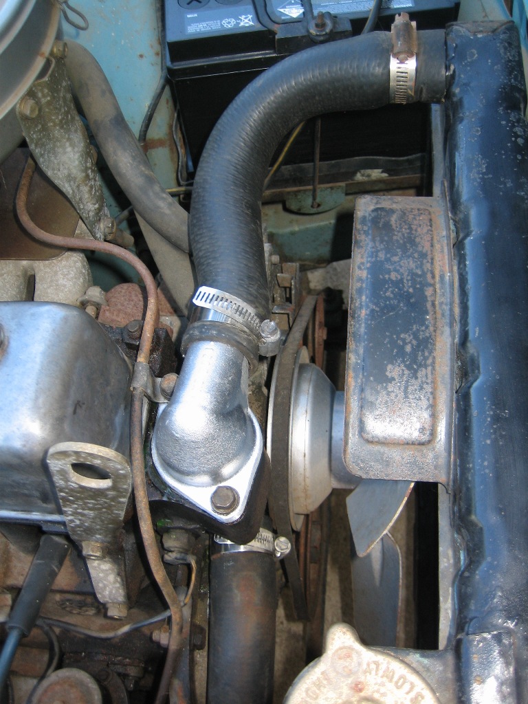

And lastly, the finished product. I had to use two gaskets when I put this back together but this was mainly because I was worried about breaking a second one plus the block wasn't particularly flat!
As you can see the outlet pipe is noticeably bending the top pipe but I don't think this will effect anything

Looks like it'll do the job. You could probably cut about 2cm off the radiator end of the pipe and get it fitting straighter, though.
