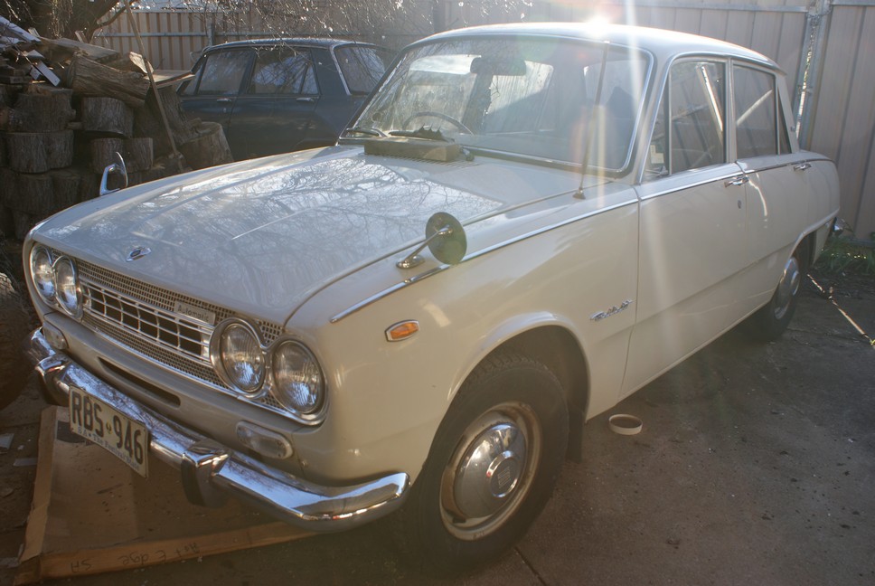

ok just a little tease
Tue Aug 09, 2011 1:20 pm
score 8-) and in good hands well done.
Tue Aug 09, 2011 3:39 pm
great stuff gone to the right home ..and the grin ..mate its equally as big as bemboka gary .. nice little car cheers davo

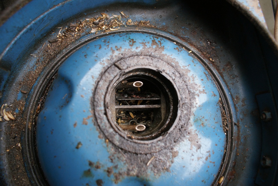

the journey starts...

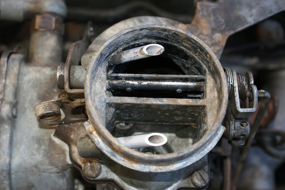

why oh why oh why do people leave the air cleaner cover off and the bonnet open?
ok i know it was in a shed but sharing with all the birds
never seen a carbie so full of crap
just makes you want to cry
Wed Aug 10, 2011 10:30 am
bugger! that sucks!
Wed Aug 10, 2011 10:40 am
to be more accurate, it didnt at all!!
after it was removed, blown out with air, sprayed out with good quality de-greaser and washed with the jet nozzle of hose and given a good drying it looked a lot better.
didnt even know if the engine would turn over, so the bores got a good spray WD-40 and couple of squirts of engine oil down each plug hole, left to soak for 30 min and she turned over with a spanner on the crank really well
so in went the new plugs, coil got re connected the correct way around, engine oil looks real clean and i even connected up a charged up battery and gave it a burst or 2. needs some fresh petrol and replacing of the non genuine starter solenoid with a Isuzu one.
needs quite a bit of work in the engine bay and some rust treatment to stop some surface rust around the battery casing but no real bad rusting of the tower or inner guard.
more as it comes

Good onya, Oz! Under 2 grand? Baaaaarrgain! ;)
I'm glad you were able to get it, and at Mrs Oz's suggestion, maaaaate!
48,000 m's is probable with that condition - pretty nice.
I reckon if there's enough compression to push your thumb out of the plug holes, it'll run. Might be a bit smokey till it burns the oil out. Make sure the separator & hoses are clear & clean or it can make a motor seem a lot worse. (Aunty Mary's were chocka with crud, even the fittings on the block were blocked tight. Opening them up let her breathe, so there was a lot less sump pressure at the oilcap.)
Look forward to reading more,
Cheers, Matt. :D

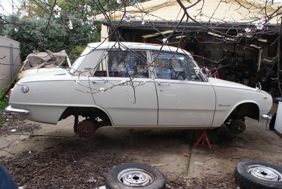

the adventure continues...
the carbi looks a lot better??

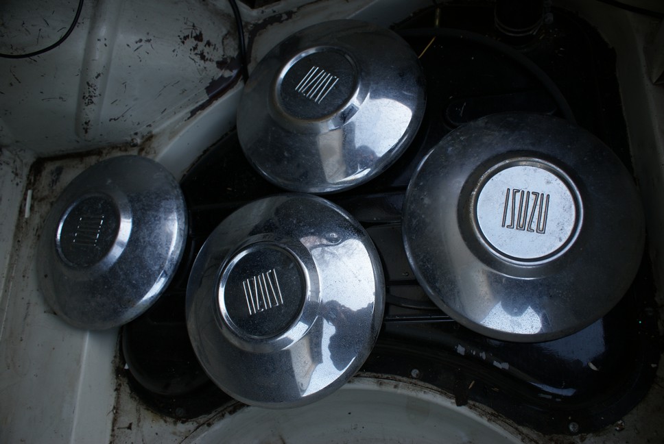

and these wheels trims are just super. wait till i polish them

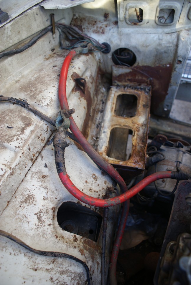

rust in the battery area not really too bad at all
and the sun sets on another busy day down at the shed

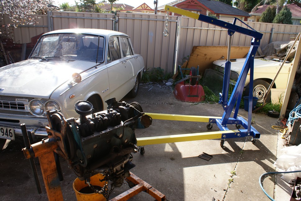

the journey continues...

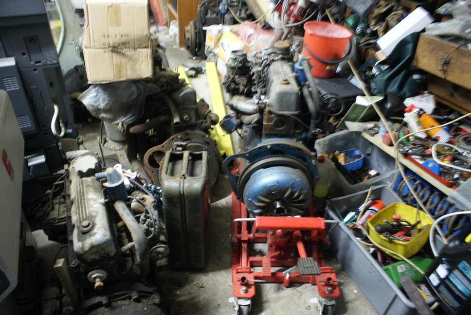

bought a new Engine Crane and Load Leveler to assist the engine repair
nice bit of kit. just one problem. the extended base legs don't fit under a Bellett front end!! i reckon they would not fit under most Japanese 4 cylinder cars so one front wheel has to be removed and the car jacked on that side.
long story short the engine is out and will very soon have the crank removed and away for repair.
sure hope there is not too much damage down there?
also found a bit more rust then i first thought but that's all part of the fun

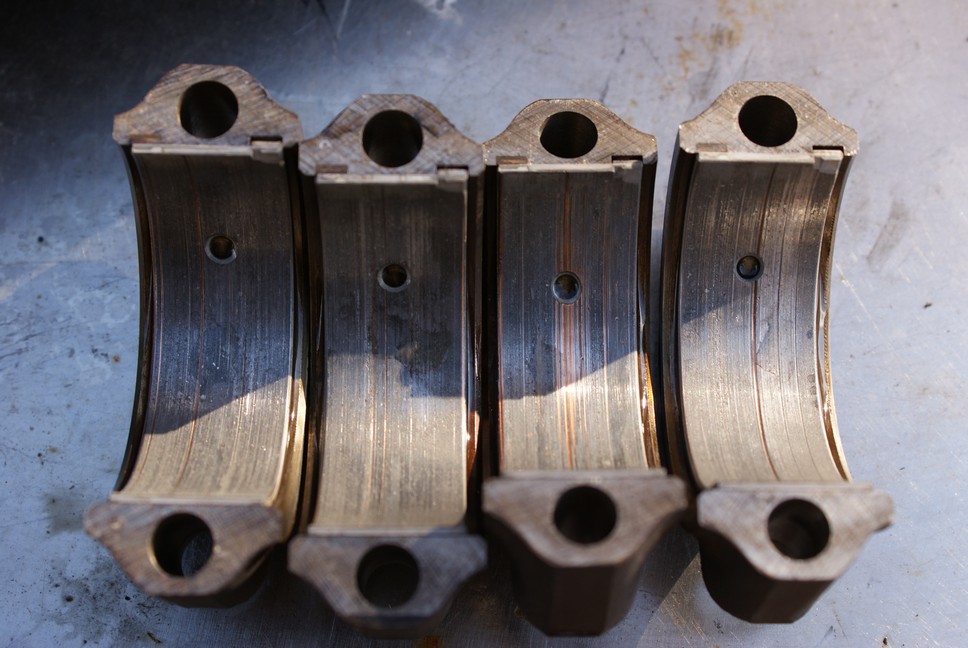

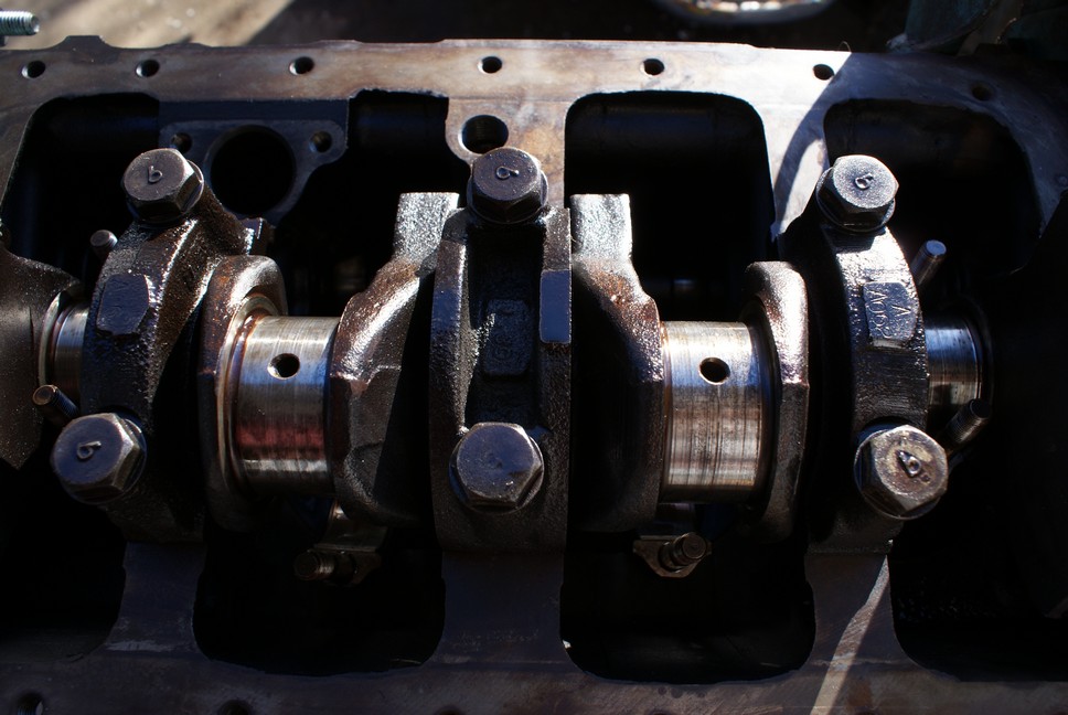

now we are getting to the bottom of the problem
Big end Bearings are not looking happy

Oz,
If you have a problem obtaining the bearings, we might be able to assist you here in Sydney, dependant on the size you are requiring?
You can certainly see why the littler hammers were out when you started the motor!!! WOW.
I wonder why that happened, low oil, not serviced regularly, ??????
What was the condition of the oil filter? Might give you an indication.
Tue Aug 23, 2011 10:25 pm
its real hard to say, but the car was a town run about and taken on occasional trips so it may have run low on a country run. Also the oil was pretty runny, not quite like water but still thin. May have fuel pump leak back into the sump or even an issue with oil pump pressure relief.
i will be doing a number of tests with no ignition and no plugs to pinpoint the cause once the crank is repaired.
also have some sets of Big and and Main bearings on way over from the US. .25mm and .50mm for the Big end and standard for the mains.
once i know what i am looking at i may well come back for some assistance in finding the right stuff. Thanks for the offer :)
