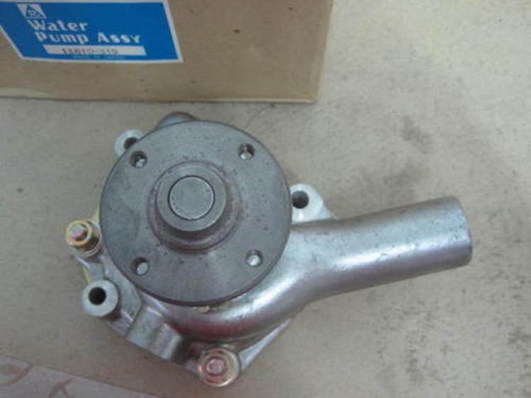

Doesn't look right that one...tread carefully.

The pump or the seller ?
Tue Dec 01, 2015 1:41 am
Both? :mrgreen:

Hopefully the one i got fits then :o . The seller is ok the other stuff i ordered arrived .seems to advertise stuff one at a time
Tue Dec 01, 2015 2:14 am
Every one here that ordered parts has got them
The pump looks pretty right :ugeek:

Yeh had me worried haha so went and pulled the pump off the deluxe . The deluxe pump has one less bolt holding the backing plate on but the rest is identical. Double checked on the other bellett it has 2 bolts holding the plate .so not sure what the deal is there .

Without being cryptic, there's some important differences between the top one and a Bellett pump from memory...we should play spot the difference! I don't think that one will work on an OHC Bellett, but I may be wrong.
Repair kits I've found have their perils...3 different types of seals within PR20 Bellett pumps (carbon, cork and steel sealing faces). Later pumps also have wider bearings, longer shafts and different impellors which operate at a different flow rates.
Not sure what the difference in bolts for backing plates means, but would be interested to find out. Sorry sdoubleb, didn't mean to scare you! The Cypress pump and the Bellett look very similar, yes, so probably good, but safest to check critical dimensions before buying just to make sure.

Not sure if this helps, the G180ss OHC engine has a threaded boss on the side of the outlet pipe.

This answers one of my long standing questions....
The water pump service/repair kit in Cypres is for the late model pump and therefore had the thicker bearing and seal

Are you sure James? I mentioned the pump doesn't look right as I thought it looked taller...bit there's not much difference. If it does fit the same bolts, since it's an entire assembly, I wonder if it can be made to fit if it is in fact too tall (i.e. adapter for belt, different fan)?

I am certain the pump repair kit has the thicker bearing assembly and seal as it is for the 1969 model
As in the picture
Also I have the same kit and I measured it
Too big for my early model spare pump housing
The pump for sale is complete and should fit ....... Should
The different I noticed is that in my G161 block as per postings has a second 10mm hole for heater circuit + cooling 1st piston
In a spare '68-69 sedan block I have, there is another square hole and in the picture above you can see its impression on the backing plate
This would make adapting an electric water pump a bit more tricky than the way I did

Heights on this an pump that was ebay look the same . Pump on ebay has gone . But seller did say he had more pumps

Well, I hope it's the right one mate. But yeah, gotta be careful with these things...the variations are very slight.
James, yes there is definitely a difference in PR20 pumps, so you're probably right that it occurs '68-'69-ish. Would be nice to know for sure!
