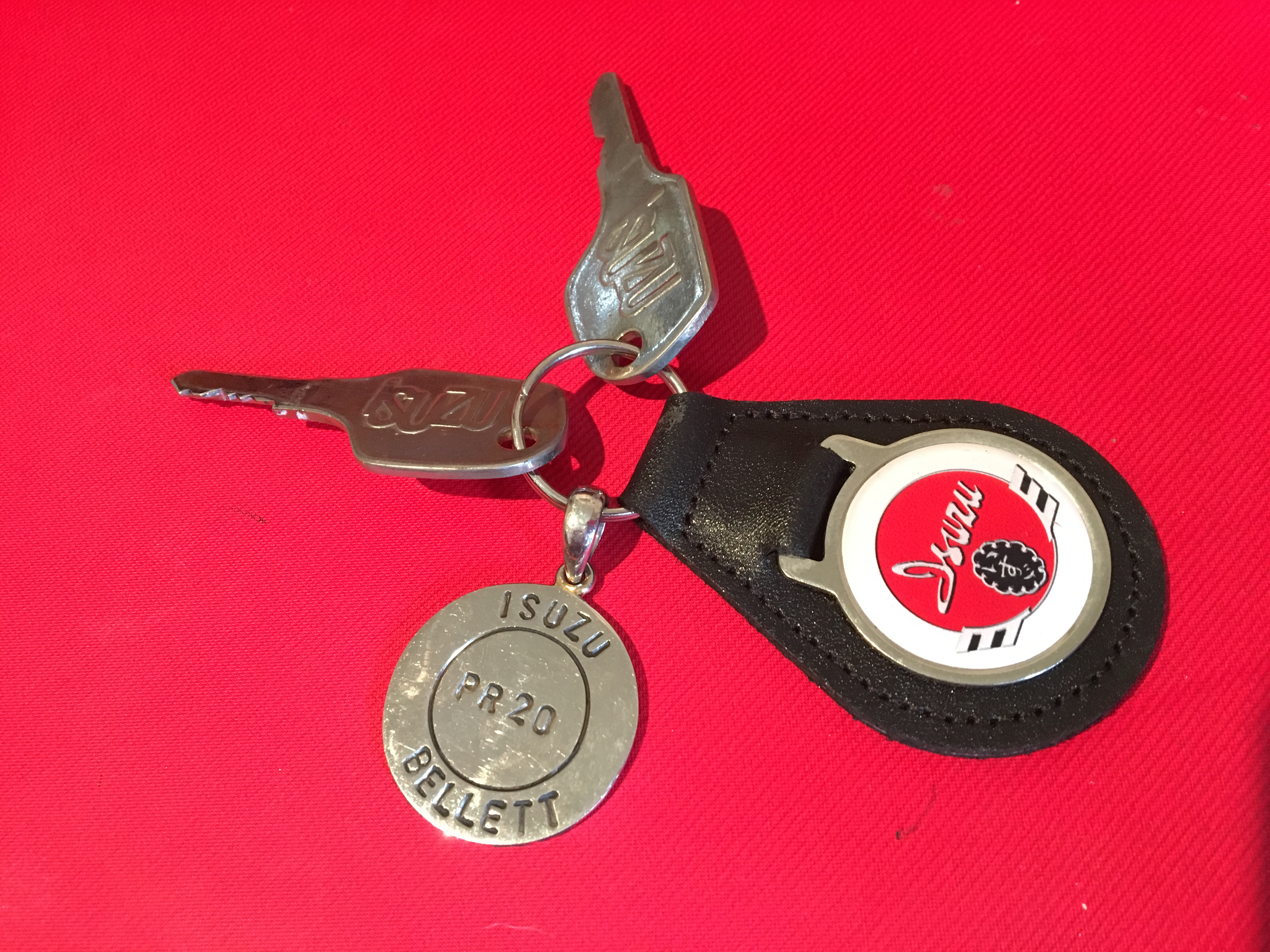

The key maybe it can be cut to suit??

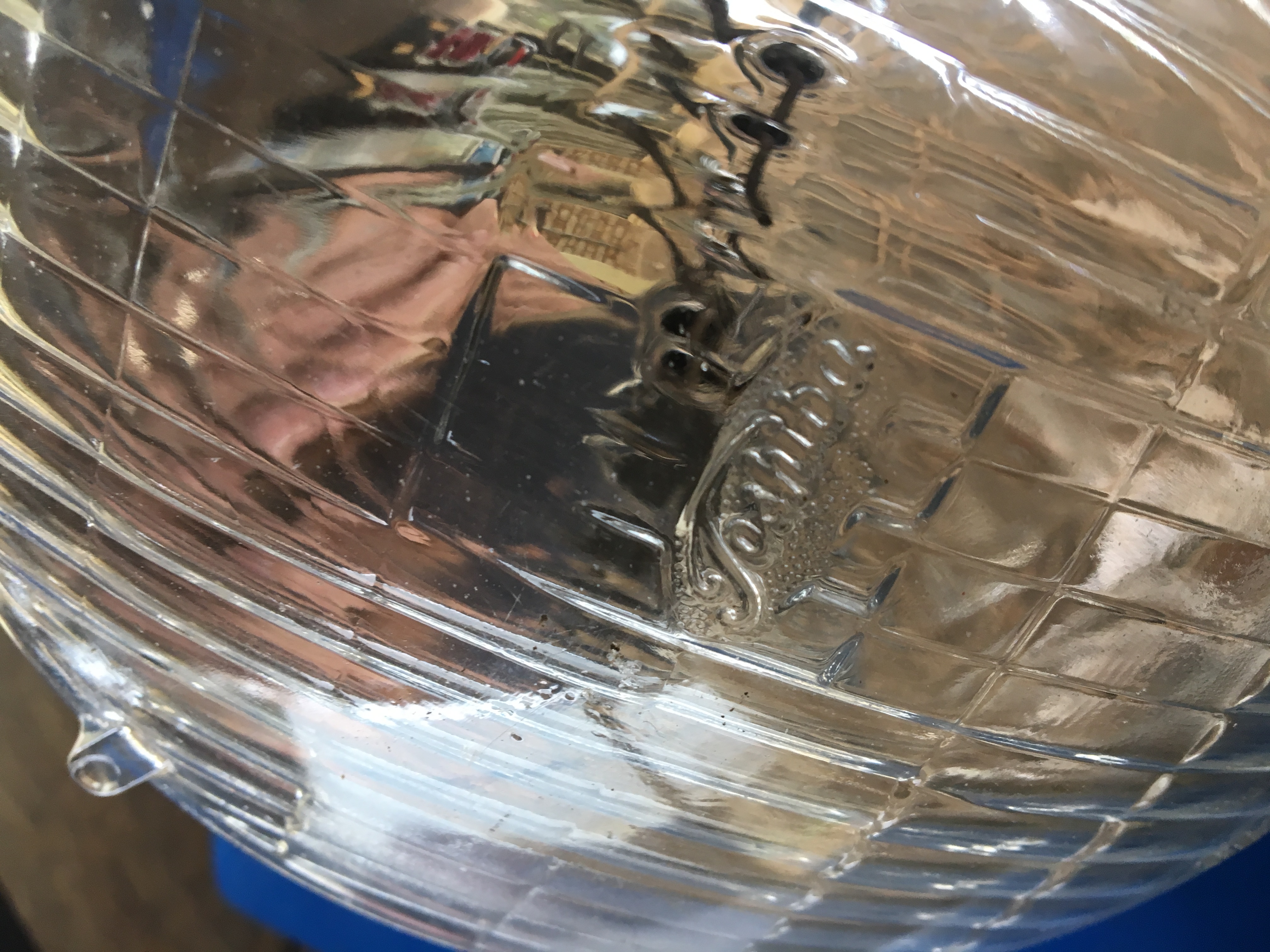

The headlights are originally Toshiba. 2. And 3 prong which one is not original the 2 or 3. Cheers dave

I'll see about the key later today. I'm afraid your key has too deep cuts in it. Suppose I could use it, if I change the lock a bit (I don't know the english term, the moving parts that avoid turning the lock without correct key). I will see, what parts I can get from Finland, it would be easier and faster to get parts from there I suppose.
But thanks for your help.
