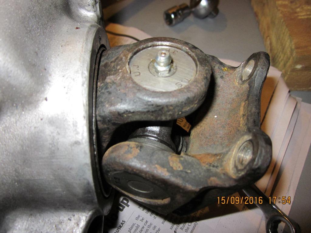

Got the reco'd diff back today, fitted with the late model shafts and new Uni joints. Much bigger Uni than early cars and grease nipple easy to get at also!

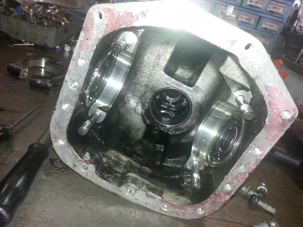

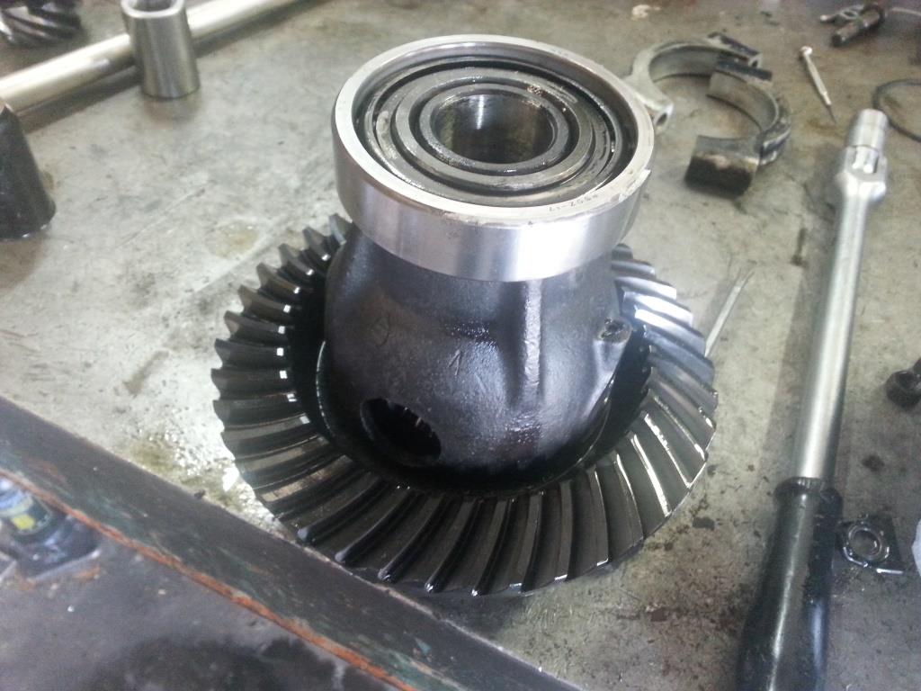

HI Dean, the diff out of the car is currently in pieces for a quick look see and put back together, sorry no LSD but I was hoping there would be !!
Notice there is no castellated nut on the the shaft, the cause of all the problems.
