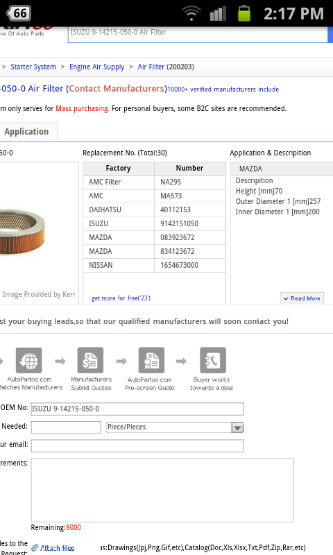

I was flicking through the Isuzu Bellett parts manual in that it has given me the isuzu part number of 14215-050 inwhich google-ing just the number provided me with some results on sites unsure if I am sending people on wild goose chases but I hope it provides some positive results. This is numbers one site gave me. Hopefully a Mazda AMC or othe manufactures aircleaner
