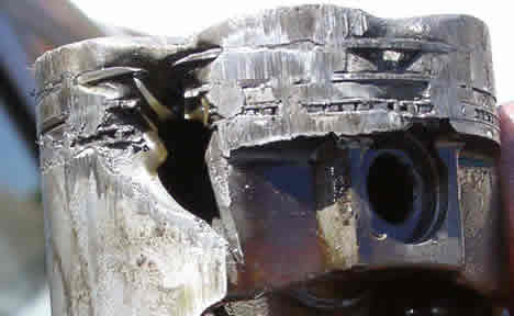

Im for fitting webbers. Webbers dont melt pistons.
