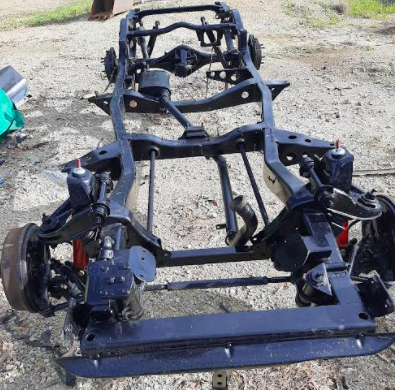

Chassis - 3.9 dif exhaust, rear brakes & lines, handbrake cable done.

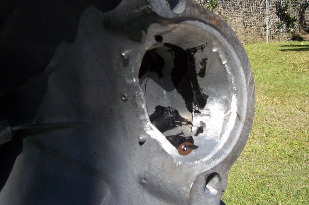

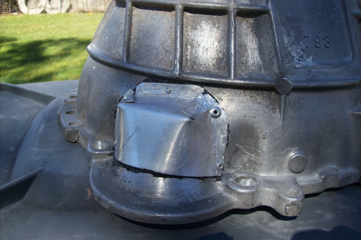

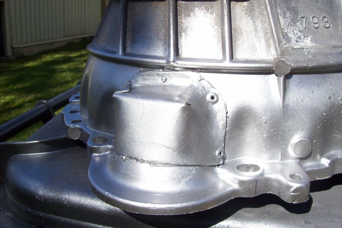

Cutting the 5 speed transmission housing away is what I had done to fit the standard starter to my sedan. The housing shown
is probably out of a KB Rodeo or a UBS Jackaroo Diesel (left hand starter) with a what we called in the auto parts industry
a "dropped down starter drive". I manufactured a cover from 1mm sheet alloy and sealed it with urethane and used heavy pop rivets.
I then painted it silver and the area around it. You wouldn't notice it until it was pointed out .
Clyde.

File comment: Using Josco grinding bit on cordless drill.

File comment: Trial fit.

File comment: Final with paint.
