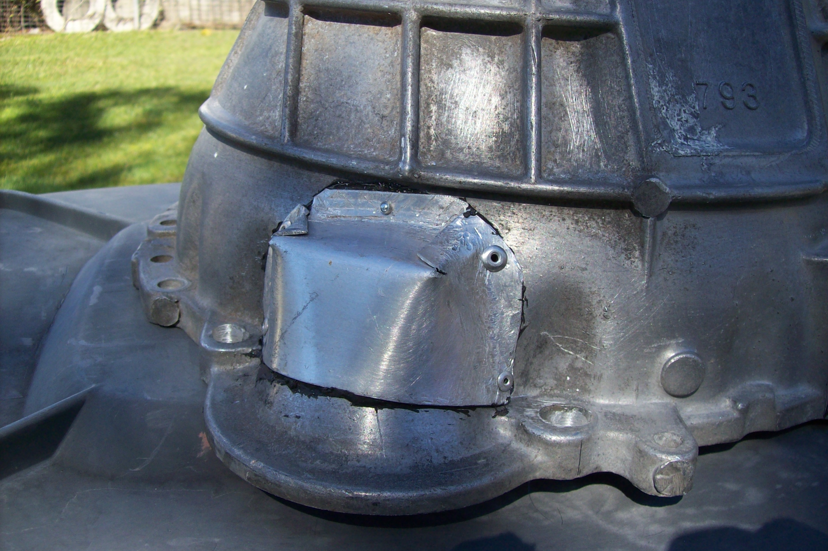

Author:  CQGT [ Wed Apr 13, 2022 4:25 am ]
Post subject:  Re: Reston twin losing its yellow paint
Cutting the 5 speed transmission housing away is what I had done to fit the standard starter to my sedan. The housing shown
is probably out of a KB Rodeo or a UBS Jackaroo Diesel (left hand starter) with a what we called in the auto parts industry
a "dropped down starter drive". I manufactured a cover from 1mm sheet alloy and sealed it with urethane and used heavy pop rivets.
I then painted it silver and the area around it. You wouldn't notice it until it was pointed out .
Clyde.
I'll see if I can upload some pics. Every job I did on my sedan I took multiple photos. I can't seem to go into and download them.
Author:  CQGT [ Wed Apr 13, 2022 4:54 am ]
Hi Clyde.
Attached pics.
Enjoy.
File comment: Using Josco grinding bit on cordless drill.
File comment: Trial fit.
File comment: Urethaned sealed and riveted.
File comment: Final with paint.
