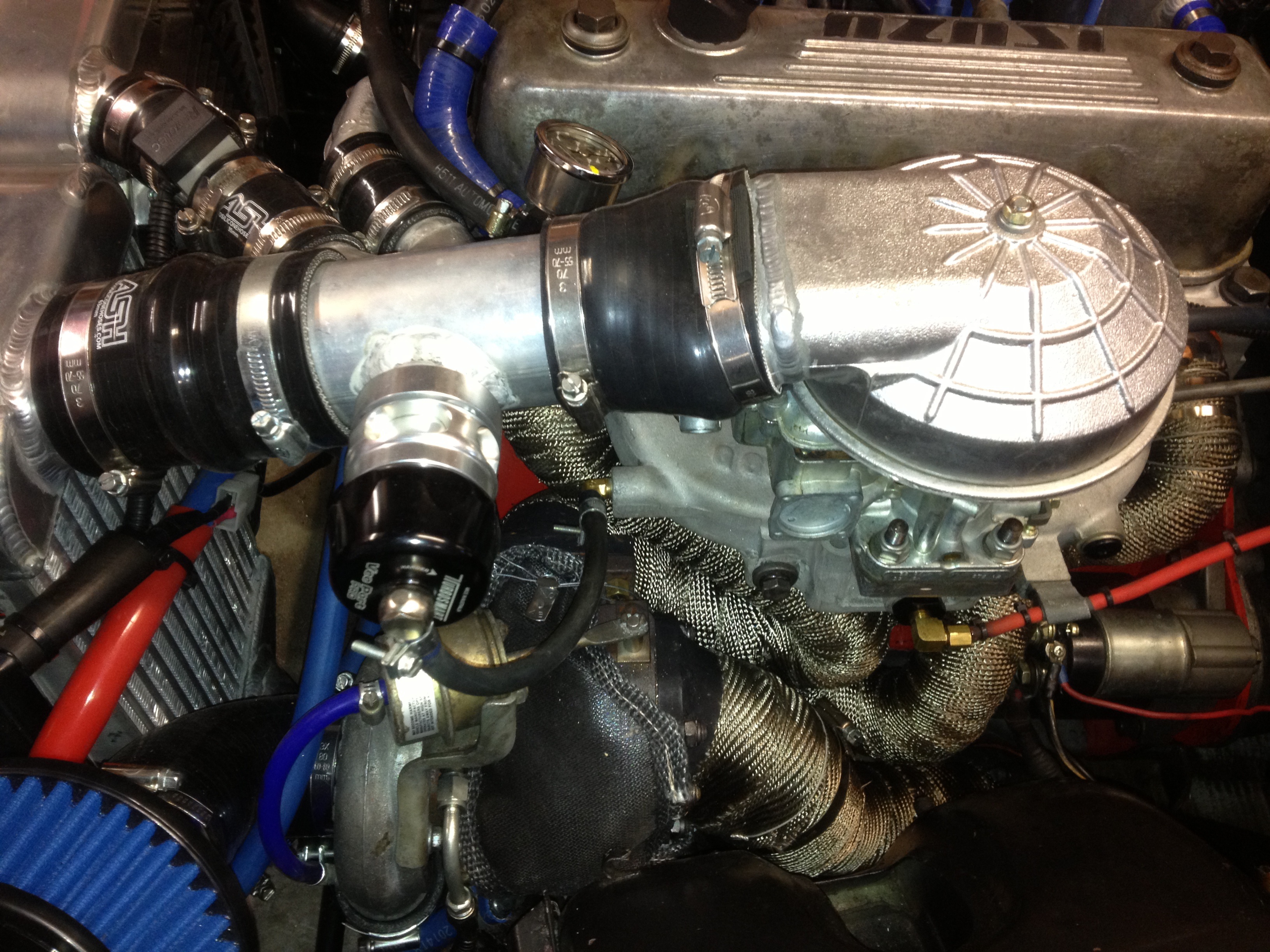

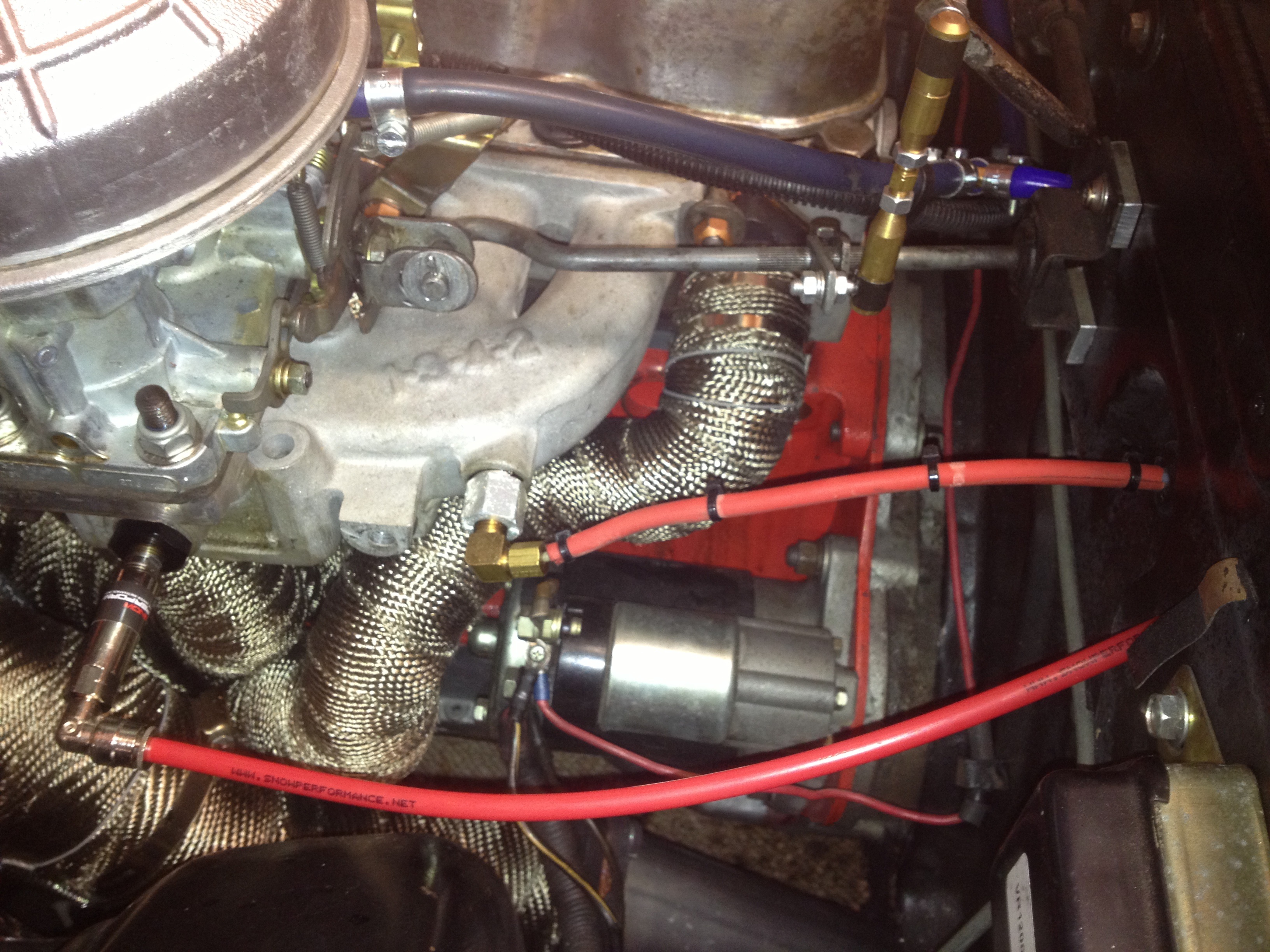

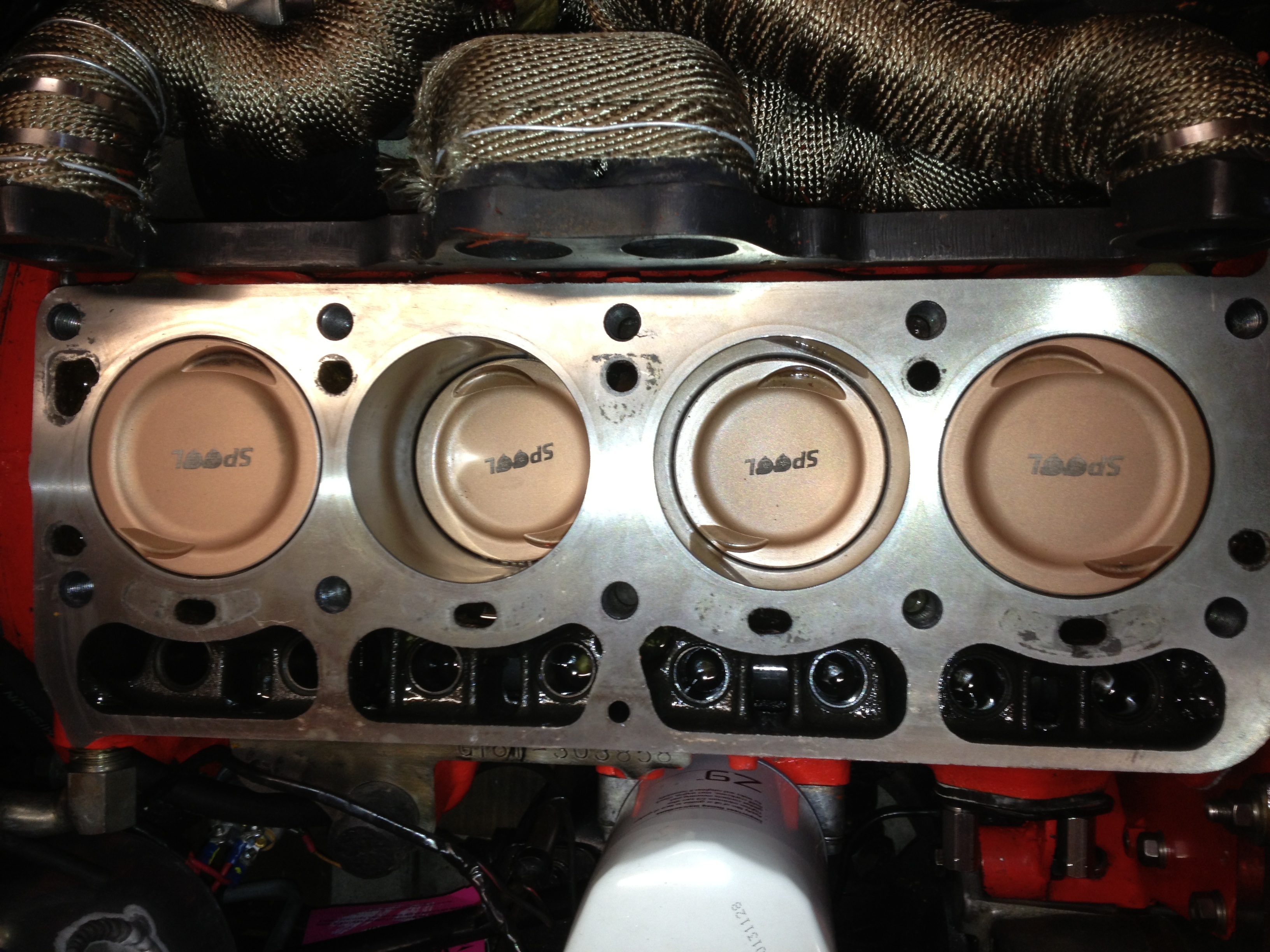

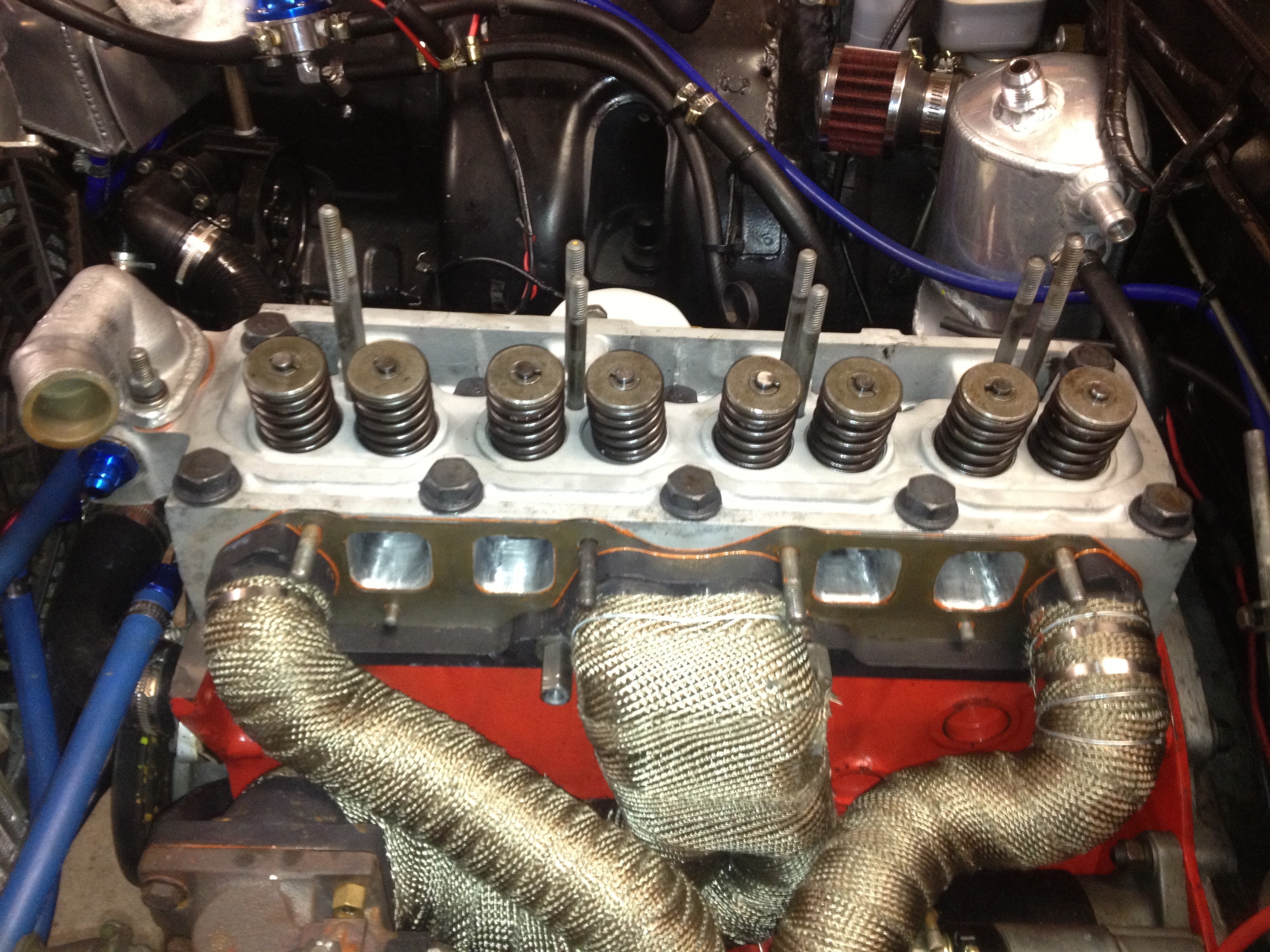

I'm happy to post some pickies so here are a couple
James

Hi All
Bit of an update
So far so good
Have put 110km on Asroc and she is going great
Boost between 7 - 10psi
O2 sensor Readings -
Full boost 10.5
Moderate load 11.5-12.5
Idle 13.4
Cruising 13.5
Otherwise the 'Butter zone'
Plugs perfect
No pinging
Torque impressive
Let the good times role - hopefully!!!!!!!!!! :)
J

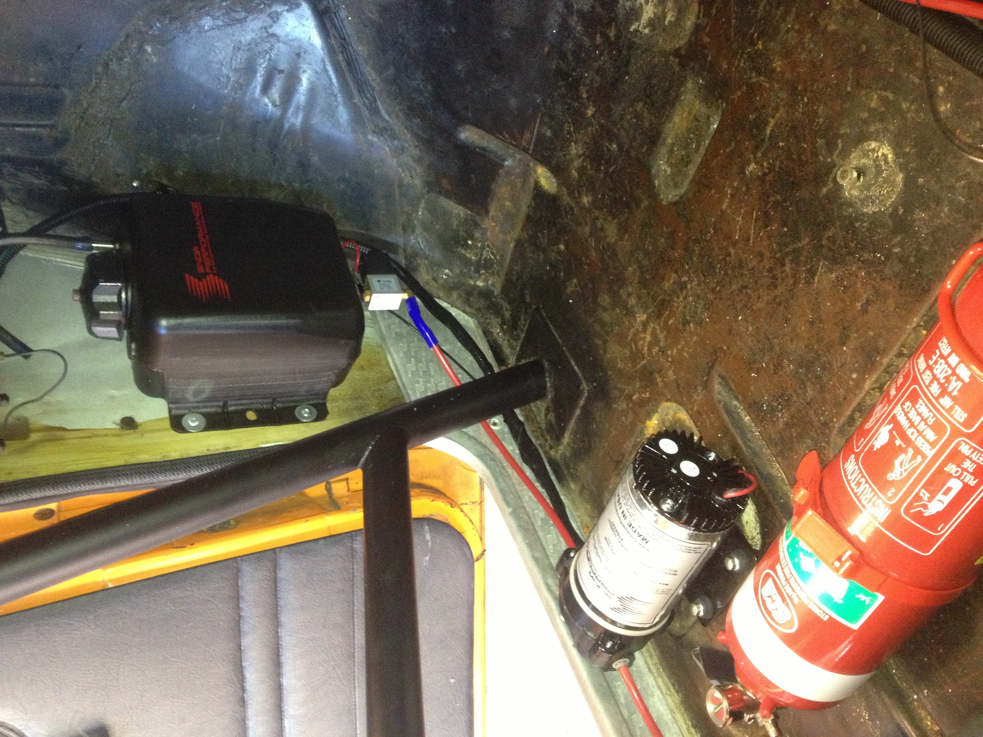

Hi All
Thought you may be interested
Final 'tweak' (for now anyway)
I bit the bullet (with all the excellent builds posted past and present) plus as a very good insurance measure against detonation
And fitted Water/methanol injector system.
I mounted the injector right under the carby in the inlet manifold for best effect
Pulls like a Malley Bull
J
