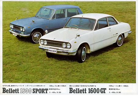

Classic pic of a 69 sedan and GT from the day.
File comment: 68/69 Sedan and Coupe
Sat Sep 13, 2008 11:43 am
i've got that pic here too. is a good pic from the day.
except... they are 69 models, not 68's.
the 68 sedan has the same grille as my race car (same as 66 and 67 models), and the 68 GT was the last of the single headlight ones, again, like mine (67 GT was the same too).
some very early 69's were registered in late 68, so they sometimes get called a 68 model, and the 69 GT actually came out in late 68 as well.
the 70 model looked the same but had the vents in the rear guards and had the "short" bonnet with the drivers side wiper post at the bottom of the A pillar (they had a wiper set up like "normal" cars of today).
i've seen chassis numbers posted around the net that aren't quite right, as cars i've had in the past haven't lined up with the supposed commencement dates.
my first car was a 69 deluxe sedan (actually the same car that has come back into the fold that my old man is about to rebuild) that was definitly a 69 model, chassis # 4105202, and was first rego'd in april 1969 in victoria, but if you believe the numbers posted about the place, they say that the 69 started in january 69 at chassis 4111534. that's 6332 cars after mine was built. also, as more evidence, garry now has dave's (from nsw) 69 sedan that was first rego'd in nsw in early 69 as well, and it's chassis # is 4105209, only 7 after mine. they are the 2 closest chassis numbers known left..., but anyway, 2 cars out of sequence can't be wrong!!
to go off topic with a factoid of useless info... well not useless if you need a new windscreen for your Bellett... as you probably know, there's a different screen for early and late sedans.
the EXACT chassis number that the FIRST LATE SCREEN was fitted to was:
PR20 4093588.
so any number before this has an early screen, and any after has a late screen.
the difference in the screen is the shape of the top corners. the early one has lower top corners.
just to confuse things more, this change happened in the middle of the body run of the 67-68 sedan (with the "square" tail lights), so Isuzu didn't even do it when they changed the lights, grille, dash, etc.
all the "tear drop" tail light sedans use the early screen, and all the "flat" tail light sedans use the late screen. the only model that you have to be carefull of is the "square" tail lights cars.
why they changed the screen shape is anyones guess...
and the Wasp uses the same screen as the early sedan.
and while the GT screen is different again, all GT screens are the same (they didn't change when Isuzu went from PR90 to PR91).
cheers.
brett.

Hmmmm, I'll have to show you mine at the nationals. It's definately the above grill (and flat tail lights), only two owner so unmolested and it has the original book with a delivery date to the first owner of November 1968, first service in December 1968....
The plot thickens. I'll be interested to get to the bottom of this one for the models. I believe that mine is classically a 1969 model but it was definitely driving around Adelaide in 1968. I'll post my chassis number when I get the chance.

interesting indeed...
sounds to me like it's probably a very early 69 style. after all, mine hit the road in April 69, so there's no way that it was built, shipped, bought, and rego'd in only the first 3 months of the year!!
i'd be very interested in seeing the chassis number, that's for sure, as it's definitly a 69 style, but it's a very early one then, and a rare Bellett too!!
they are the rarest body and light shape that came here.
anyway, 90% of those cars in the pic above were sold in 69 , that's for sure.
