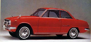

File comment: Picture from the page :

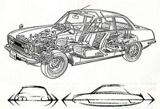

http://www10.ocn.ne.jp/~awjuno/sub633.html

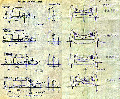

http://www10.ocn.ne.jp/~awjuno/sub635.html

there was this thing is immeasurable effectiveness there is a preparatory stage prior to the development of two important Vered now.
One is a suspension Seminar meeting. Over 30 of the development department, including those directly related to non-30, leading to new employees from deputy director took part in was a half year period. The meeting was held on overtime hours. Research at the time of the suspension was the hottest theme of engineers in the automotive industry. Was able to understand the concept sharing center say roll, axle steer, reverse steer, and move, such as for example an in-weighted techniques such as non-experimental research design for this result.
Although the following was most used car was purchased by the bold decision of the vehicle reference Vered, director of research development of Ito. From the circumstances of the time, VW Beetle, Renault Dauphin, Morris 1100, Morris Minor, DKW, Triumph, other domestic front-wheel drive such as car, rear-wheel drive, had been covering the method suspension various FF, FR, RR, coil, leaf spring and torsion bar. These are not only been subjected to the test simply, design, research . over chief clerk is allowed to use to commute to work in shifts, was driven with the feel of driving
