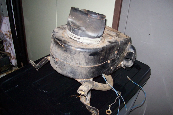

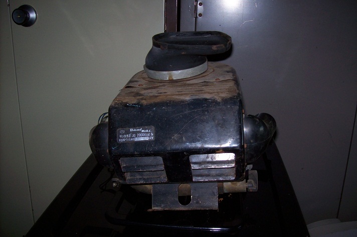

Here are a couple of pics of the heater unit that sould be in a "68" :D

Yep, that's how the fan boosted unit should look. For Aus delivered cars though, these are pretty uncommon. Story is that imported cars were required to have a percentage of Australian content. 'Standard' cars had no heater, but many were fitted with a non-boosted unit as a dealer fit (along with radios, carpets & DeLuxe badges) to bring this content up. They called this "DeLuxe equipment". This changed in 1968 as the boffins changed the rules to allow full imports. Then you could buy a 'Standard' or a proper DeLuxe with the stainless window frames, etc.
For '67 & earlier, to get a boosted heater you had to find a fully imported DeLuxe. Some were brought in , and 'Doris' is one of them. She is my '66 teardrop auto DeLuxe.
