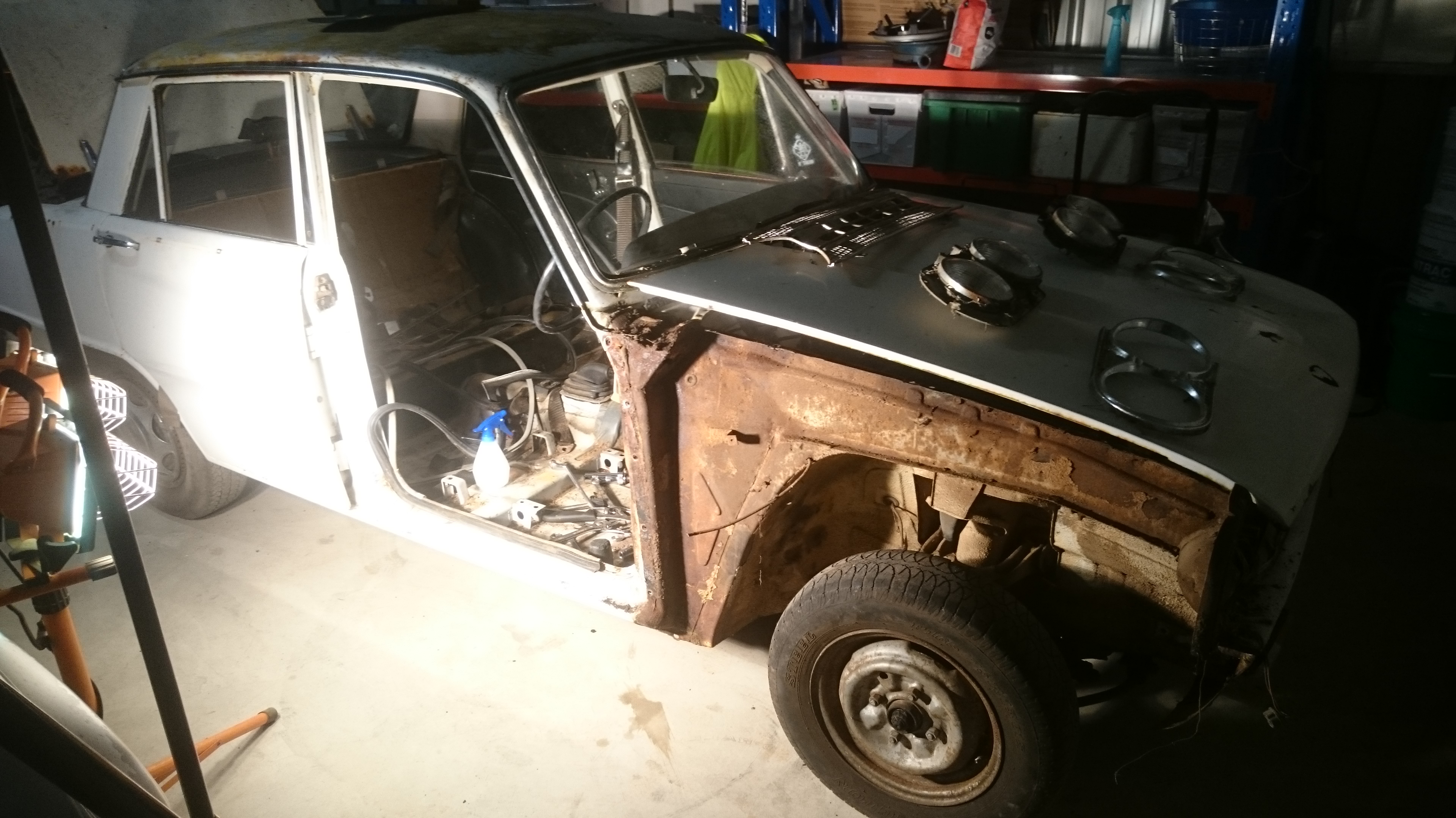

Had a win... Did have all the bolts out. Sealant holding front guards on looked like sikaflex had the hit a sharp knife around joins using a mallet :? . Got door off with persuading it with blow torch and impact driver. On to the other side now

Looks tidier than most
Keep up the good work

Well done. Sometimes it can be a pain getting stuff off. Bolts and nuts are often not obvious but then you had to solve the sealant problem. It's good to see you wanting to do a strip down as you find so much stuff that will only cause problems later. Good luck with it. It all looks good from your pics.
