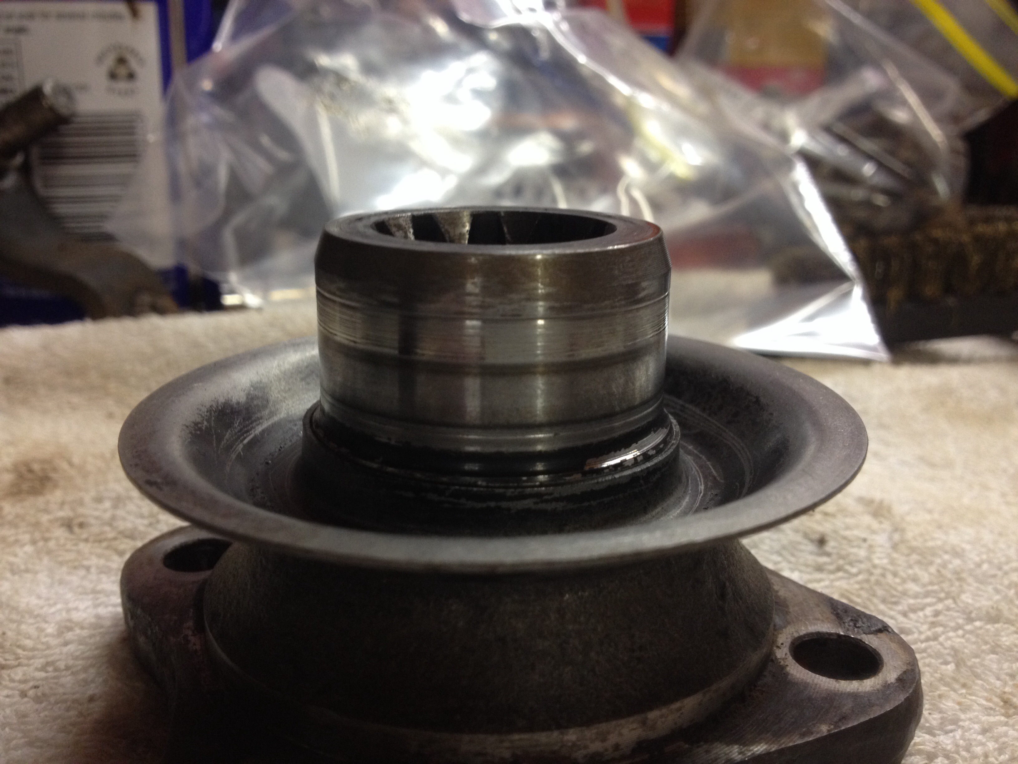

The number for the seal is. 17446 in Flaseal. P4768 Repco/PBR.
Now. This the tricky bit. From what I've found the 2 Companys either don't exist and/or
are no longer being manufactured. The bearing company may be able to crossover the numbers to
a seal of another brand.
I sent my GT diff to a specialist in Brisbane and they sourced all 3 seals from their local
bearing comany. They had a sample seal and supplied the dimensions of the housing and the pinion
drive flange to them. Procuring them was not a problem. Getting the side carrier bearings was.

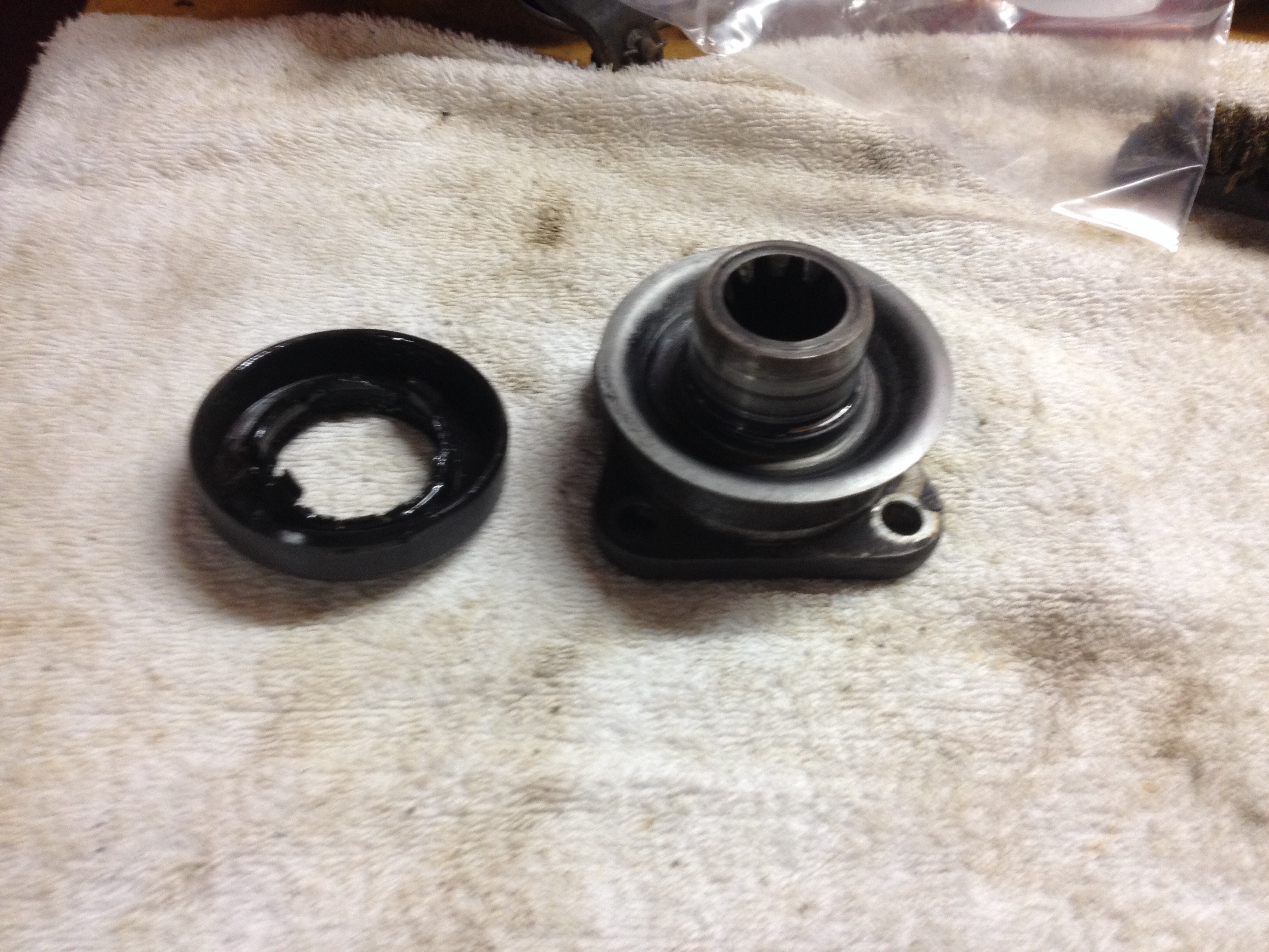

If you have a slight groove on the pinion drive flange. Enquire about a speedysleeve and purchase
some 2 pack araldite to glue it onto tne flange. If they haven't got the parts they may be able to
buy them in from another branch and you pay for the freight. Sometimes they can add to an order
and you may have to wait a while and not pay the freight.
If the seal is either 1 mm under or 2mm over in thickness. Don't dispair. As long as the seal runs on
the flange, which it should do, as the seal sits in the housing and has no bearing on the tension or
freeplay.
Keep us informed. No doubt you will. Happy hunting.

Eureka
It fought me all the way but bit by bit got the yoke off
50 year old Seal hard as hell and a real sh@# To get out lying on your back on concrete at 0' but hey, that's a heat wave in Tassie :lol: ..
The yoke will need sleeving as u predicted I am Afraid
J

Speedi Sleave
Best invention known to man
http://www.bsc.com.au/sites/default/fil ... 6Shaft.pdf
Thanks Dave
