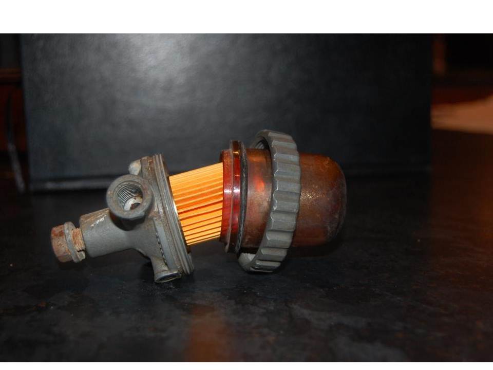

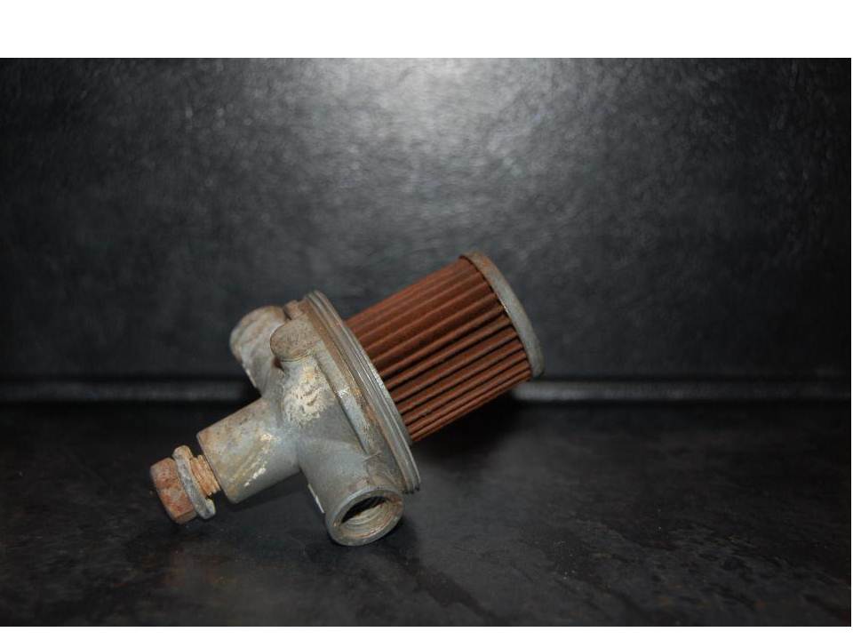

photos on today once downsized and posted cheers davo .......hey dave it doesnt leak cheers davo
Sun Jun 10, 2012 8:58 pm
here goes it works for me no leaks car ran for 10 mins cheers davo if you cant work it out email me

Mon Jun 11, 2012 8:23 am
Looks spot-on Davo, great work!
A cheap solution to the disappearing parts problem.
