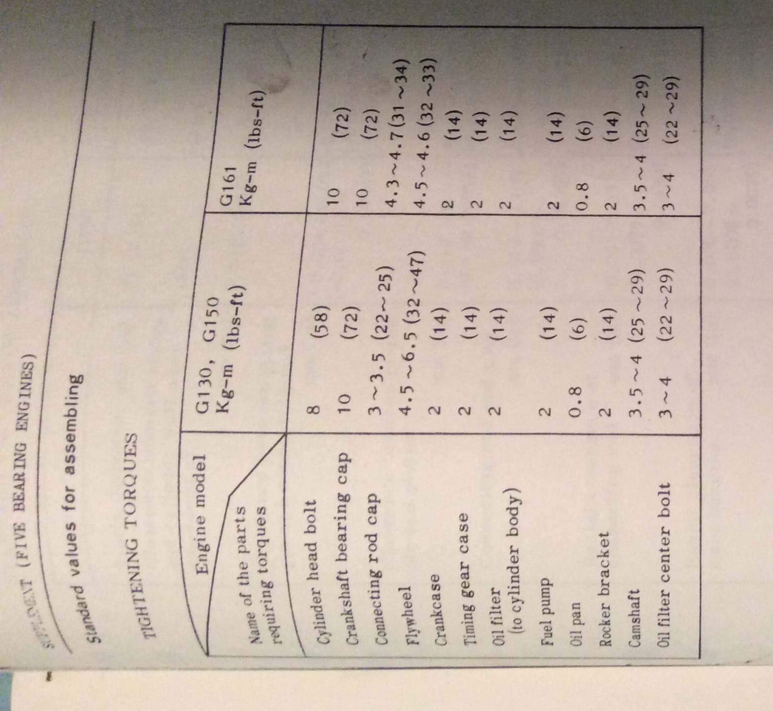

Here is the table of tightening torques for 5 bearing engines,
Lewis.
Sun Jan 08, 2017 7:56 pm
Yippee.
Thank you so much
:D
