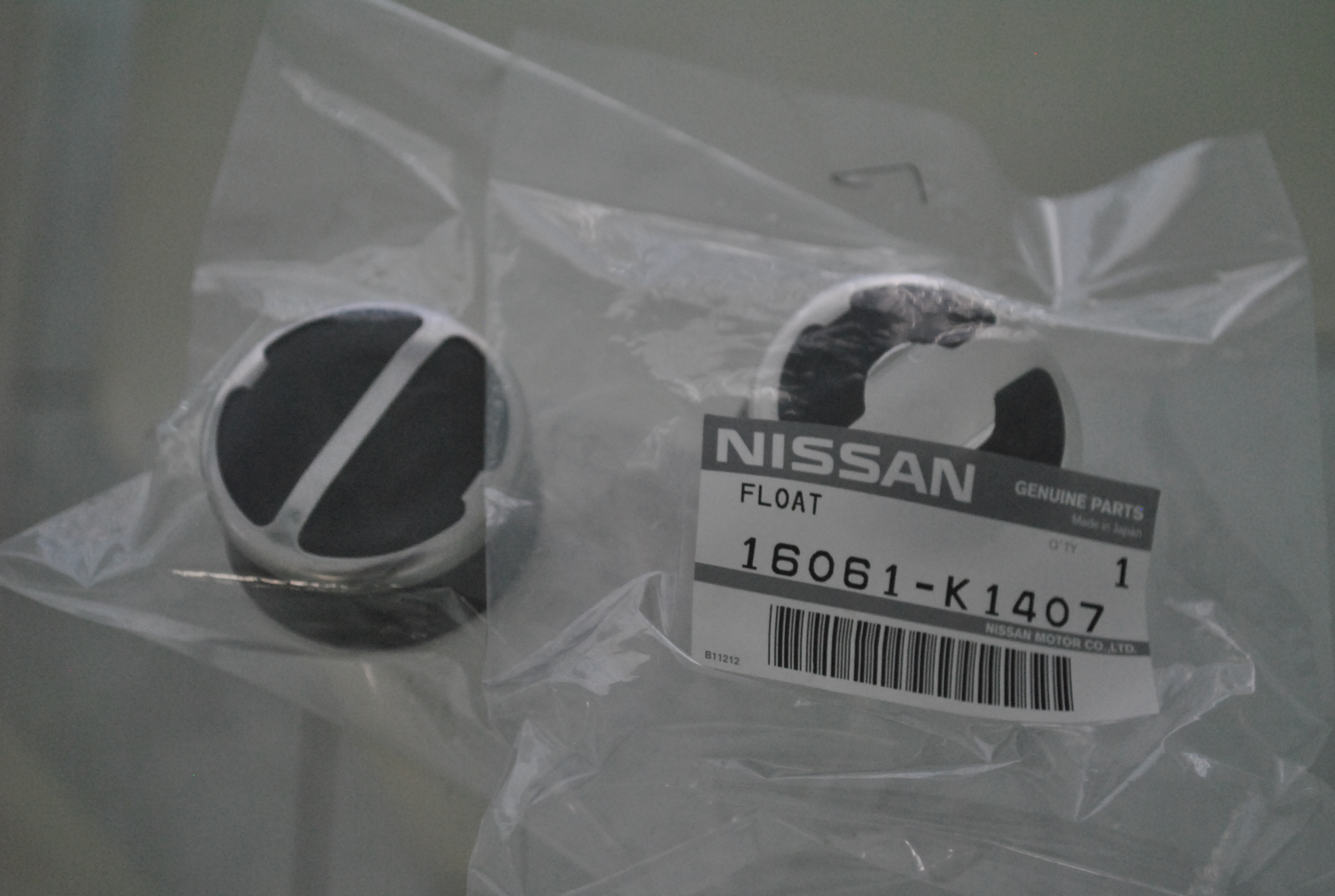

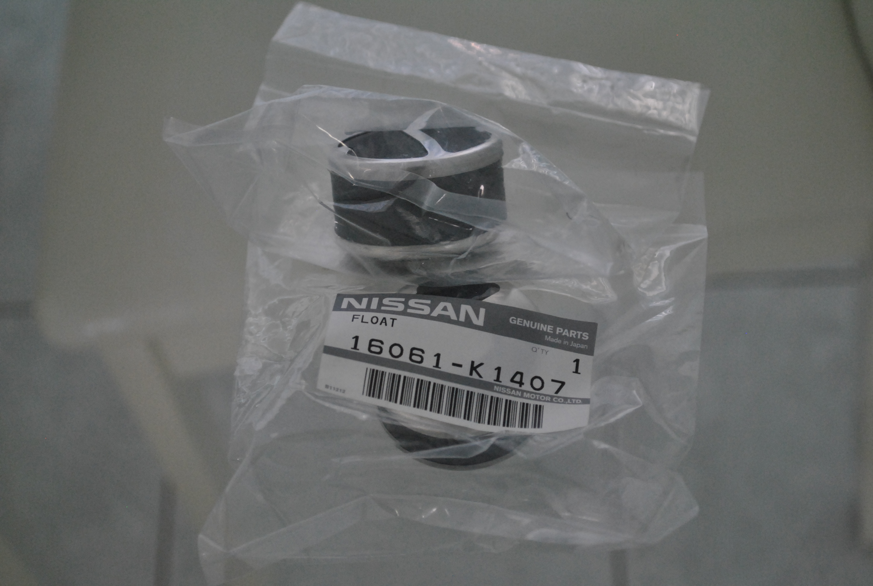

For those of you that would be interested, I have just purchased the new floats here in Mudgee, for the pair I paid $101-10 including GST. (I was told that was trade here in Mudgee). ;)
You may do better with the price, my main point is, as per Lindsay's comment, available right now ex stock Melbourne!
If these are the only comparable part, I think they are the only ones available, good to have some spares while they are in stock!! :D
Thank you again Lindsay.
Wed Feb 05, 2014 1:23 am
This is what the Nissan floats look like, they arrived in Mudgee today 8-) .
Should I ever need them now, I will not be off the road. :)

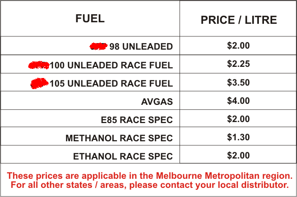

Hi Brett, that maybe, but the upshot is that most us just have to use 98 as it's more easily available, generally. Or at least the hopefully better 98's. And anything over 98 is probably wasted anyway in our cars.
The cost per litre is a bit offputting also ! (name of fuel has been obliterated) A drum deposit is also required.

Thats the price given on their web site though. What do you pay?
It's academic anyway. IMO there are simply not enough outlets to use this fuel on a regular or convenient basis. For dedicated racers etc, different story.
It also appears the fuels contain ethanol anyway, which was the whole point of this thread:- extract below.
