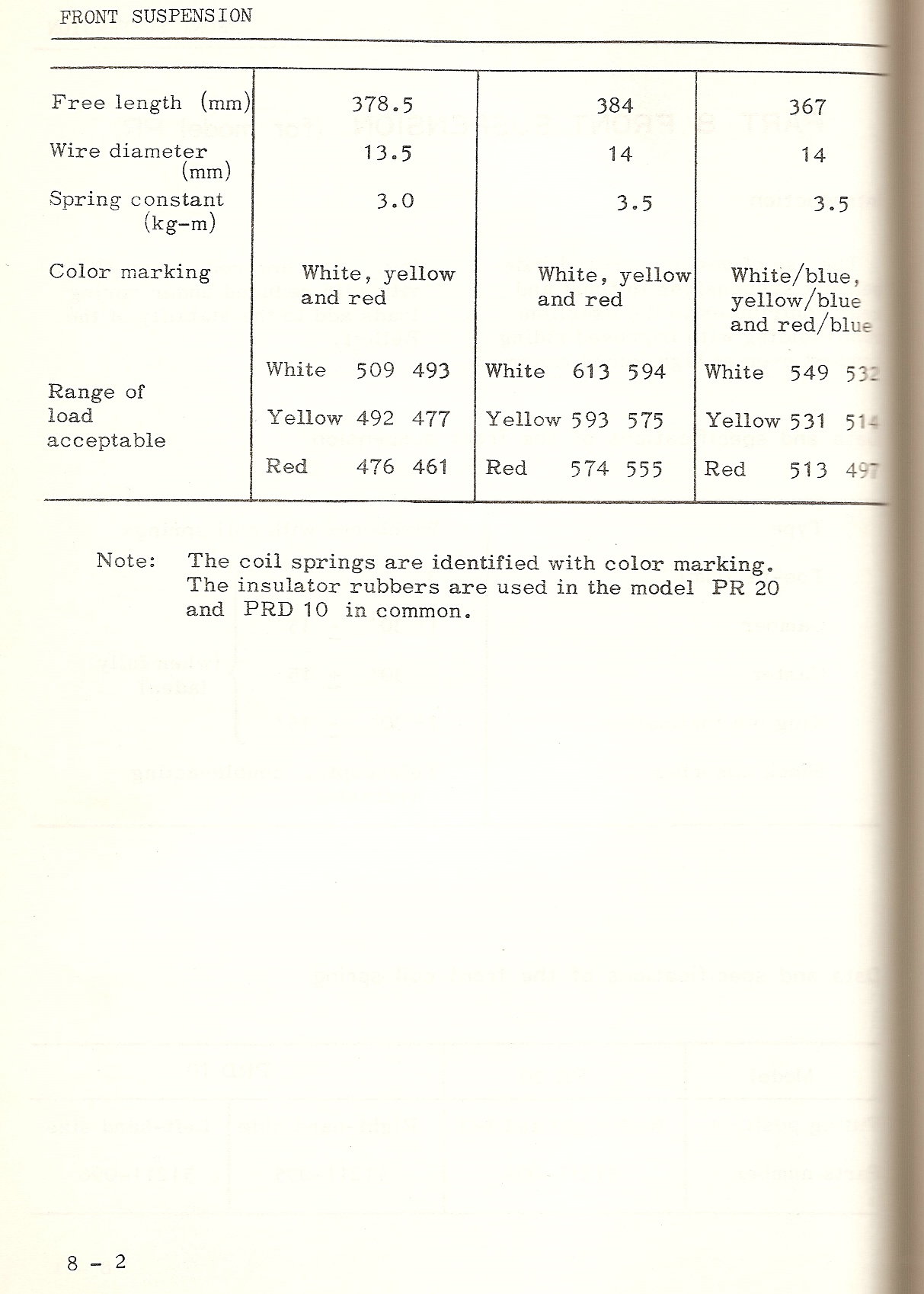

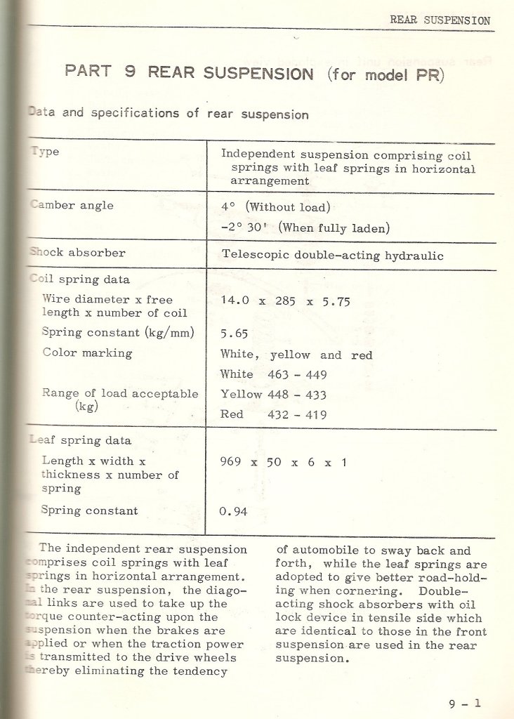

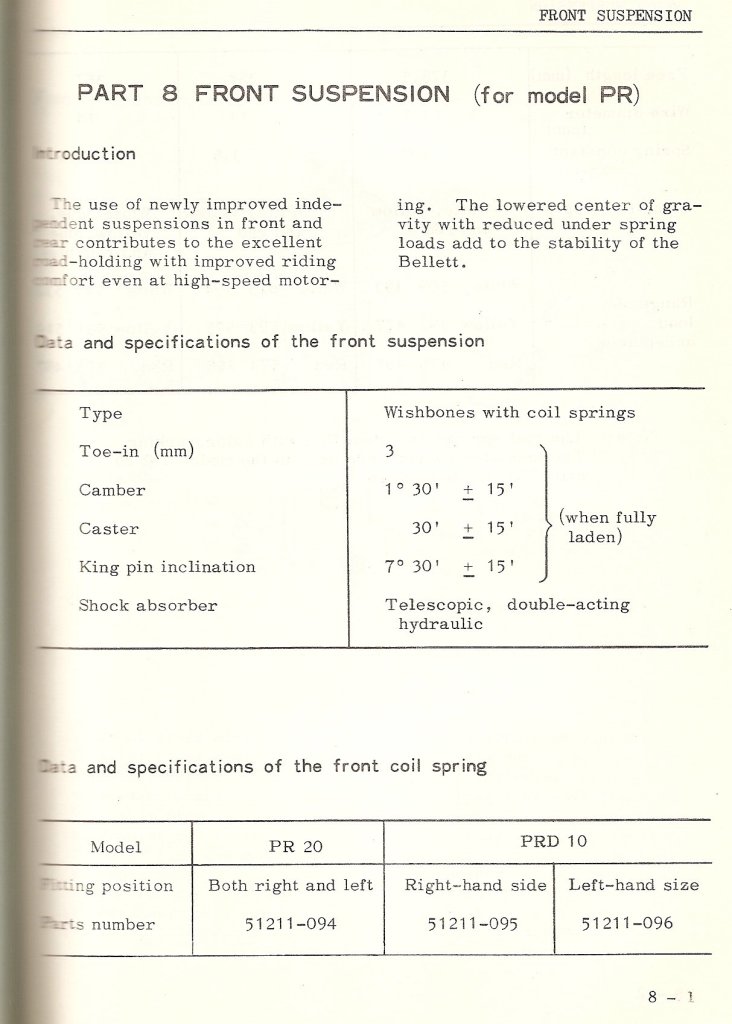

I have workshop manuals (chassis & engine 1968) and i thought id scan off the suspention specs as its handy when your ordering new springs and stuff if any one wants anything in particular let me know and ill scan it

Whoah this explains the small dab of coloured paint (red, yellow & white) that Brett pointed out to me a while ago. Hadn't paid it much attention beforehand. I wonder how these different rates got into different cars; Brett reckons it was years I reckon (was that right?) but this might show that they were all available at the same time. Or something. Handy post! Cheers
Wed Oct 22, 2008 9:38 am
Joined: Thu Sep 18, 2008 3:15 am
Posts: 46
Car(s): 1968 Isuzu Bellett - SOLD to Kazmaxx, 1965 Isuzu Wasp, 1964 Toyota Crown, 1984 Toyota Sprinter AE86
yeah might cover different engines? mine got white on the back that was a 1500 originally
Wed Oct 22, 2008 9:41 am
Cool, mines got the white ones in the front now too, thanks to Dave :)
Now I know for sure that they are the hardest!
Thanks.

Easy for you.
We have all same coloured springs in Finland ; RUST BROWN ! :cry: .

Front Spring OD: 118.92mm or 4.682 inch
Coil Diameter: 14.28 mm or .561 inch
Front Spring ID: 90mm or 3.56 inch
Front shock free length: about 14 3/4 inch or 2915mm
The spring ID is a little more important than much of the information listed on those scanned pages (but I still wish I had that book), because the spring appears to seat on a mount that fits to the inside of the spring coil.
Eibach happens to sell coilover springs for offroad use in a standardized offroad coilover in a size of 3.63 inch ID.
For 11 inch length, the selection is 125-450 lb/in in 25 lb/in increments.
In metric that is 2.2375-8.055 kg/mm in .4475 kg/mm increments.
And then from 500-700 in 50 lb/in increments.
In metric that is 8.95-12.53 kg/mm in .895 kg/mm increments.
12 inch length has a narrower selection, 200-500 lb/in in 50 lb/in increments (compare to above for metric).
13 inch has the same selection as the 11 inch.
But for any performance tuning purposes, 11 inch with either rubber end pads or a threaded perch would be the choice for Belletts. 9 or 10 inch lengths might be nice, but don;t seem to be a standardized length. Eibach and Hypercoil can do custom springs, but they are a bit pricey.

There should be some differences between the suspensions of the GT and Sedan. Small changes in the spring rates and lengths, the shock absorbers, etc. Pages 8-1 and 8-2 seem to specify PR20 and PRD10 without mention of PR90.

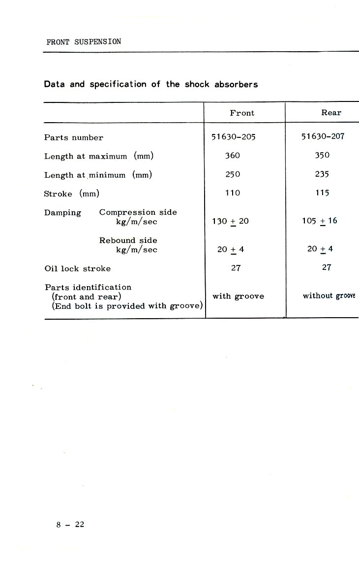

Anyway, I scanned in the shock absorber chart. Front max length of about 14.17 inches, min length of about 9.84 inches, mid point for at rest position under load would be 12 inches. Rear max length 13.78 inches, min length 9.25 inches, mid point for rest position under load would be 11.52 inches.
The bad news is that the shortest coilover we deal with is 15.68 inches at rest length, so it is too long for a Bellett. Looking at the Hakosukas, they have strut suspension with high mounted camber plates, so they look like coilovers are easy on those. The Bellett upper shock mounting point is a stud. And it looks like camber is adjusted via a shim between the upper trailing arm bracket and the body of the car. At some point, in 1964 or 1965, somebody in Japan made a decision to really mess up my plans and any chance of a Saturday afternoon alignment change from street settings to track settings for Sunday morning racing.
Worse news is that I am not seeing much in double adjustable shocks with a 14 inch max length and 9 inch min length. The muscle car stuff is too long and the formula car stuff does not have enough stroke.
File comment: Shock Data

you are correct on how the front end alignment is done. but...
don't think you'll get a suitable amount of camber and castor out of a Bellett front end for use with today's radial tyres and make it handle anywhere near well enough for any track-style use. these things were designed to have positive camber and very little castor for use with crossply tyres, and were recommended to have approx 1.5 deg of positive camber and only 0.5 deg of castor!!
the best camber i've ever seen on a standard Bellett front end was 0 deg camber, and that was with every shim removed...
put simply, ALOT of front end work is needed to get usefull camber and castor from a Bellett.
as a reference, my GT uses about 1.5 deg of negative camber, and this obviously to work to achieve, and the race car has about 4 deg of neg camber, with took a hell of alot more work!! i can't remember what the castor setting are, from memory, the GT has a couple of degrees, and the race car is around the 4-5 deg mark.

I read the description "..the wheels are farther apart at the top than the bottom when viewed from the front side." and I was reasonably sure that Australian English reversed the meanings of "top", "bottom, and "apart".
