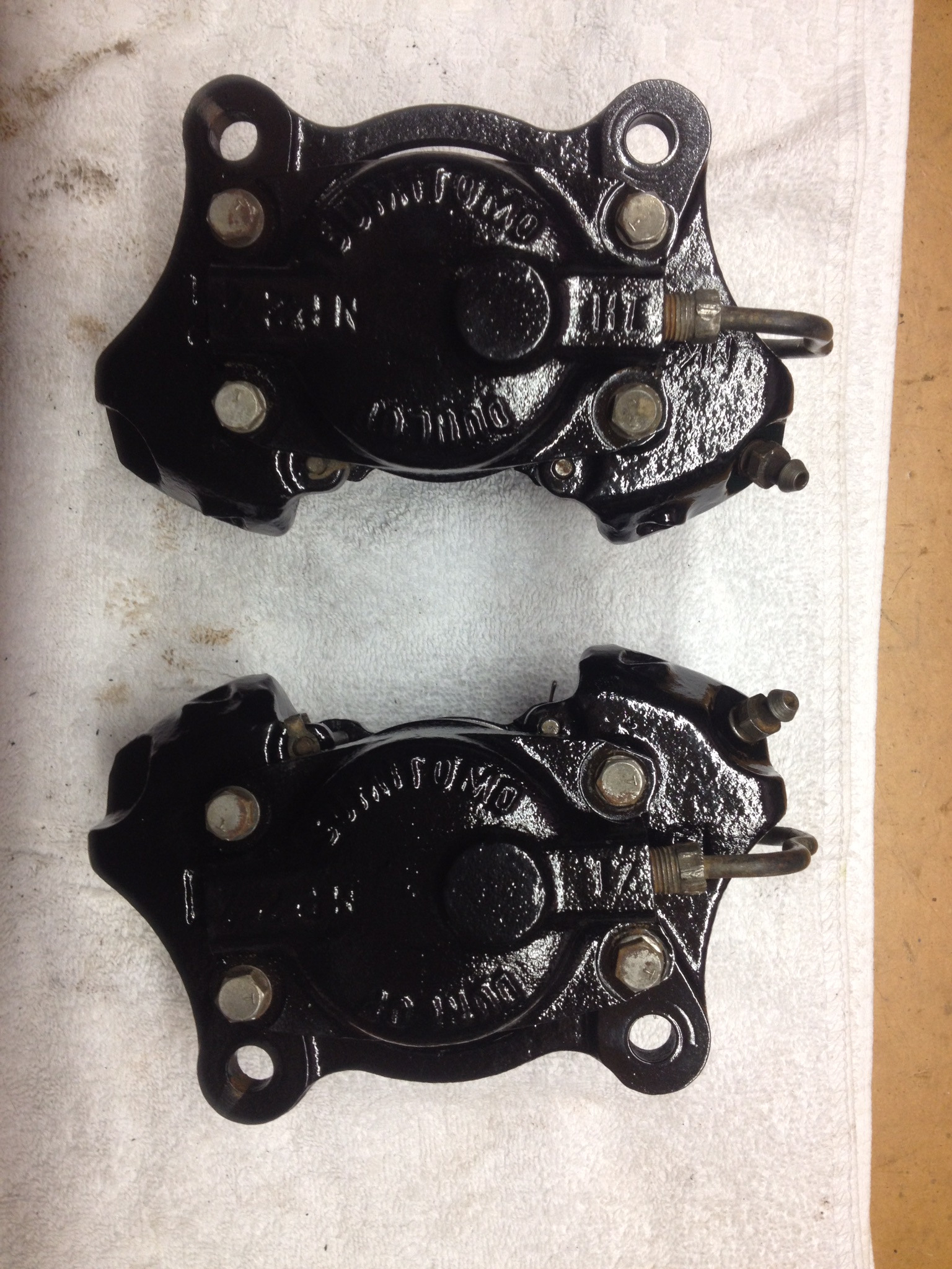

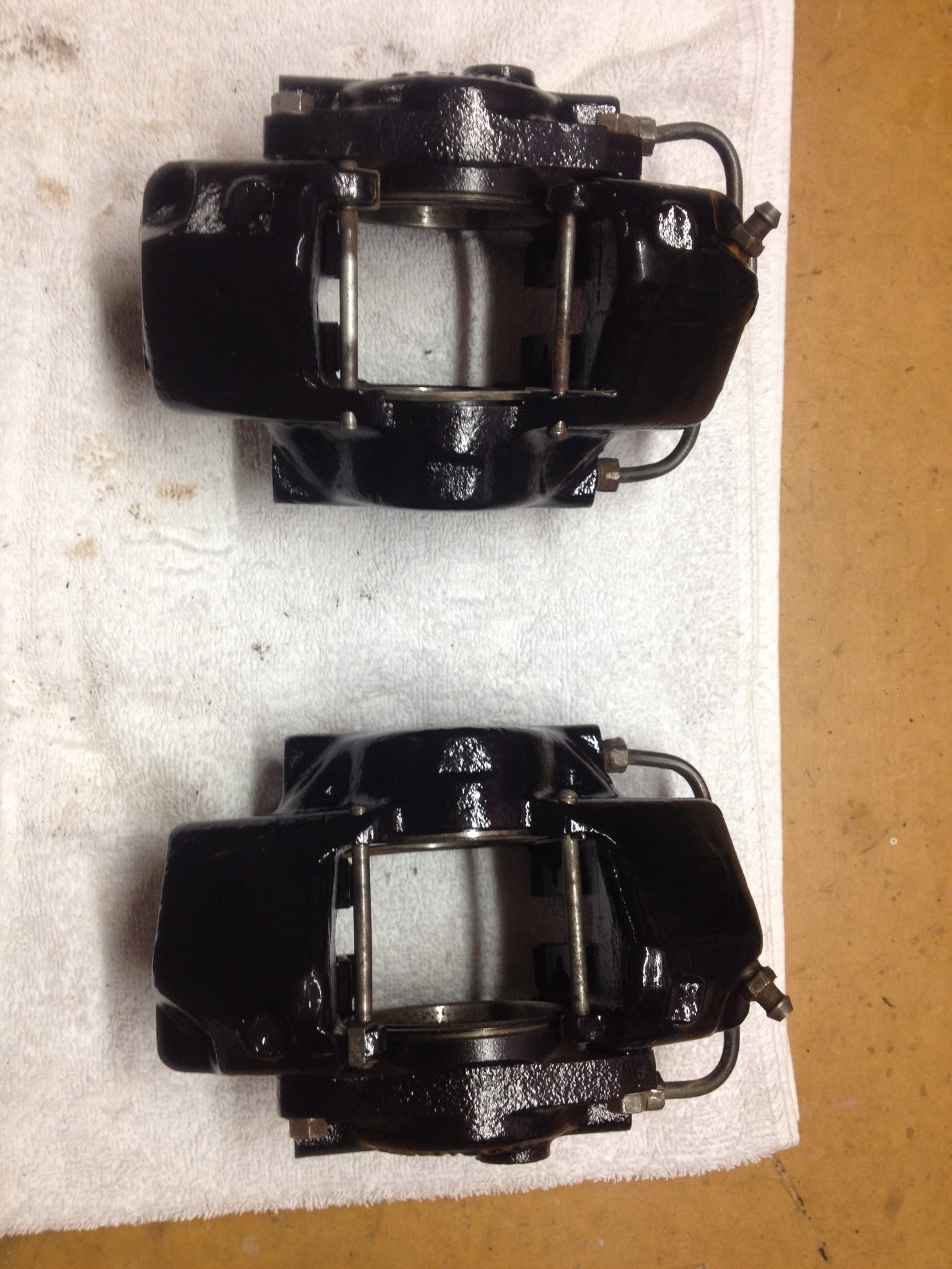

I am trying to find out what calipers are on my GT. I saw where Davo mentioned that he had fitted a front brake conversion to his GT but I am not sure if these are the conversion ones or genuine GT. The ones that I have do not have any pads and my parts book does not show pictures of Disk brakes. The car came with a photo album that shows these calipers were rebuilt but I will get them checked out as they may have rusted up since the rebuild. I think I may have found some NOS pads for a GT but I have no idea what they look like or dimensions. I would appreciate it if somebody could identify these calipers from the pictures provided and also send me a picture of some front pads. Hopefully they are GT and the pads I have found will fit. Many thanks
Peter

The pads for the GT are DB52

Thanks for that Glen, I think that is what is on the box.
Are the calipers that I posted pictures of from a GT? as they came with the car when I bought it

Yes they are GT calipers
