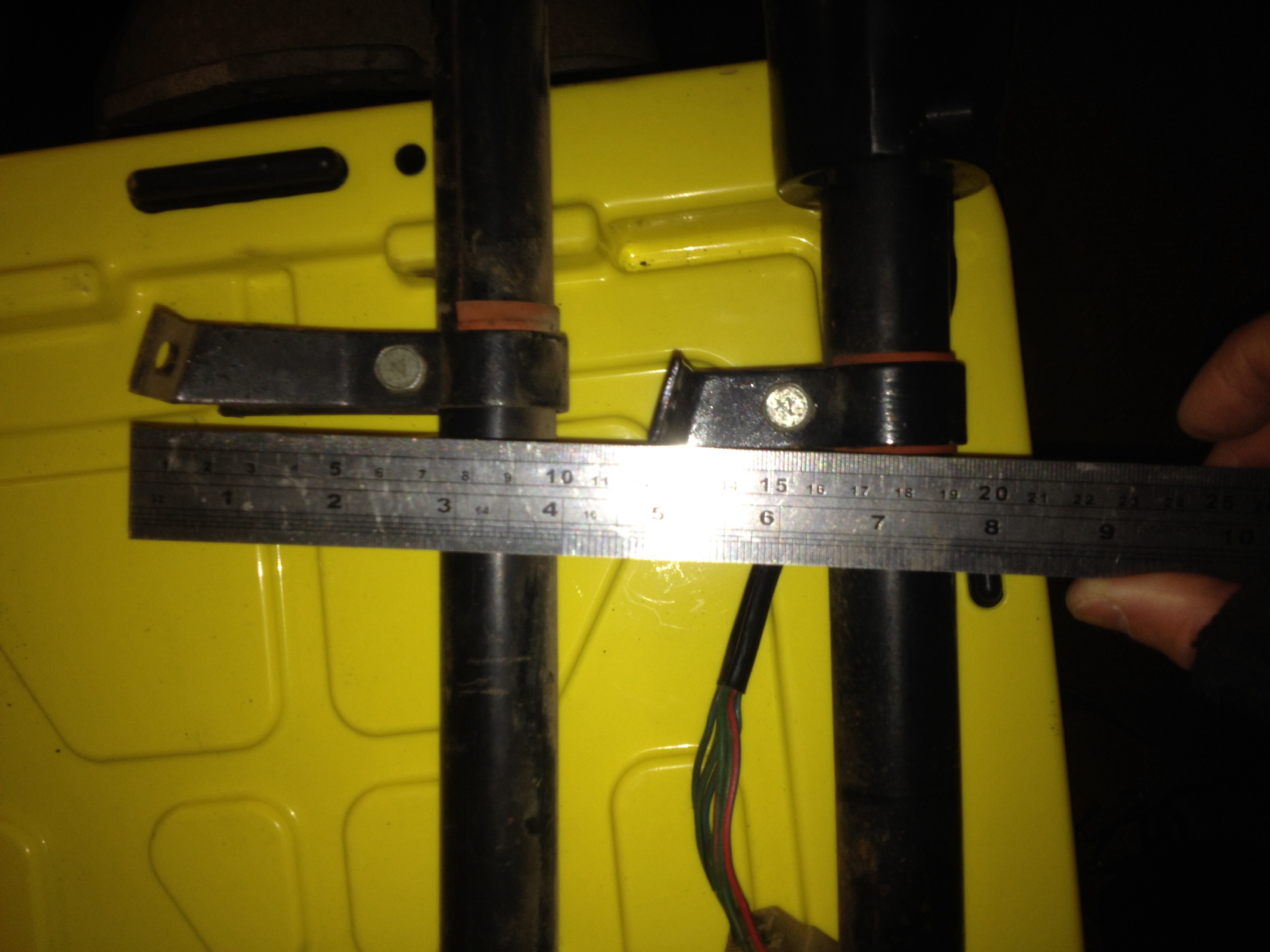

I have a steering wheel and column out of wrecked PR91 GT.
It appears to have the same inner shaft length but different outer column as per photo
The longer outer column below the mounting flange is the GT, the shorter one is out of a '68 PR20 ( from St Marys that GT Orphanage found)
When I tried to fit the GT to my 66 1/2 PR20 it wouldn't fit unless I lowered the indicator assemble but no way would the shroud fit below the wheel.
If u actually look at the GT wheel it is thicker below the actual spokes of the wheel than the standard wheel.
Can anyone please she's some light on this for me
Thanks
J

On closer inspection
I think it because the GT column mount is further down the shaft than the PR20
Bugga
J

Posts: 428
Location: Sydney NSW
Good question
This is why I put one next to the other
It appears the columns do indeed mount at different points under the dash so
'Computer says noooooo'

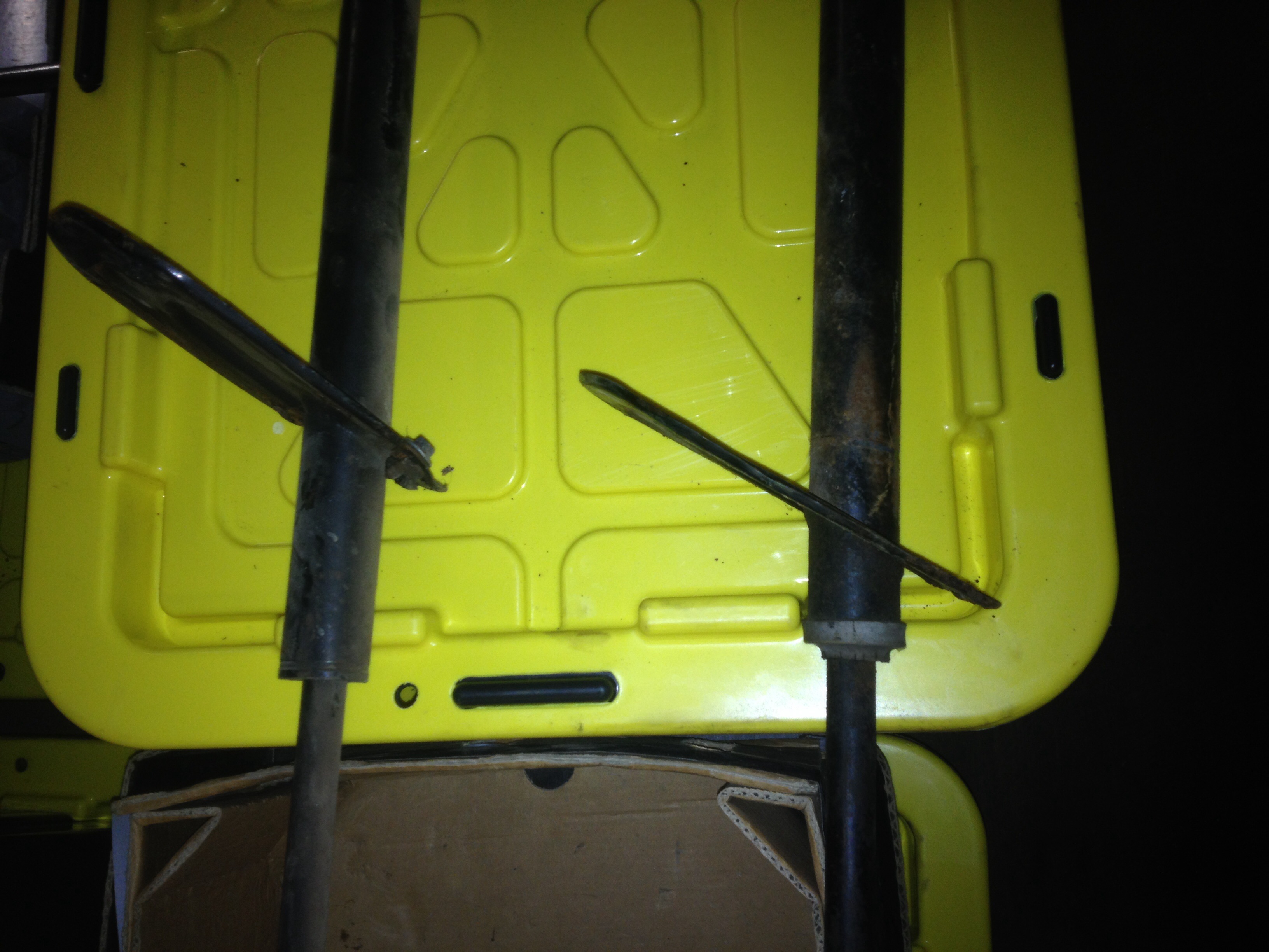

A picture tells a 1000 words
J
Fri Jun 19, 2015 11:37 pm
The GT mount is longer to set the wheel lower. This is coz the seats are lower in a GT coz the roof is lower.
The plate that mounts to the firewall is also at a different angle as well.
