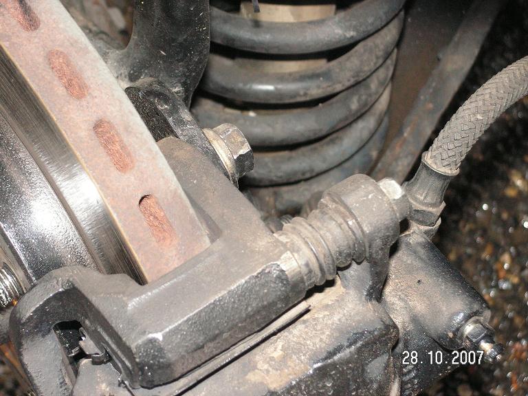

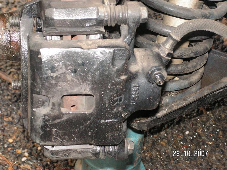

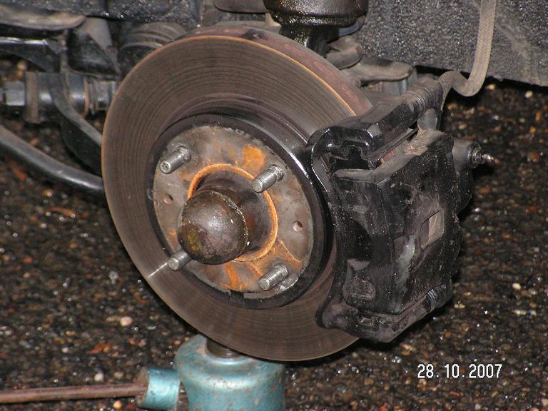

I can relate to the stub machining. I had my 1970 car turn turtle on me at Philip Island just as I was changing form second to third at 80 mph. It was a bit embarasing as I had an instructor in the passengers seat. Lucky it did not happe on the main straight as we were hitting well over 100 mph. I have GT disca on my sedan and will be going the Dubbo Way and using TP Magna. They use the standard Bellett drum hub. Just a bracket to make up for the caliper.
