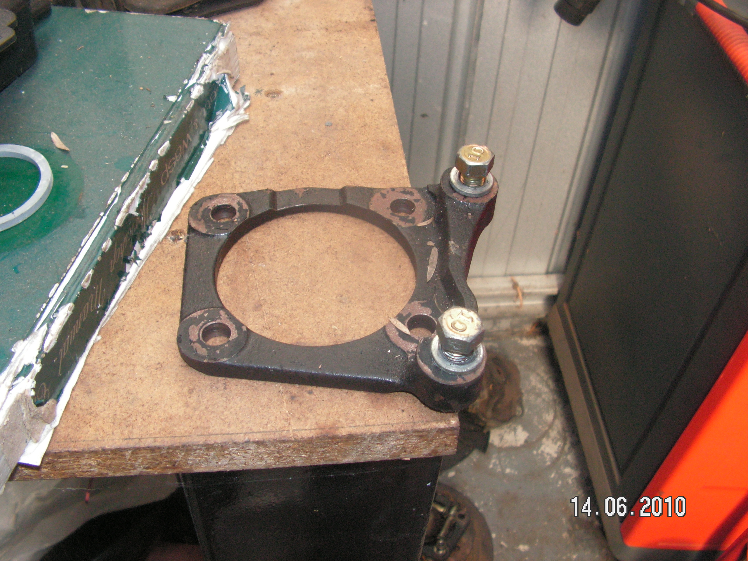

GT has a bracket that is mounted to the stub with 4 bolts. It would bee deemed to be the primary source of mounting. Therefore under Australian modification rules the use of 3 bolts minimum apply. In the intereset of safety, I would discourage the use of a 2 bolt mounting particularly for any road use.
As per piccy
Peter

Time to chisel the 40 years of caked on dirt and grime off that piece. It looked cast as one piece. Looking at the auction, the Kaemeri kit with the MK63 caliper looses the dust shield also. One more reason that I think the aftermarket calipers with the 3 1/2 inch mounting bolt spacing is a better choice.

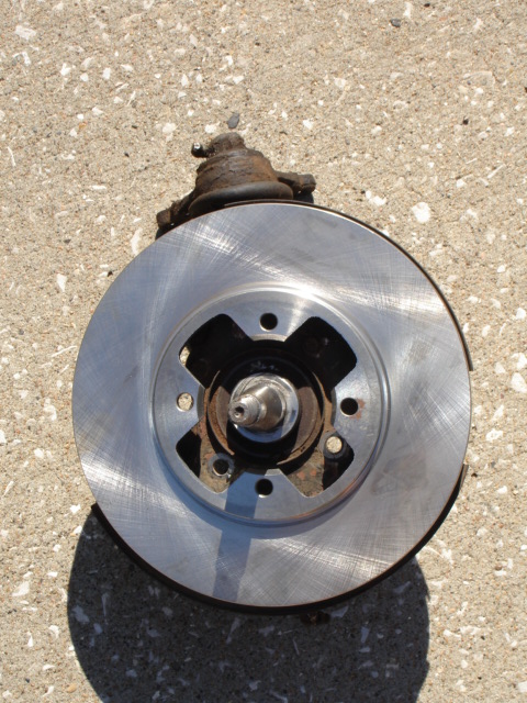

I picked up a cheap S130Z rotor to measure and have a look at, and it's a really nice design. The cross shaped open area in the rotor and the open areas in the back of the GT hub are going to provide some space to recess the adapter around above and below the mounting surfaces, and provide a lot of meat for the bolt threads to hold onto.
Also, the Nissan rotor is small enough that it fits within the original dust shield nicely.
I took a look at the Dynapro calipers. Turns out that the narrow and standard flange mount calipers have a smaller body.
Bad news: The narrow flange mount, which is 3 1/2 inch from center to center on the bolts (the same as the Bellett GT), are 1.7 millimeter too long to fit the disk. The brake pads would hang over the edge of the disk, which is a bad thing. Slotting out holes on a brake caliper is not something I am going to get involved in.. So that one is a no-go.
More bad news: The radial mount body is bigger, and would require trimming the dust shield to fit. It is more expensive anyway.
Good news: It looks like the standard flange mount, which is has the mounting bolts spaced at 5.25 inches and shallower to the body of the caliper, will not require any trimming of the dust shield, and the bolt holes are far enough away from the mounting holes in the spindle to provide for a nice, beefy bracket to hold the caliper to the spindle.
Wed Jun 30, 2010 4:36 pm
Posts: 543
I've been slowly working out the details in my mind on these two projects.
Ironically, the caliper mounting for the larger S130 rotors is going to be simpler. I wanted to use a larger body caliper that mounts easily, but the body won't clear the dust shield, and I do not want to put something together that requires cutting the car. So I opted for a smaller body that uses the same huge pad.
Good news, no bracket. Bad news, the caliper must be modified to move the mounting hole position, so the caliper is not an off-the-shelf item.
I need to have a set of rotor hats made to play with this one any more.
The smaller caliper to go onto the stock rotor is going to be more of a pain. It is going to require having the caliper in hand before designing the aluminum mounting bracket. The manufacturer's drawings lack a little accuracy. But because it requires a mounting bracket, and fits the stock reproduction rotor, it would be cheaper to go with the larger S130 rotor with the modified but bracketless caliper mentioned above.
