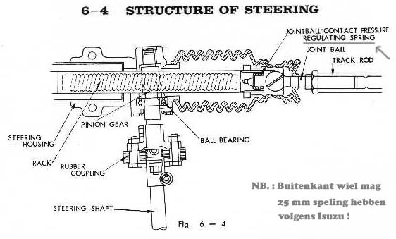

Just starting to get my car ready for its roadworthy test here in the uk (MOT). While replacing the steering rack boots i noticed 2or 3 mm of play in the ball / socket of the rack when grabbing the drum and pulling/pushing it. It looks like there might be adjustment in the rack ? It has what looks like a big locknut with the end of the rack having two flat faces for a big spanner to fit. Also small black screw on rack top which i have loosened.....is it a case of loosening big locknut and rotating rack end until play has gone then tightening everything up again or is the rack just knakkered ?

I saw on the bellett net you were worried about your steering rack; the ball joint inside is spring loaded! So yes there should be play in it. First time I bought a Bellett I thought the same as you; this is wrong, but no it's like it should be.
You may have 25 mm of play at the outside wheel according to Isuzu. See the scan of the rack I enclosed.

Hey guys, many thanks for all the advice particularly the diagram of the steering rack.
Am however a little amazed at the 25mm tolerance at wheel rim alowed by isuzu. Not disputing the diagram, but here in the uk at least, you would fail your MOT (warrenty of fitness) i there was ANY play in your steering in the 'straight on' position - you are allowed some play on 'full lock' however. Plus, surely with that amount of slop you would get vibration/rattling through the steering on rough ground not to mention vague steering........

The chassis book of the bellett says clearly that there can be 25 mm at the pherifery of the tire. This is caused by the spring loaded ball joint. If you pull the wheel horizontally you feel the play caused by the spring (nobody is doing that during driving .. !); the wheel returns to the original position if you let the wheel go. The meaning of this all is to avoid road bumps etc in the steering wheel. A MOT technician will know the difference between wear in a ball joint and a spring loaded one; never had problems with our Dutch MOT. There are lots of other cars that have the same principal; Mini for instance and the steering on Mini too is sharp as a knife. Taking the spring out and shimming up takes comfort out of the car and can be dangerous as the joint should be able to fully follow the travel of the suspension parts on bumpy roads.

Have been speaking to an actual MOT tester here in the uk, and from what he has said along with dicks advice and diagram, it seems (amazingly!?) that you should have indeed slack in the steering rack. A lot of early japanese stuff apparently had a similar system rather than having the horizontal shock absorber type steering dampner (eg vw beetle).
The problem arises when the MOT tester hasn't tested old cars much and is not aware of the isuzu and others sprung loaded rack type steering dampner. This is especially true when there is a bit more slack in one side ethan the other.
Conclusion then, is that slack in rack is meant to be there, just make sure you get an old school guy to test your car.

It seems as they all have the cup, spring and ball thing. If you adjust the slack up by adjusting the big nut you can only do this in 180 degree amounts otherwise the track rod cannot go the full suspention travel which is dangerous. Have you tried adjusting it back so there is slack? You may find the steering is smoother over rough ground, also if theres no slack my guess is things will wear out pretty fast......
