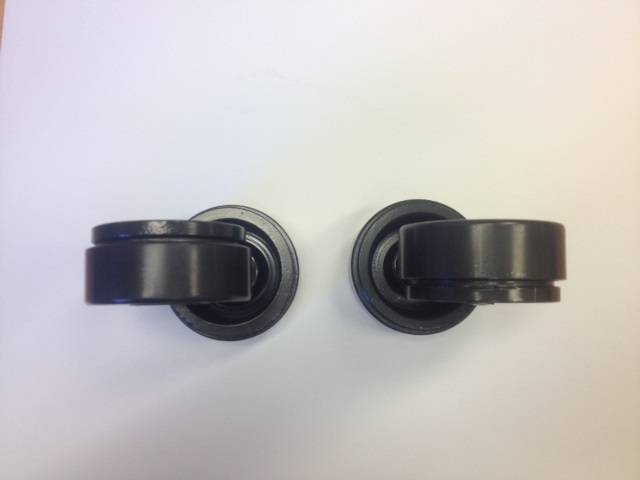

Just picked up the pistons from the Ceramic Coaters
3 are definitely useable, 4th touch and go as likely to 'seep' which may be OK on weekend driver but not daily driver so I will give it a go.......
Interim step to Sleeving if pitting minimal at about 1/3 cost........
J
