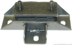

Chevy Luvs start with 1972, maybe later than the KB design.
This is only allowing one image attachment per post.
This is the Luv transmission mount.
File comment: LUV Transmission Mount

Brett, your idea I will try, I had not thought of the KB ute mounts. Surely the gear box mounts would be different due to the ute having a 5 speed box?
If the engine mounts from the KB ute fitted your Wasp, they should surely fit the Bellett, or you would think so?
I don't remember seeing the gear box mount so JT191 I am not sure if that would fit or not, do have any idea there Brett?

Those engine mounts posted by JT are the ones I used on the Wasp.
Looking at them now, they are slightly different to a Bellett one, but nothing a small trim and a new mounting hole can't fix.
In that pic, the "loop" of steel and the "tab" under it aren't on a Bellett mount, so they could be removed. Also, from memory, the holes in the Luv mount were too wide for a Bellett. The hole at the foreground of the pic will line up, but the other hole doesn't, requiring a new hole to be drilled and the extra steel on the plate to be removed as well.
The gearbox mount looks very, very Bellett. The only difference I can see is that a Bellett doesn't have the extra "tab" that is on that mount in the foreground of that pic. Again, a quick removal is in order.
Dave, as for the 5 speed question... They actually mount the same. My Wasp has a DOHC 5 speed and uses a Bellett box mount on the Wasp chassis, and my race sedan has a Gemini 5 speed and uses a Bellett mount as well. Mr Isuzu kindly made the later box's so that a Bellett mount would bolt straight to a DOHC/Gemini box, even though the DOHC/Gemini mount looks totally different to the Bellett one.
Hope this helps mate!
Also, while I'm working from memory here, please just check the mounts and dimensions if you're going to spend money on them, as I'd hate to think money has been wasted if they don't work out.
Let me know how you get on.
Cheers.
Brett.
