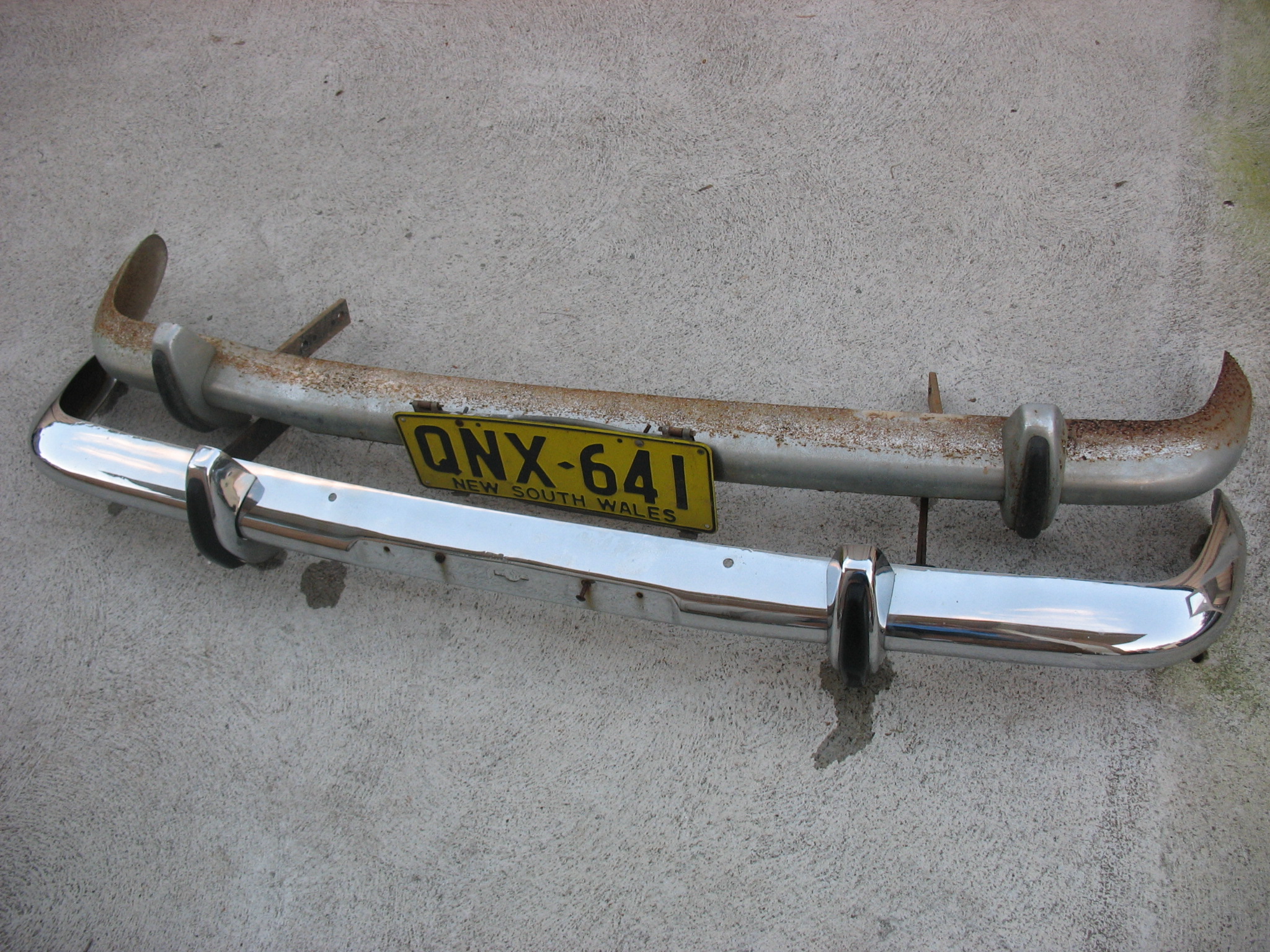

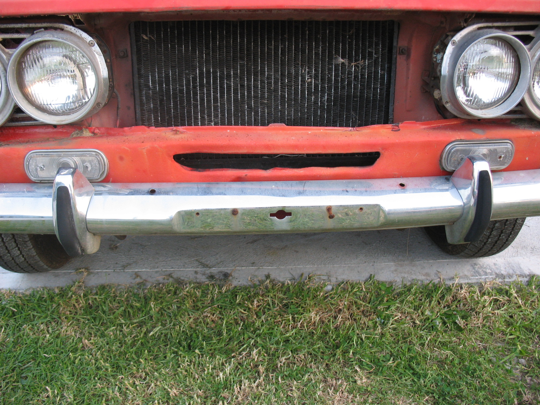

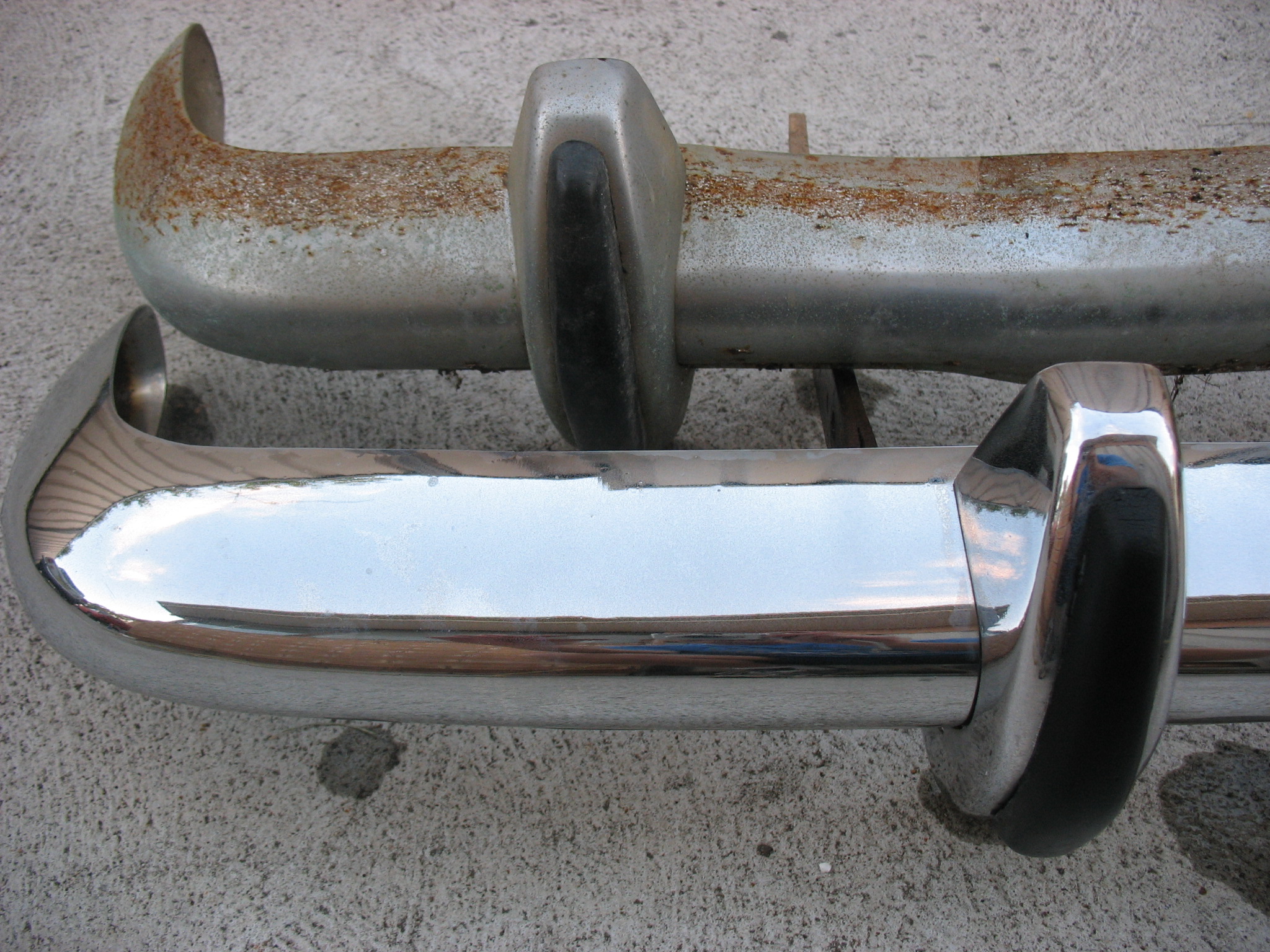

Here's the pics of 2 bumpers side by side. My rusty one ,and the other with the over riders blocking the blinkers,shown on the car
Hopefully also they are not upside down ?

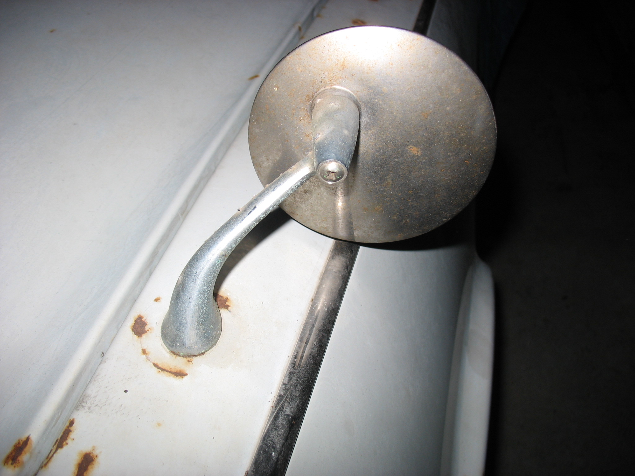

Also a pic of the mirror I asked about ( in wanted section). I think Davo said it might be a rare :( Deluxe type ?

Mon May 21, 2012 11:44 am
geez thats a curly one the old bumper is the same as the ebay one checking the distance from the crank handle hole ..the newer looking bumper and yet with a crank hole and so different spacing come on farmer you have a few of these ...solve the mistery and what about the mirror ? cheers davo
Mon May 21, 2012 12:03 pm
Looks like the overiders have been relocated, is there any evidence that that the old holes have been filled and then rechromed?
The only Bellett that has indicators and park light in different position was the GT and the real late Belletts. :?
Mon May 21, 2012 12:11 pm
reckon your right geoff ...maybee the owner got a set of gt foglights abd thought geez they wont fit in here so re position the overiders to let the spottys fit and fill the old holes and rechrome ????????????????? cheers davo
Mon May 21, 2012 9:15 pm
On my '65 Teardrop the front over riders are 1020 mm. apart. On my '67 Deluxe sedan the front over riders are 740 mm. apart. Both cars are original. Hope this helps.
Mon May 21, 2012 10:39 pm
Those measurements are to the centres of the over riders....
Mon May 21, 2012 10:43 pm
in case you want to re-chrome.... Huntingdale Platers told me $350-$450 depending on condition.
Tue May 22, 2012 12:13 am
gentlemen the early cars had different bumpers and overriders to the later cars.
early ones have the parker/indicator nearer the centre of the car with the long skinny overriders outside of them while late cars have this reversed with the flat and squarer overriders.
added to this is differences in the rear bar being either 1 piece or 3 piece, and again the GT bars are different to them all.
also the early and late overriders IN SOME CASES aren't interchangeable as the bolt location was either rite at the front or on the top face of the bar...
basically, check check and check again with these things, front AND rear.
Tue May 22, 2012 2:31 am
of course this means the front stone tray is then different between early and late sedans as the light mount holes are moved... and GT ones are of course different again...

The Teardrop is a '65 model ,and I have a later model '67 Bellett too (square tail lights) and have done all the measurements on both model bumpers (rusty original one,and '67 one with short wider overiders) - I got same measurements as KJB did .
There are no welded up holes in the good Teardrop bumper I want to use,but there are 2 holes behind where the overider bolts up (one above the other) Only one hole has been used.
My guess now is that a later model Bellett bumper has been used,with the early Teardrop overiders fitted ,as the spacing is almost the same as my '67,only 10mm difference.I guess the original hole would have been in the wrong spot,so another drilled above or below it ? only problem of course is they block the blinkers!
Maybe I am better off with the later overiders that sit a lot lower & should clear the blinkers,or no over riders ,and holes everywhere.
Davo, I also checked behind the number plate on my '67,and can feel the crank handle slot in the bumper ,same as the Teardrop.
Thanks for all the advice - i didn't even realises the early & later Belletts blinkers were in a different spot until I read PR91's reply.
Much to learn :)
