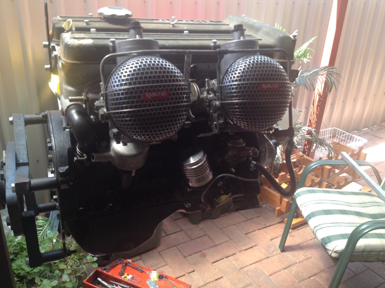

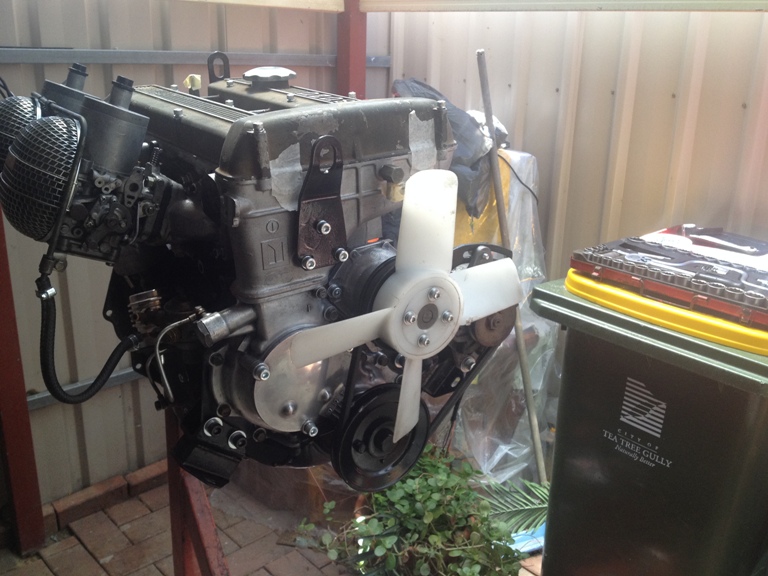

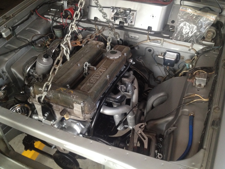

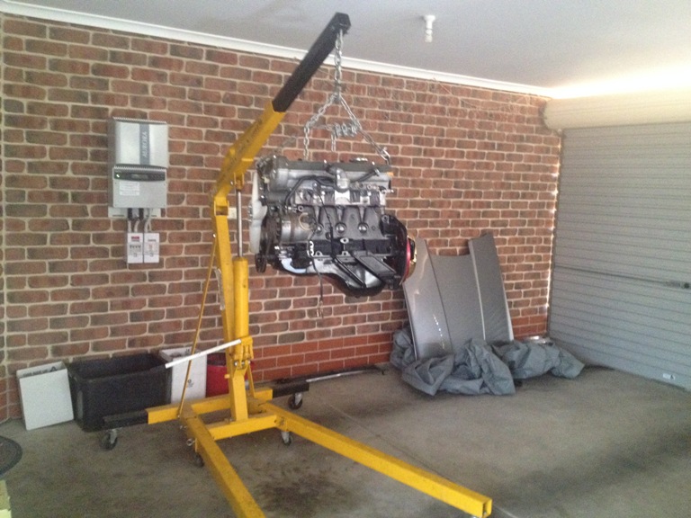

I has been ages but now I have the urge to get my car back on the road for the Summer Cruising Season.
The motor had blown the Head Gasket which started the pull down.
Got the motor machined, balanced, ported, polished.
Here's some pics

Hope it's not going in the recycle bin pick 3 :shock: :shock: :shock: :shock:
Sat Dec 12, 2015 10:06 pm
Posts: 259
Car(s): 1967 GT Bellett
The Joys of trying to work out of a carport.
