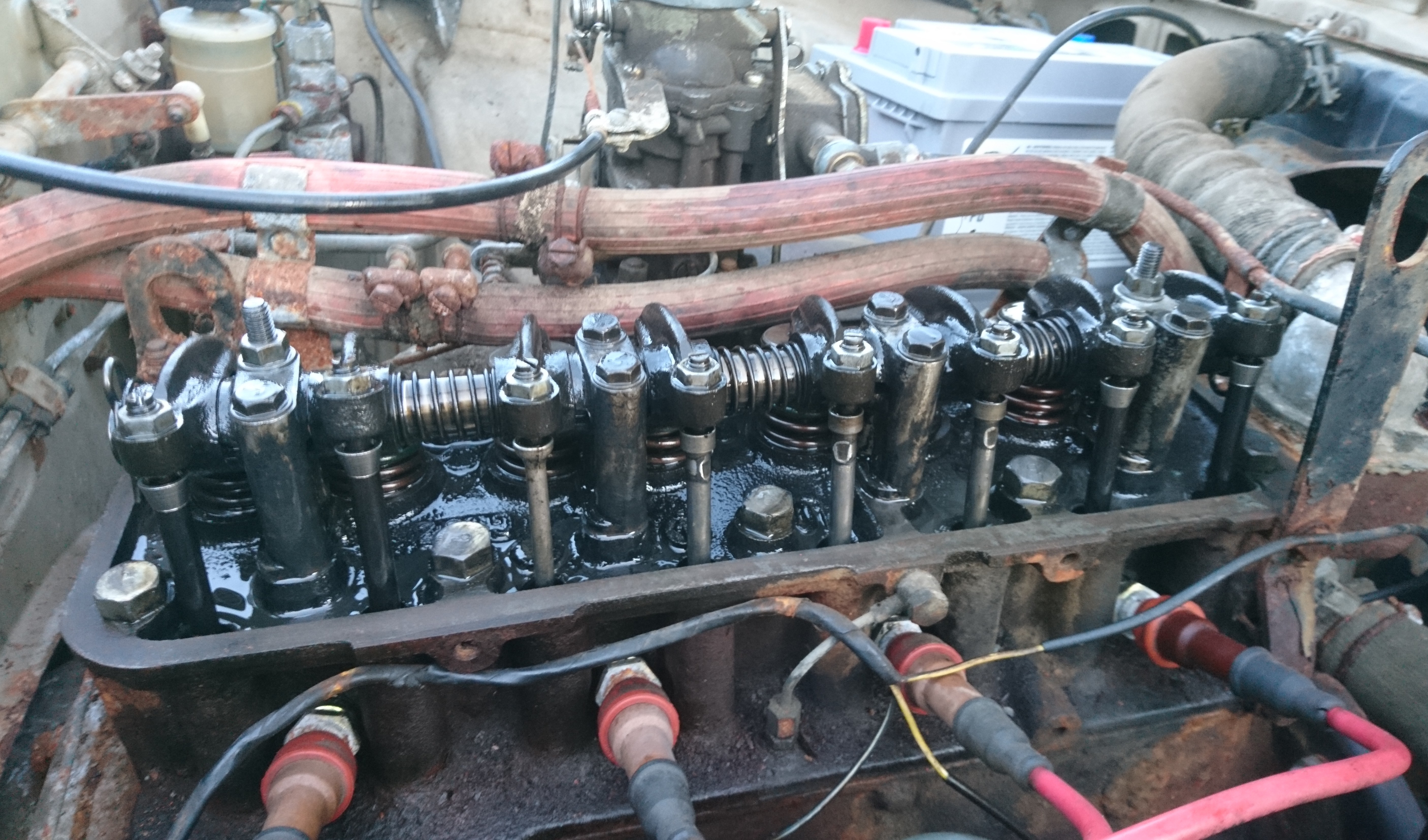

3a. Oil pump works (oil is getting up to the valvetrain)

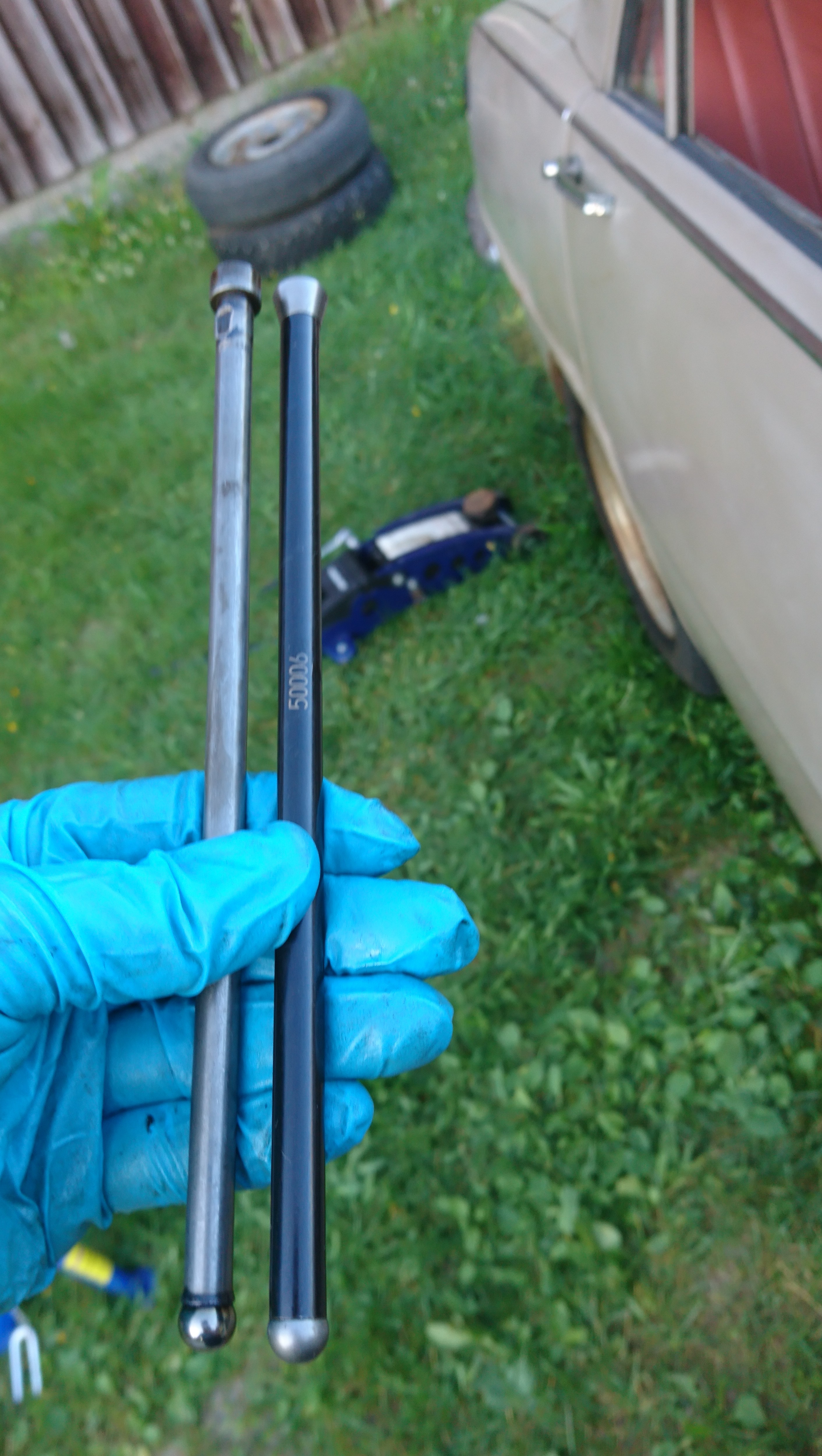

3b. Discovered that I need to replace atleast 2 pushrods.
3c. Checked that all the valves move freely.

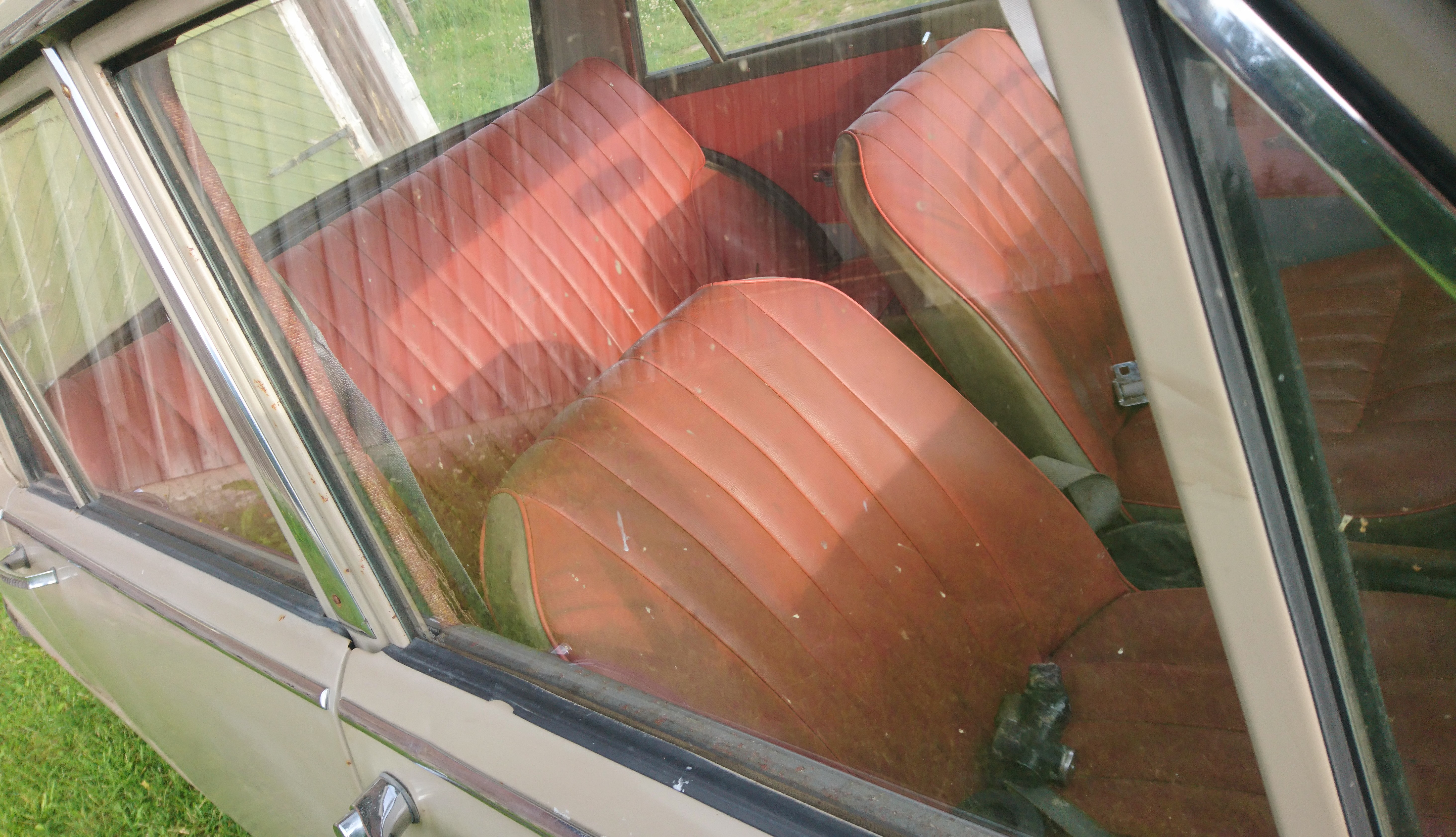

11. All the doors and windows open and close really nice, almost like new.
12. The rust situation is so far really good, might even pass the "far away in the future" inspection without any welding.

Finally got my custom length pushrods that I ordered! fits perfectly and doesn't rub anywhere, nice! 8-) had to use some "Tecnosil" black sealant on the very very old, crispy and broken valve cover gasket since I didn't have a new one laying around :D

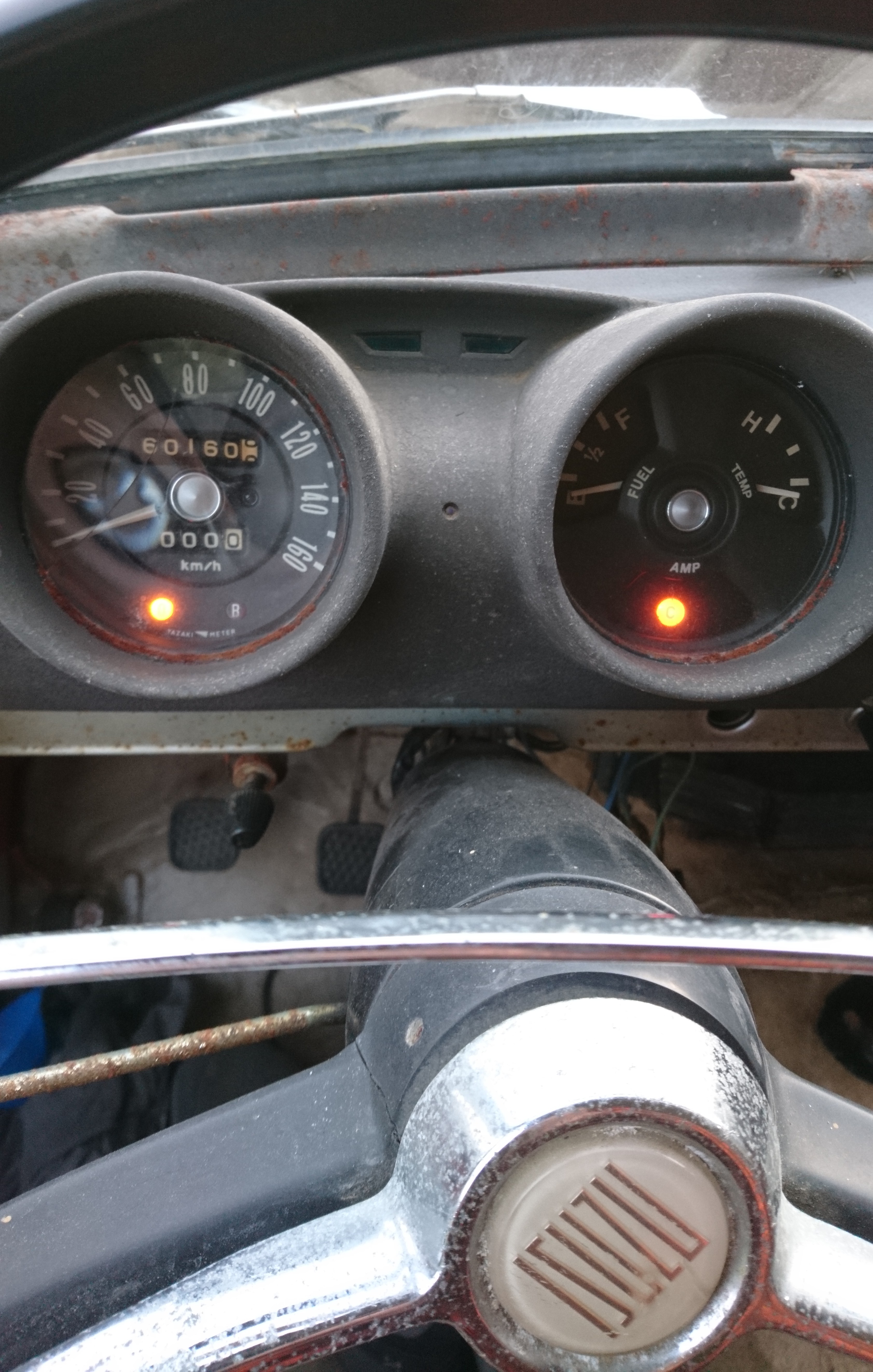

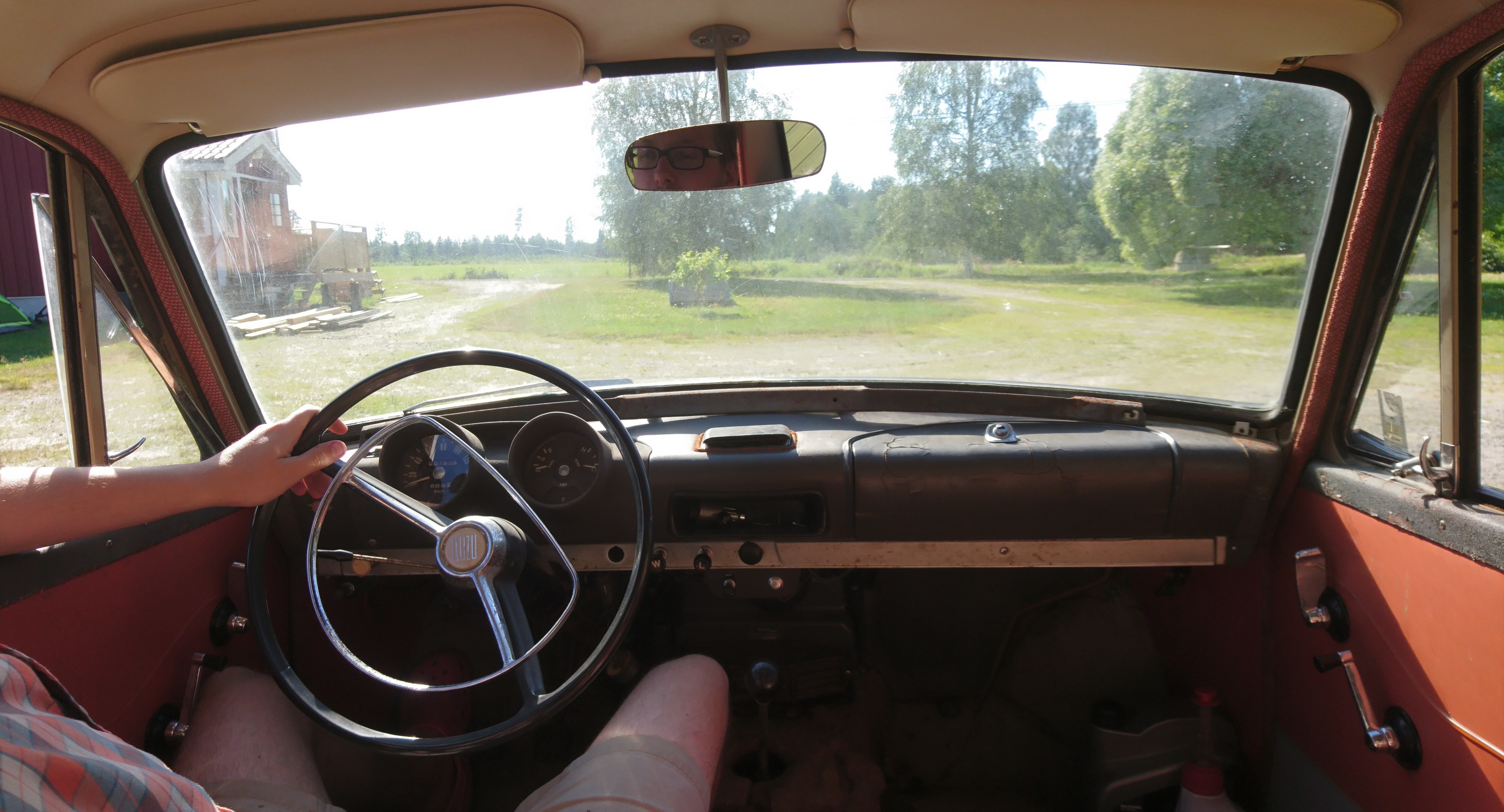

Did also get most of the interior electrics working, gauges, lights, warning lights and switches.
Annnnd... Got the motor running aswell! Sounds awsome with a straight pipe :D until the carb bowl runs dry... since I haven't rigged up a fuel system yet :roll:
