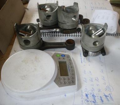

Piston-gudgeon -rod assemblies are all weighted to 1 g. Two at 1137g and two at 1136g. Piston weights varied from 337 g to 345 g which required some "fettling". Other variables were in big end caps and 1 g variation in gudgeons.

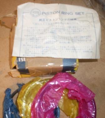

Piston rings came complete with instructions - Perhaps one of our Japanese friends who visit the site can help?

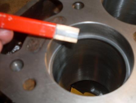

End gaps checked out beautifully -13 thou for no 1 ring and 10 thou for number 2 without any filing required. The hi tech depth gauge for locating them squarely in the bores took ages to manufacture!!

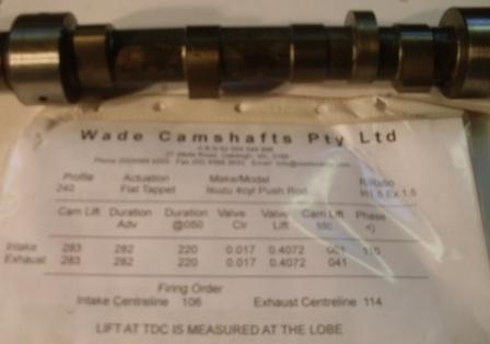

The guys at Wade Cams are very helpful. This one’s profile is designed more for massive (?) torque from 35000 rpm upwards rather than for brute HP/speed. Of course they’re good – they originated in Tassie many years ago (but are not related!!).
