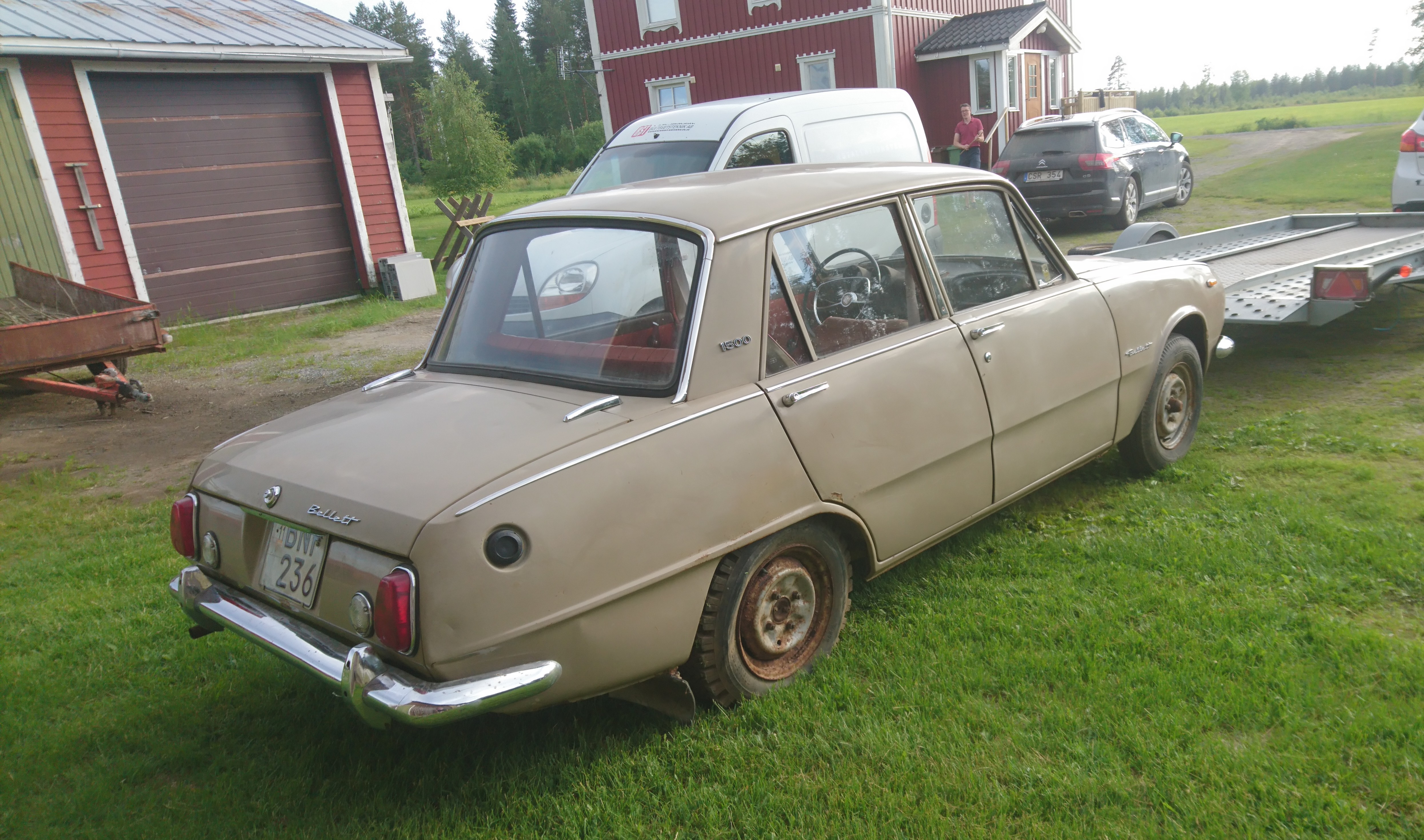

All the pics are taken at my brothers place where I "dumped" it for now since I'm spending my vacation there and since it was kind of far to drive it all the way home to Kiruna (~900km north from where we picked it up and ~200km above the arctic circle  ) Yea some cleaning is necessary  Things done/checked so far: 1. Engine turns freely. 2. Starter and starter relay works. 3a. Oil pump works (oil is getting up to the valvetrain) 3b. Discovered that I need to replace atleast 2 pushrods. 3c. Checked that all the valves move freely. 4. Most of the lights work, blinker relay is missing though.. 5. Ignition stuff cleaned and gets spark all the way to the plugs. 6. Carb holds fuel and looks to be complete, valves and float moves freely. 7. Tires that aren't from the seventies and is about to pop at any second is now on so I can move it easily. 8. I have no keys but someone already took apart the ignition switch so I can turn it and bump the starter without keys. 9. Emptied the ancient engine oil and cleaned the filter housing from debris and well.. a lot of mud.. and put a new filter in. 10. Changed the cut in half/broken oil pressure switch with a new one. 11. All the doors and windows open and close really nice, almost like new. 12. The rust situation is so far really good, might even pass the "far away in the future" inspection without any welding. 13. Ordered a few pushrods so I might here it roar before I leave it for a week of watching "Streetweek" dragracing with friends from the passenger seat of a turboed 1958 Chevy Impala

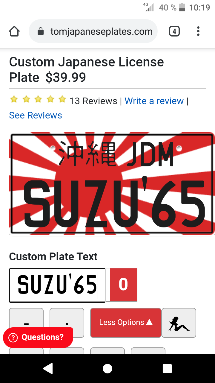

More pics. Finally got my custom length pushrods that I ordered! fits perfectly and doesn't rub anywhere, nice!  had to use some "Tecnosil" black sealant on the very very old, crispy and broken valve cover gasket since I didn't have a new one laying around  Did also get most of the interior electrics working, gauges, lights, warning lights and switches. Annnnd... Got the motor running aswell! Sounds awsome with a straight pipe  until the carb bowl runs dry... since I haven't rigged up a fuel system yet  Maybe it needs some nice new reg.plates someday  If anyone wants to hear the engine then search for 'eliazzon' or 'isuzubellett' on instagram.
