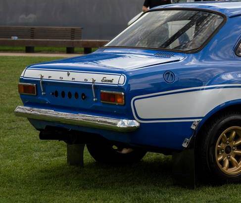

Its easy enough to weld up the holes, a suggestion might be to fit something like the early Ford Escort tail lights. Similar shape and pretty flat. Probably easier to find if you don't turn up Bellett ones..

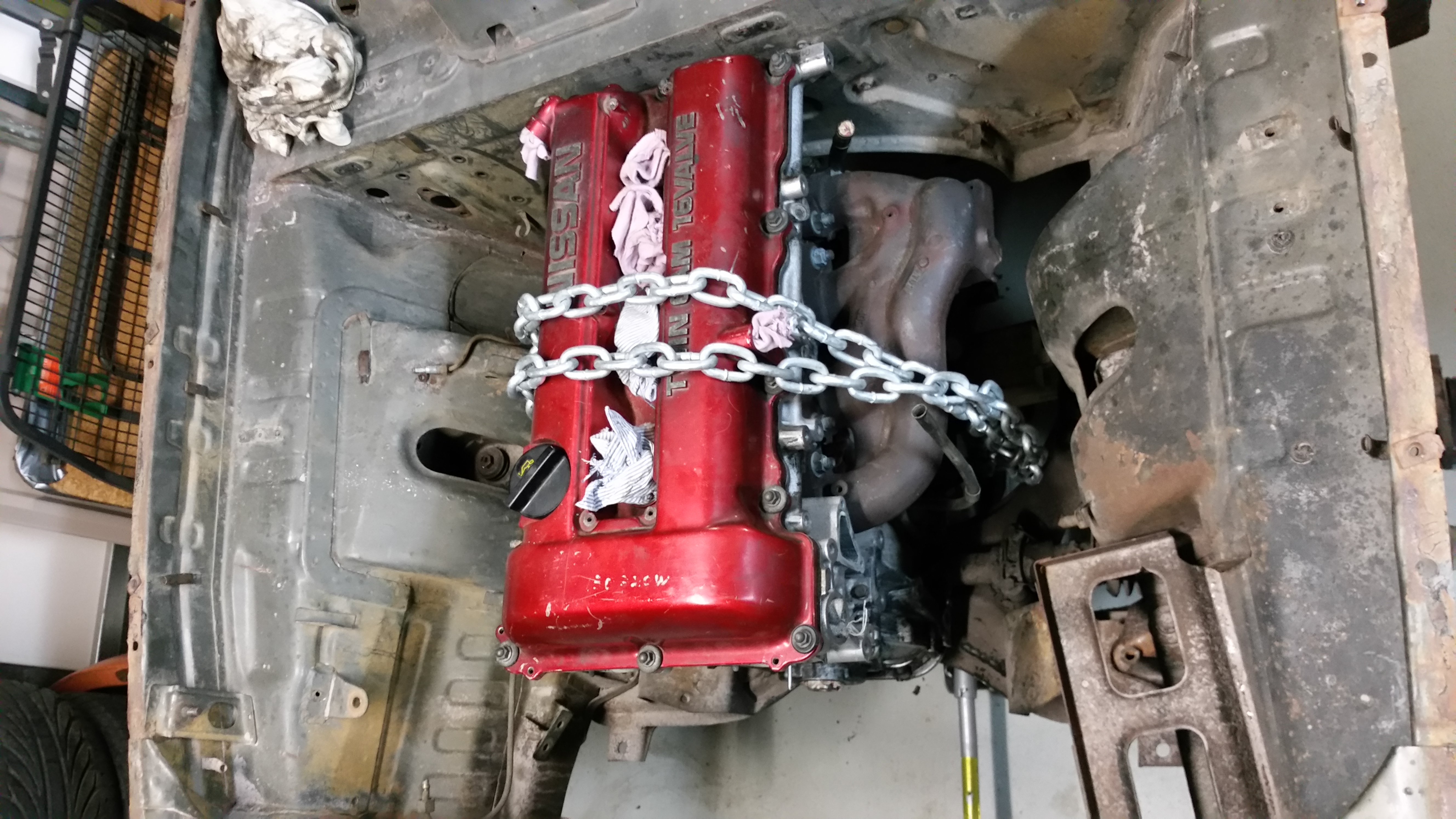

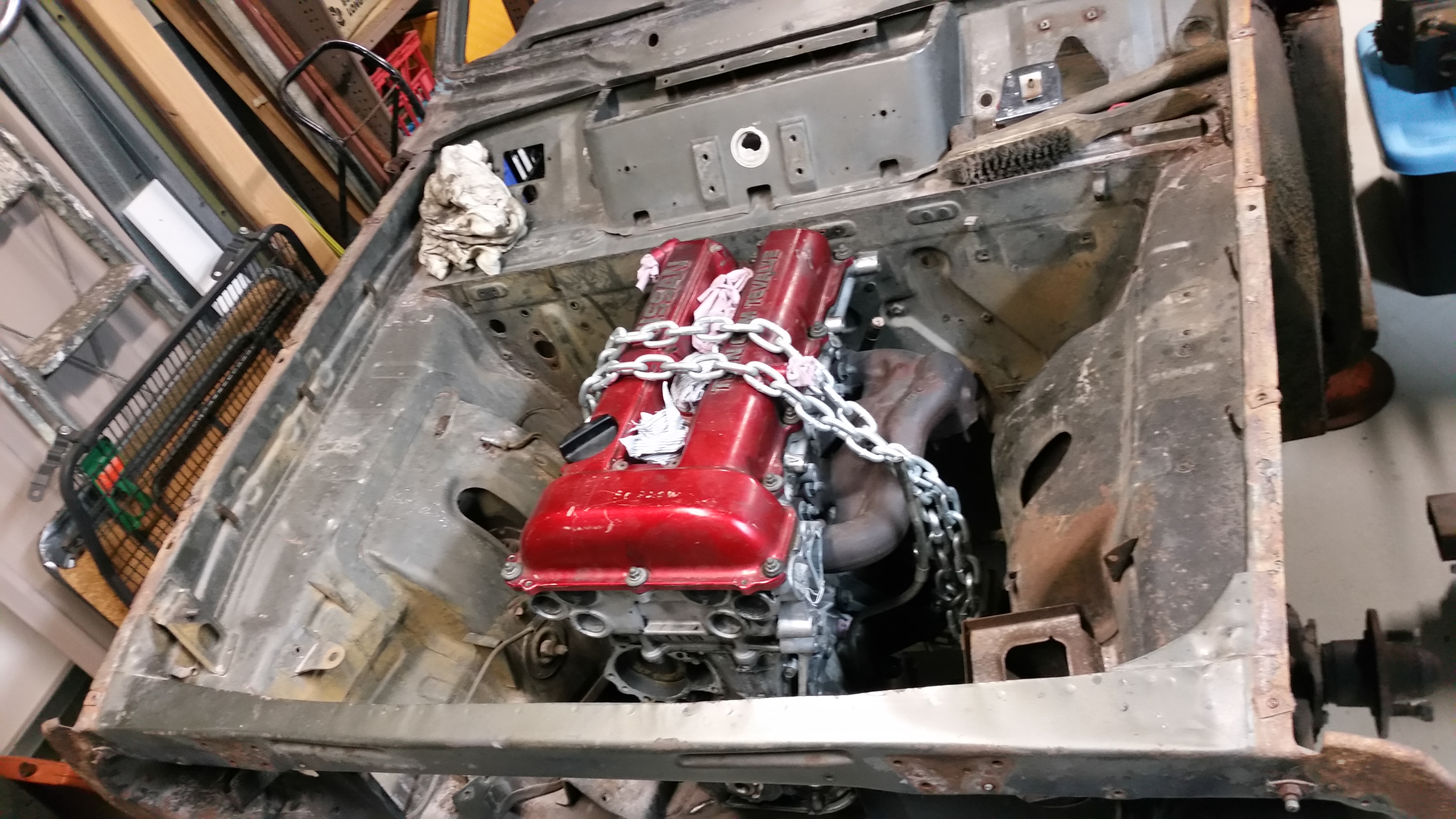

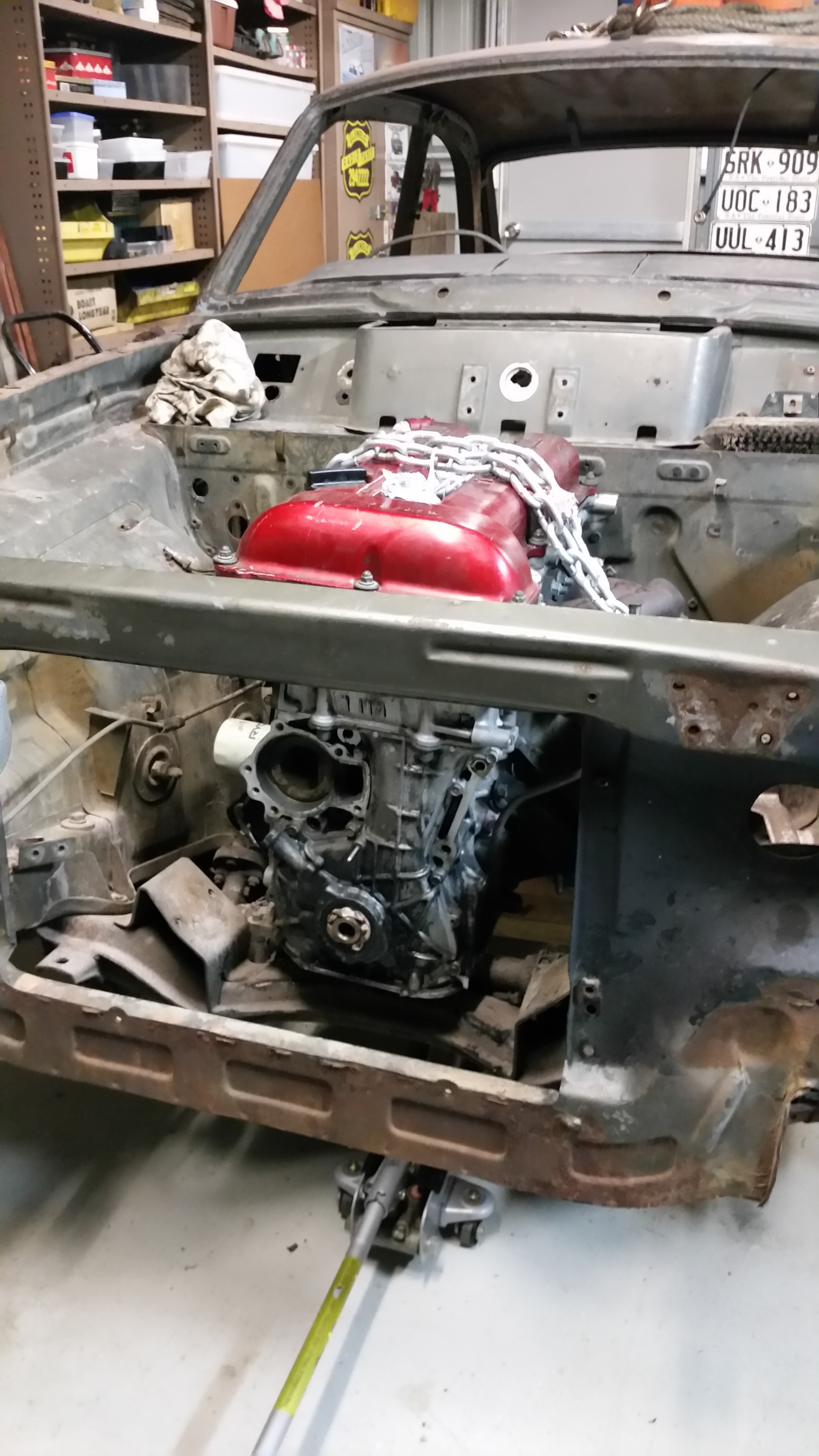

Been working hard on the GT pulling her to pieces and going through everything. Bloody bolts, screws only broke a couple but got the doors off without damaging the screws.
I finally trial fitted the SR20DET today with no oil pan to see how she would fit, so far so good I need to trial fit the bonnet next to check clearance and fit the gearbox and see where the additional work is needed to modify the trans tunnel as the SR Box is a lot longer than a Bellett gearbox.
It needs to come forward about 20mm and it is sitting on the steering rack right now but will play with it a bit and get the engine mounts sorted and then try and make a new oil pan to suit and hopefully it clears the bonnet.
I think a top mount turbo and forward facing plenum/throttle body and hopefully not have to modify the shock towers to much if at all, but we will see how that goes.
I would like some advice on strengthening the rear end to handle the horse power without having to go for a shortened S13 rear end which will widen the track 50mm and try and go for a stock look or flares with dished rims, added a pick let me know what you think.

The Isuzu Twin Cams look bigger in the head, I don't think you will have any problems with bonnet clearance.
The Isuzu sumps are thin at the front, have a scallop over the rack. and drop down over the back.
Looks god keep up the good work
