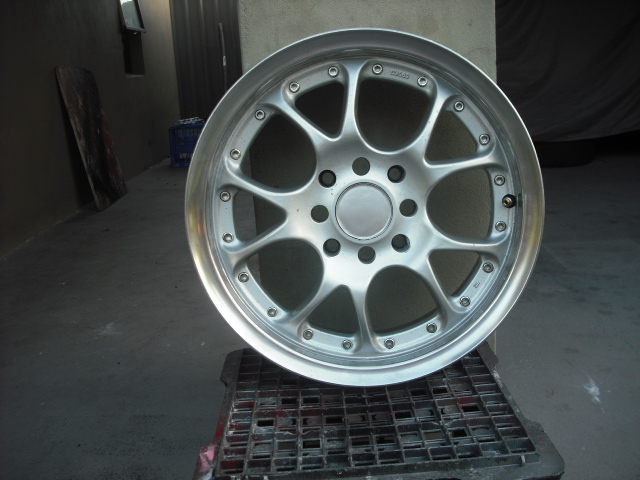

the new mags for the car didn't have a set of advanti caps ...so like the variation is hundreds the clip ons ..so this is the second $10 set the others were too small so I went for bigger to reduce the size and with a bit of adjustment about 2 hrs cutting back the tags and reducing the circumference of the cap ...viola... next a set of Isuzu stickers ..mate its great this is wheelie week .....at my place .. cheers davo oh these are 15'' advanti wheels tyres will be 175or 185/55/15 with bullet head mag nuts all good davo

We can tell Davo, you "wheelie" are having a good time! :lol:

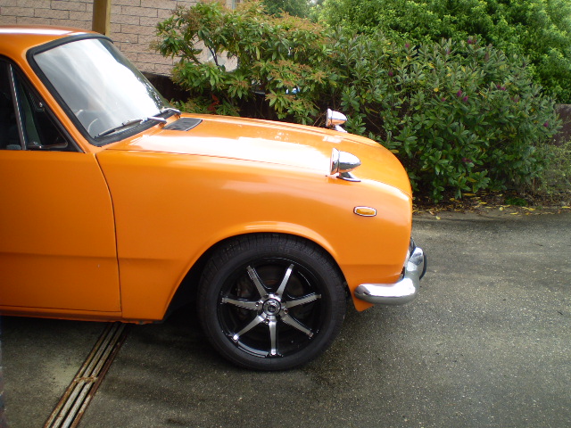

Hi Davie
I have a set of Advanti's on Asroc
15 x 6.5 mags
Running Pirellis, 195x50x15
Snug fit so ran a small spacer in the rear
Sweet
J

Hi Davo,
Best fit would be 195/50r15 so long as you have the right offset wheel. Not sure about Qld (or Tassie), but the spacers that Asroc runs are illegal in NSW.
