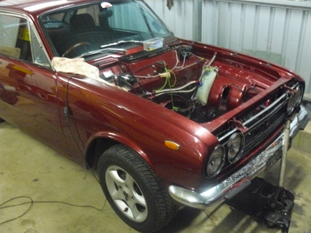

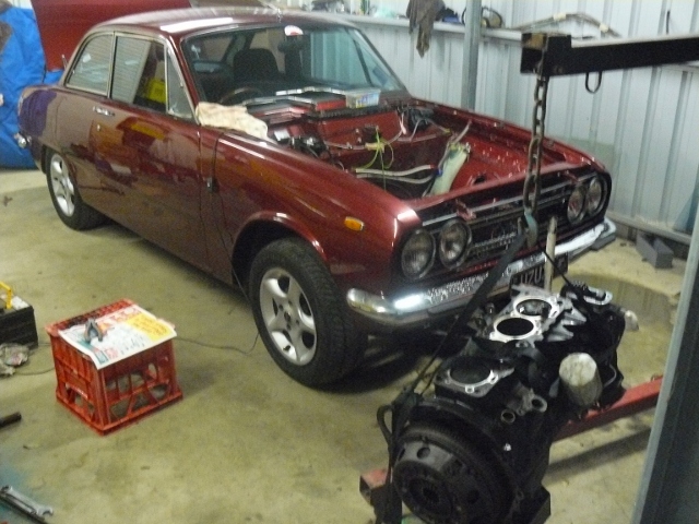

Missy has fronted to the operating table :? The twin cam in this car i bought in 1989 and the car sat for 18 years mid restoration while life and finances got in the road :evil:. The issue here is the engine was never a healthy one but the more i drove it the more it proved me wrong :P. with a few interstate trips nationals,nrma motorfest and a couple of interstate club trips :!: she returned home last sunday on three cyl's. I didn't bother working out why it's time to bite the bullet and give it a freshen up i.e rings, bearings head work, new timing chains ect. I have had a set of manifolds made to take webers so the gt carbs will make there way to another small project ;) more about this at a later date ;) While the engine is out i hope to respray the engine bay and repair stone chips to the bonnet and lh guard re chrome the cam cover and tidy up a few things.
Missy is wanting to keep up with rufus [Lewis's car] :lol:

Keep those great pics coming in there Greg. She will keep up with the best of them once your finished.
Tue Jun 26, 2012 11:43 am
:) Not to mention hooning around Lakeside and who knows where else,sure that motor has seen the red line more than once ;)

another project..... looking forward to this, Greg
any signs of the problems now you have the head off ?

This is only a small project :) it was a huge one back in the late 80's.

She needs more than a hone :( looks like the blocks on holiday's too.
Wed Jun 27, 2012 5:55 am
Mmm, not so good Greg,

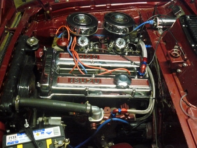

well the engine is back in the car and i had it running yesterday,it was in a bad state with the block needing sleeving and a few valves replaced with new modified toyota valves before she fired to life again. I fitted a pair of webers to it this time and had to move the brake junction to the fire wall to fit the air cleaners so a brake bleed today a few little tidy ups and a bonnet and i will have three gt,s on the road :D this day only took 22 years to acheive :lol: Nah im happy with that to be honest i thought ol yella was only a one day dream. The cam covers and a few bits are due back from being rechromed so it looks a little ugly with the odd bit's on her.
Liz has put her foot down now i have to do Warwick next but i will be side tracked a little with Bruce the first chance i get as i cant see myself driving a bellett auto i plan to fit a gt head twin carbs from missy and a gt gearbox and gt cluster gauges and console and fully rego this one and reduce missy to club rego. I need 1 car with full rego in case i get a urge to go for a drive ;)
qld club rego we can only drive on club trips or 15kms from home so i keep 1 fully regoed.
