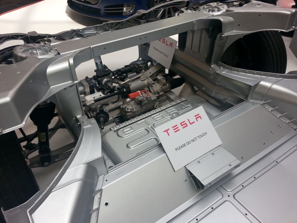

Most of you car nuts know of the Tesla and especially the type "S" model. 0-100kph in 3.2 secs etc. 3000 battery cells (reputed to be from a Laptop PC) with a range of 460km. 7 hr recharge. 4 wheel drive too.

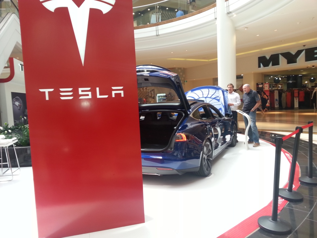

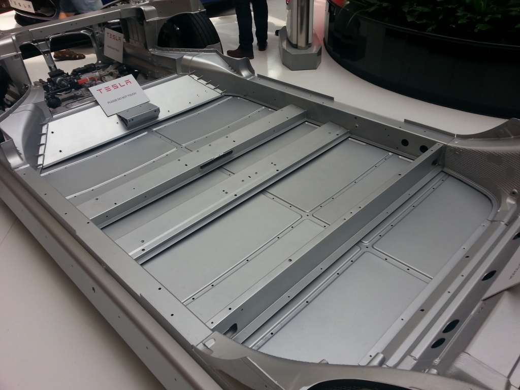

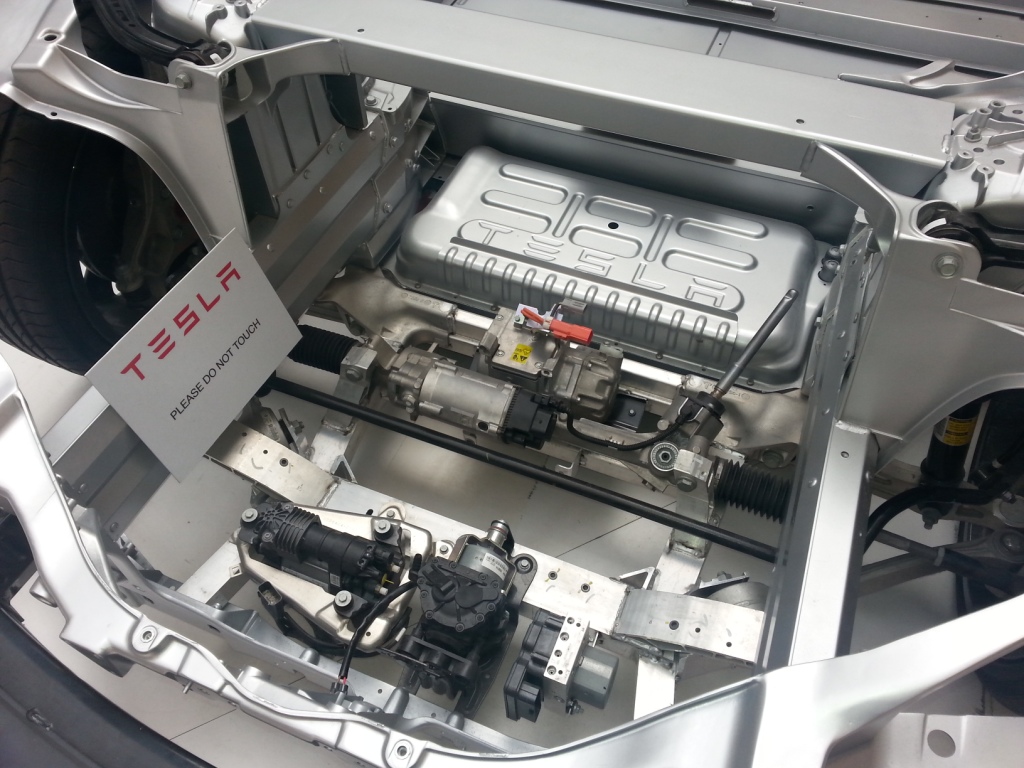

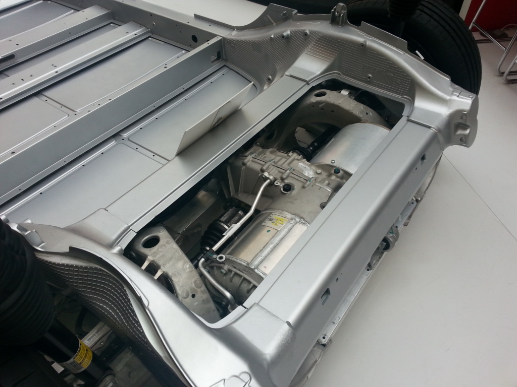

Saw one today but 'naked'. Very interesting to see the chassis and drive line of one. This chassis has only 2 motors and is not the S but otherwise the same.

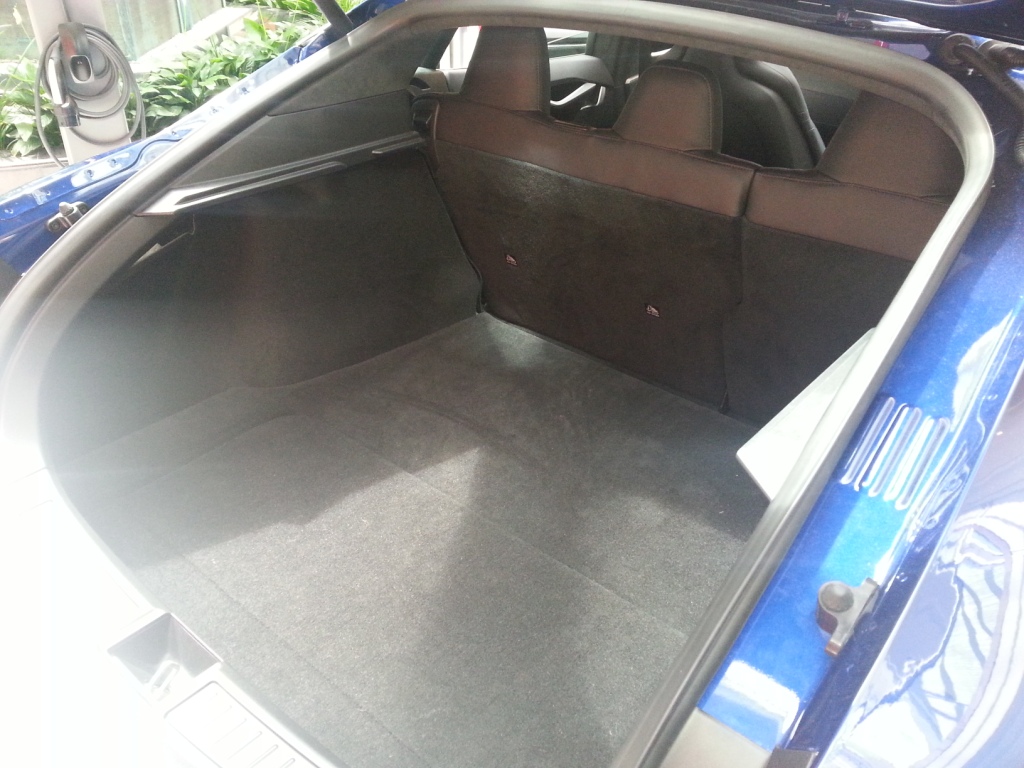

Note the very flat floor. (battery is under the floor) Huge boot and also another one up front is a bonus.
Lots of alloy castings in the suspension, front and rear. In fact whole car is aluminium. Still weighs around 2000kg. Interesting also to see a lot of the internal switch gear and such like is straight from Mercedes Benz who have a monetary interest in the company.

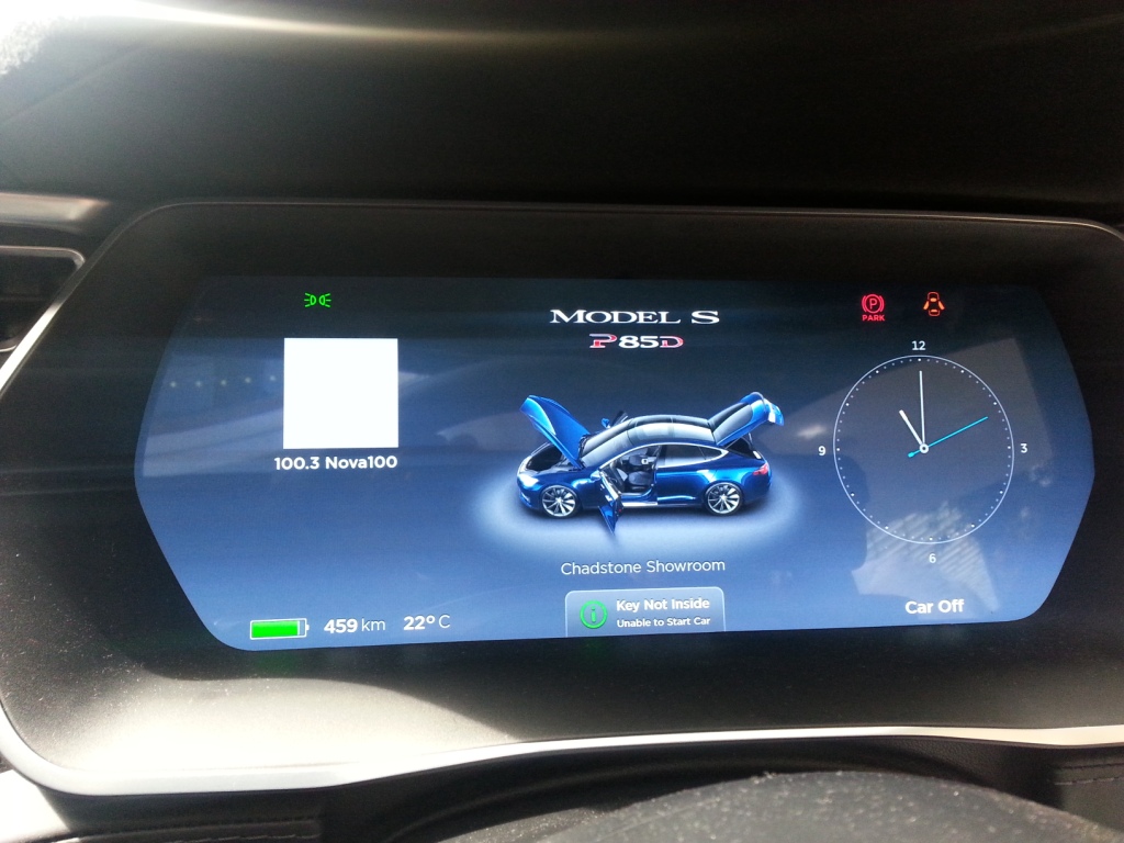

Note the 'fuel' consumption !

the Tesla has the usual buttons for changing things (on the huge screen)
one which caught my eye was the "Sport mode" and the other the "INSANE" mode !!!
