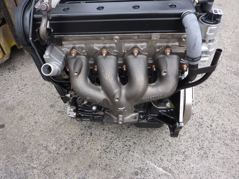

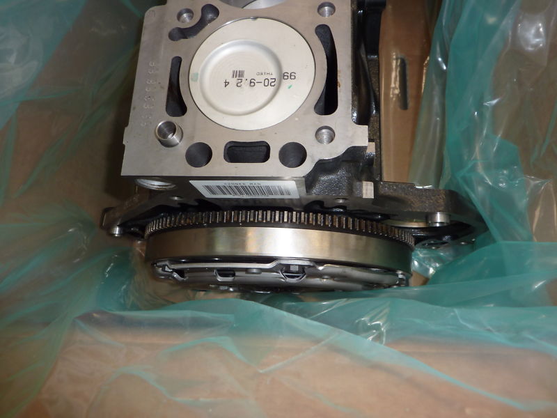

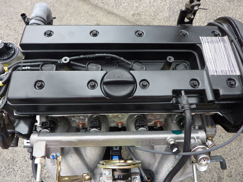

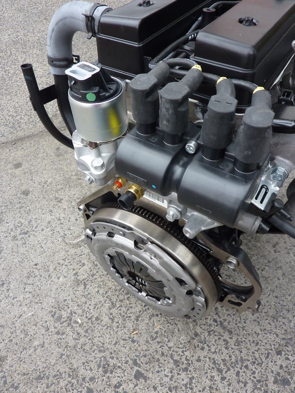

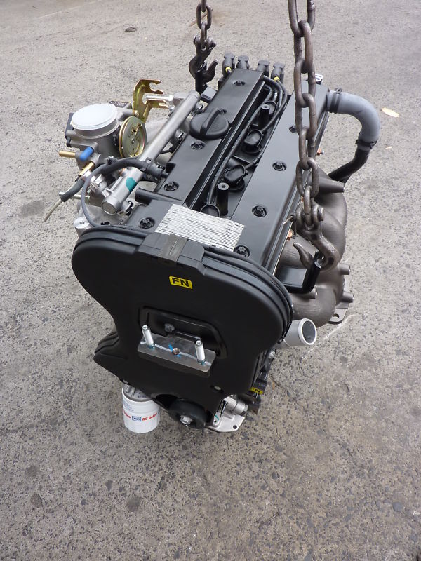

>>>> later, found the engine (just about 10km from me here)
can't see a lot of details but at least one side appears to have some holes for a front engine mount. All that crap out the back might be a problem though. Some very carefull measuring needed.

coil packs will be removable did original messurements on a astra and it was clear at the rear :?: for a track car a fire wall mod last resort.
Sat Jan 05, 2013 9:24 am
what's that gadget next to coil pack?
I see one is sold. I bet they have a few of them though

im not sure :?: i have not studied the daewoo engine yet. Research tells me the internals are the same. I can get the rodeo gearbox for $200 and a 2ltr astra for $250 from a wrecker close by. i have a motec ecu to run it in the cupboard or the other option is to by a whole car. A new engine would be a waste as if i was to do this i would bomb the crap out of the engine :?: i am not that serious yet but if Lizzie decides to race again it's a good possability.

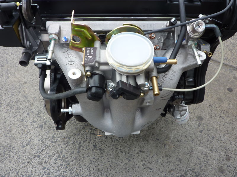

they have a bunch of other stuff too incl. short engines. This pic shows whatever that is on the back, it can be removed or relocated.
Sump is at the back too.

the coil packs are bolted to the head i think :?: x22 the 2.2 ltr is a isuzu amigo so maybe a isuzu engine cover available.
