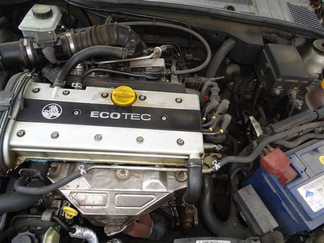

is the Vectra 2.2 engine the same basic engine ? It has 140hp and 200nM torque. Would move a street car along pretty well would think. But one would would probably need to re-co a s/h engine.
